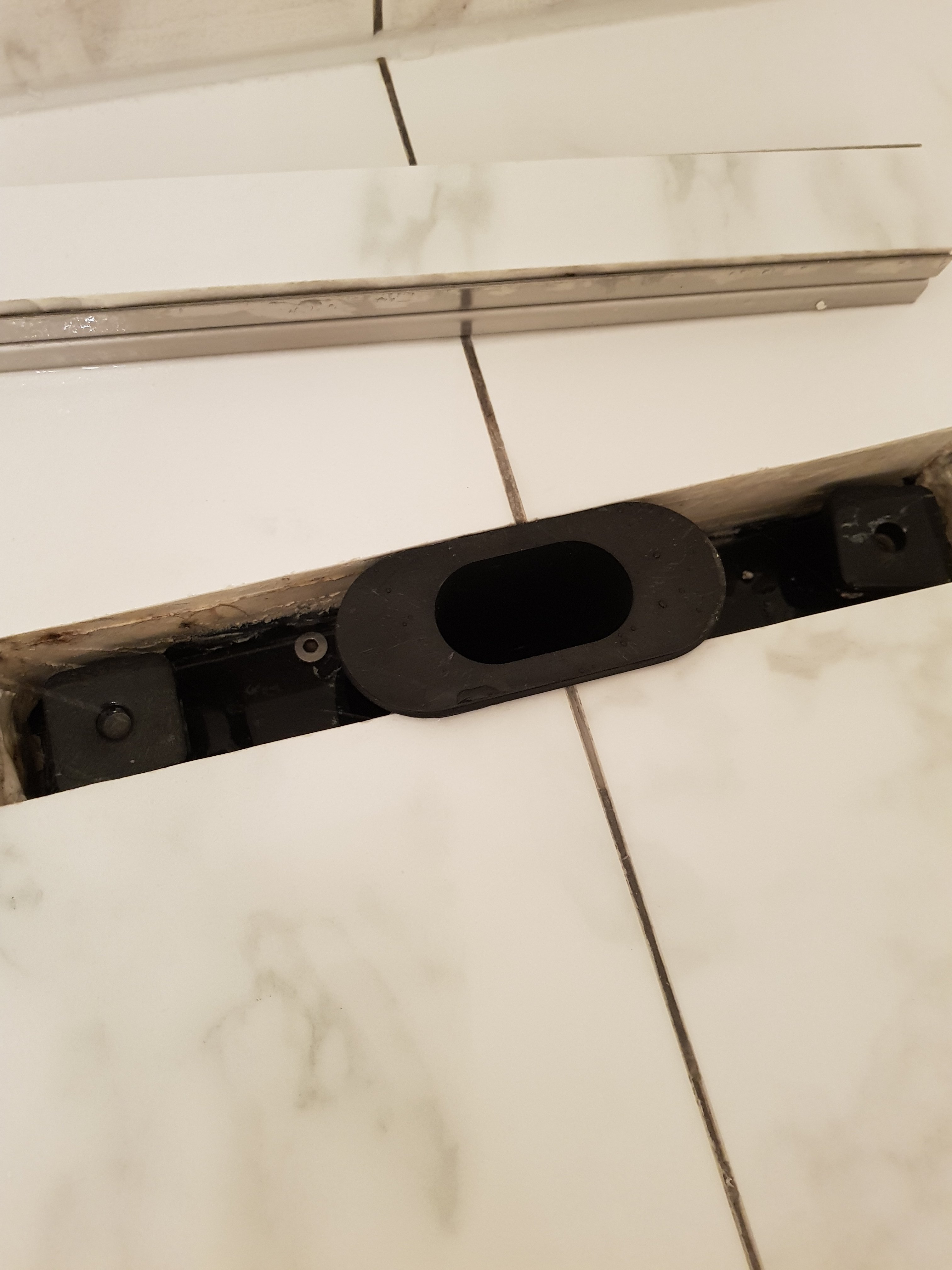

Hi, thanks everybody for their input! I've uploaded the picture from the smelly shower (1st floor). BTW, we noticed it gets worse when we flush the ground floor guest toilet... Trying to wrap my head around how this can be but am clearly not a plumber...
Run a bit of water into that shower trap to and get someone to flush the guest toilet whilst keeping an eye on the water in the shower trap. You will likely see the water either get pushed up out of the trap and releasing a stink with it, or conversely it may pull the water out of the trap and down the drain, thus losing it's trap seal effect and letting the sewer smells in that way. That would indicate a venting problem is likely.
I had assumed (I suppose one should never make assumptions!) that the OP had taken that part off to let us get a look at what's underneath. However if that part is actually missing then you've solved it.
Hi all, thanks so much for your input. That part is indeed missing and I've emailed the company to see if they can send another one through.

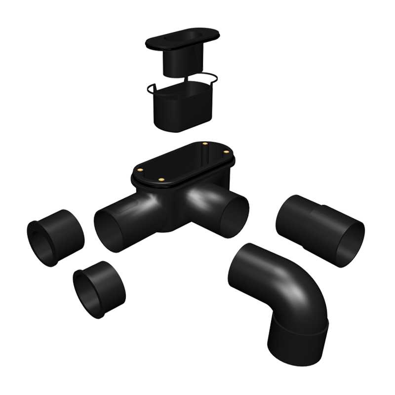

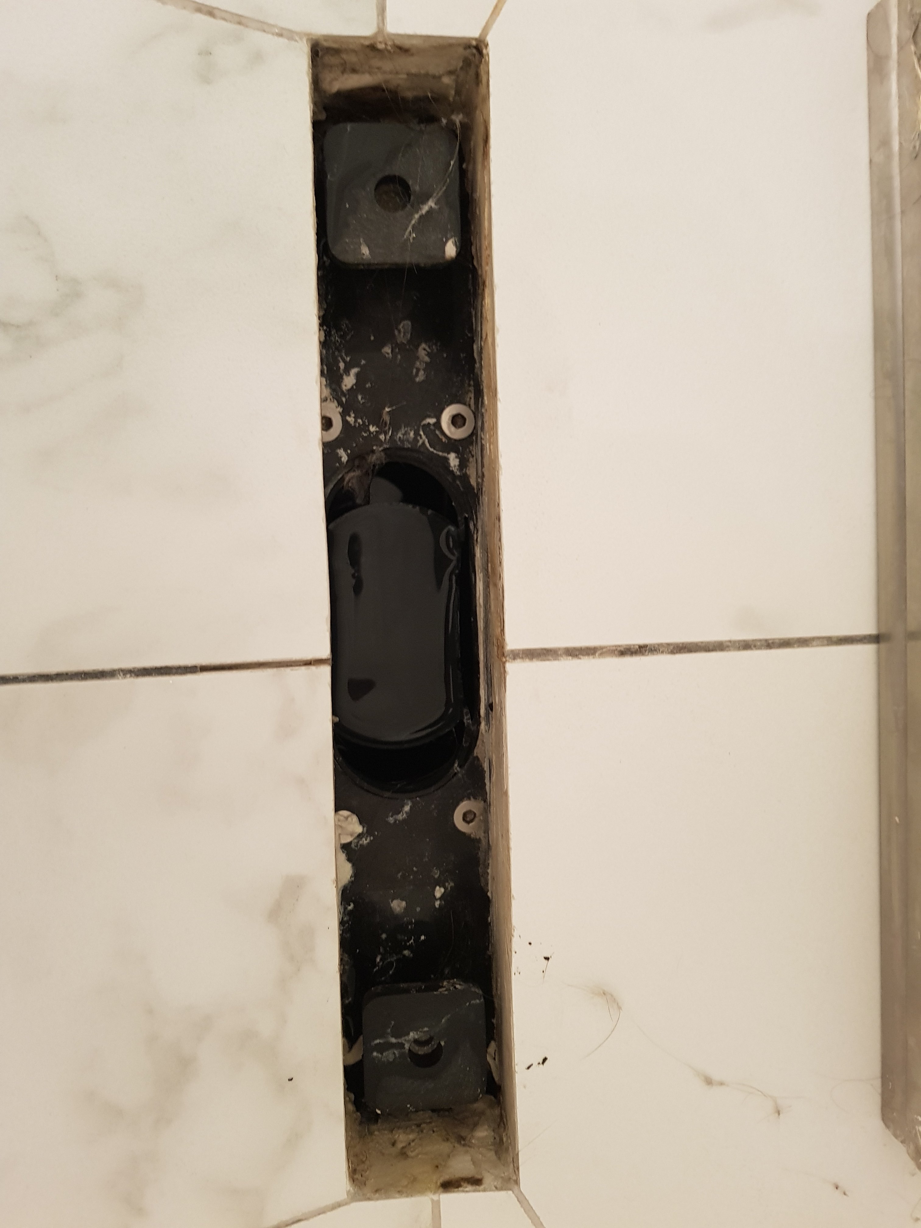

Hi all, as suggested I contacted the company and they sent me the missing part. The problem is that it doesn't fit into the channel which is probably why my builder didn't attach it (photo attached). So what do I do now?
Oh dear.
The "builder has tiled it incorrectly. Those trays come with a foam template to tile around. Looks like they need to return and cut the tiles back.
Oh dear.
It's not the best but could you cut the plastic to fit or is it there for a reason?
