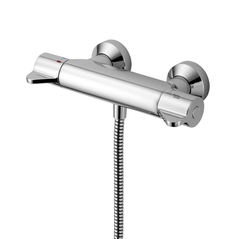

replacing something very similar to this:
check your centres are 150mm and you should be fine
If you are on a low pressure systems make sure the mixer is suitable for it
check the flow without the head on the hose, it could be scaled up which is a cheaper fix just to change the head

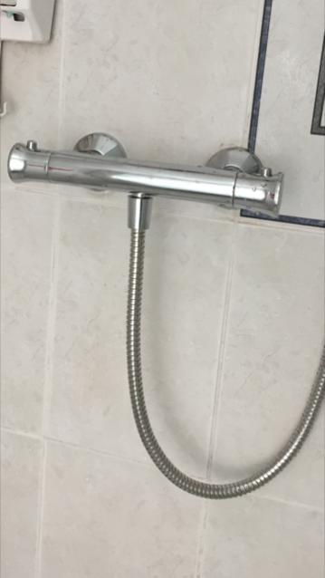

All sorted.
Flow is much better than before, but still won't be good enough for a rain shower. When the bathroom is done i'll get a new tank/pump put in as suggested on here in a previous post.
I replaced mixer and seals, hose and head with a budget set for now as plan to redo bathroom in a month or two.
