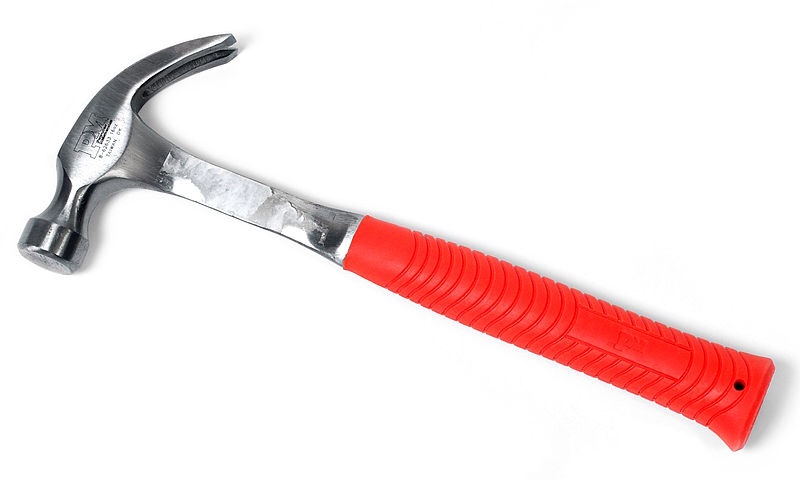

Hammer time! :hammer::hammer::hammer::hammer::hammer::hammer:

Yes smash the old one and a suitable pan connection should be available.. oops.. bit too late. That loo looks like it is worth a few quid..!

I love UKPF..
Honestly must apologise Raw85 lollz but it was a very fast explicit concisely briefed..! Brilliantly funny
