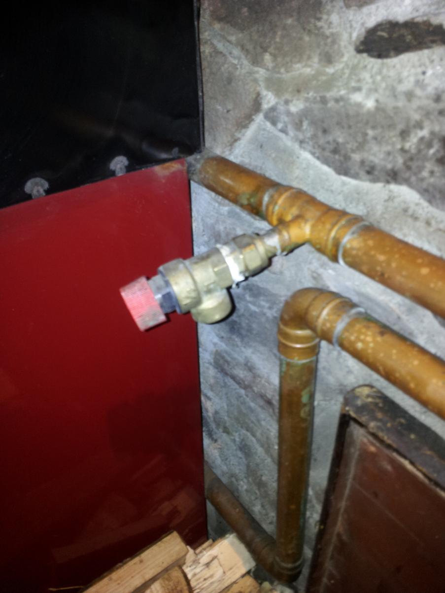

I have located a valve coming from the rayburn, when this is turned black-ish water comes out that makes me think its the central heating pipe. is this correct? pls see attached picture. and is this the correct valve i need to drain and then refill?
Re: Please Help! No hot water after power cut - Rayburn 355m.
that is a pressure relief valve, unusual to find on what should be on open vent sytem! you want a drain off cock, a small valve with a hose attachment, one off a rad would suffice if the rayburn feeds dont have one.

Looks like the doc is that prv in the picture. Must have been a hike to the merchants.
