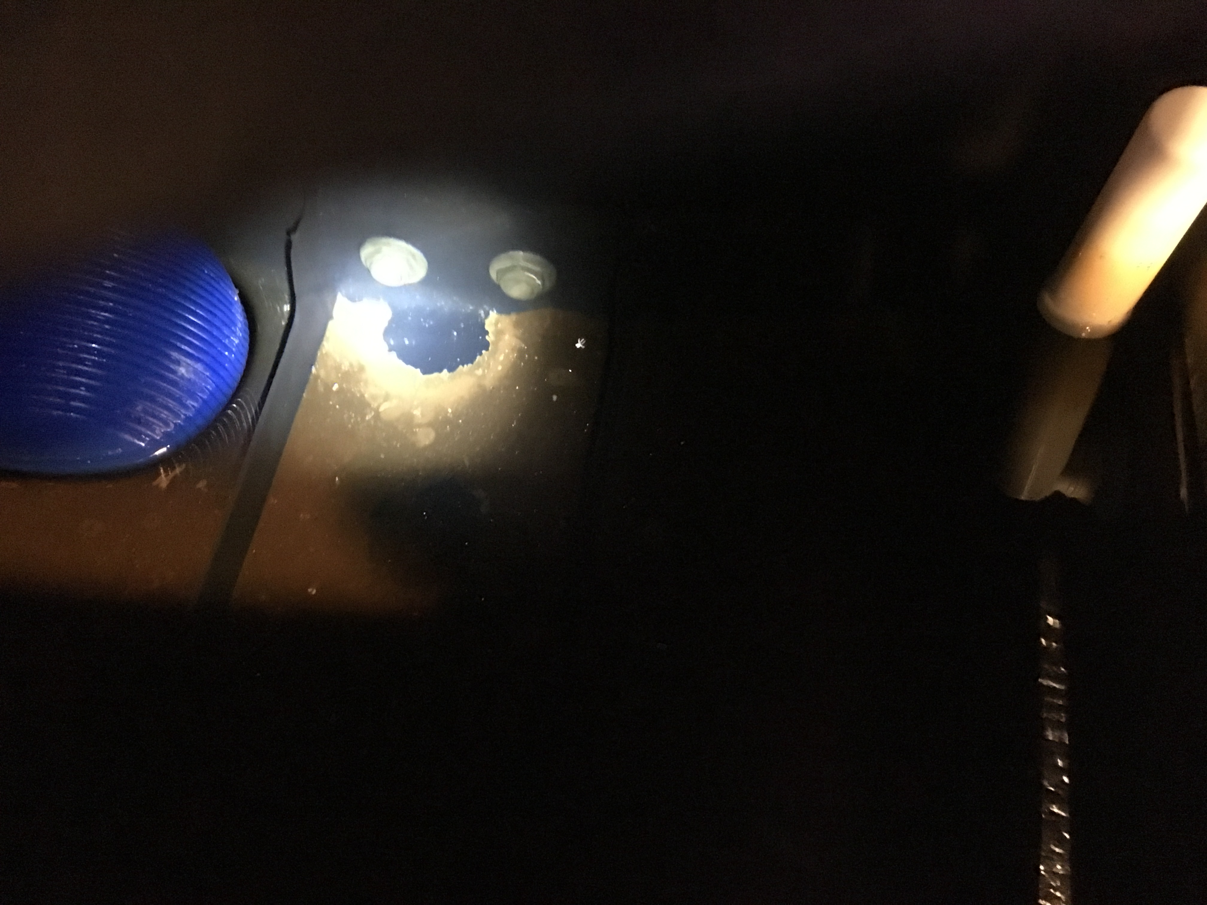

What is this at the bottom of the tank?? Any ideas? I’ll tie the ballcock up and let the tap run to fill up a few water butts. That way I don’t waste all the water! I should be able to scrub it out then and try again. I would like to have mains directly to the taps in the bathroom. I’m addition to this the 2 part zone valve has broken and have to have the heating on to get hot water! Unless I turn the the immersion heater on direct.... I have a new valve. But how much to have someone drain the system and fit the valve?
To me it looks like simple sediment our water system carries. It never gets washed through as its allowed to 'settle out' (as in settlement tanks)
