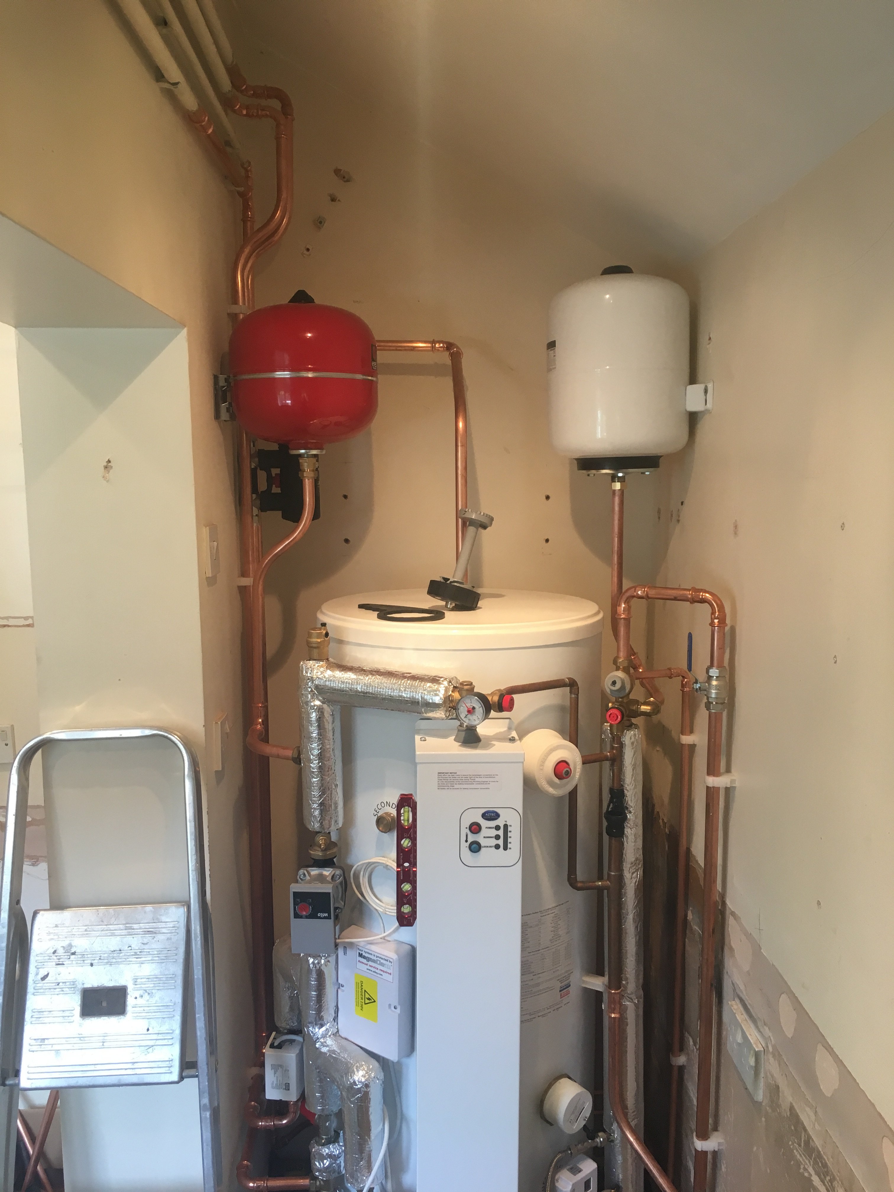

Fit one of these
2 bar and 15lpm incoming (old lead 1/2)
All working fine and cus happy
