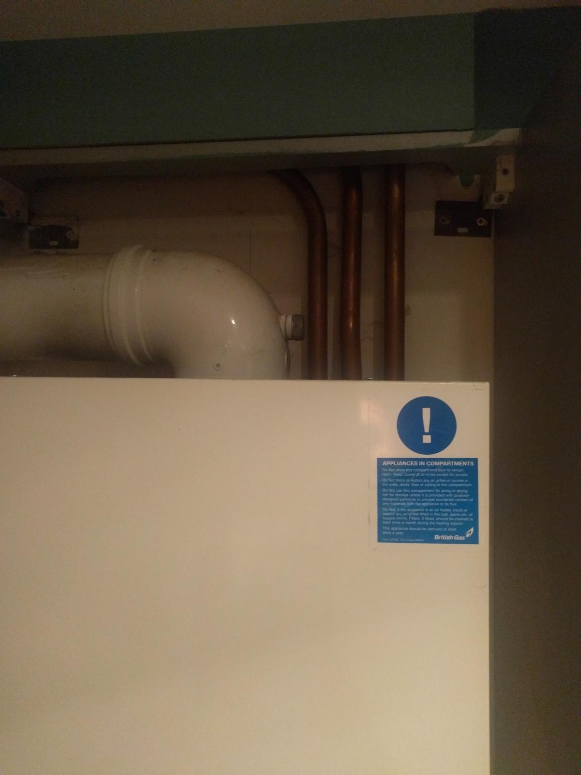

I've just checked and here's an image of the pipes going into the boiler. From left to right:
- cool temp
- hot temp
- piping hot
I think the one that is cool is the return to boiler?
RH pipe flow, middle pipe return. Difference in temp indicates circulation. However, with room stat. at 28 degrees TRVs will be closing down before call for heat is satisfied Remove head of TRV from large radiator and see if issue goes away.
