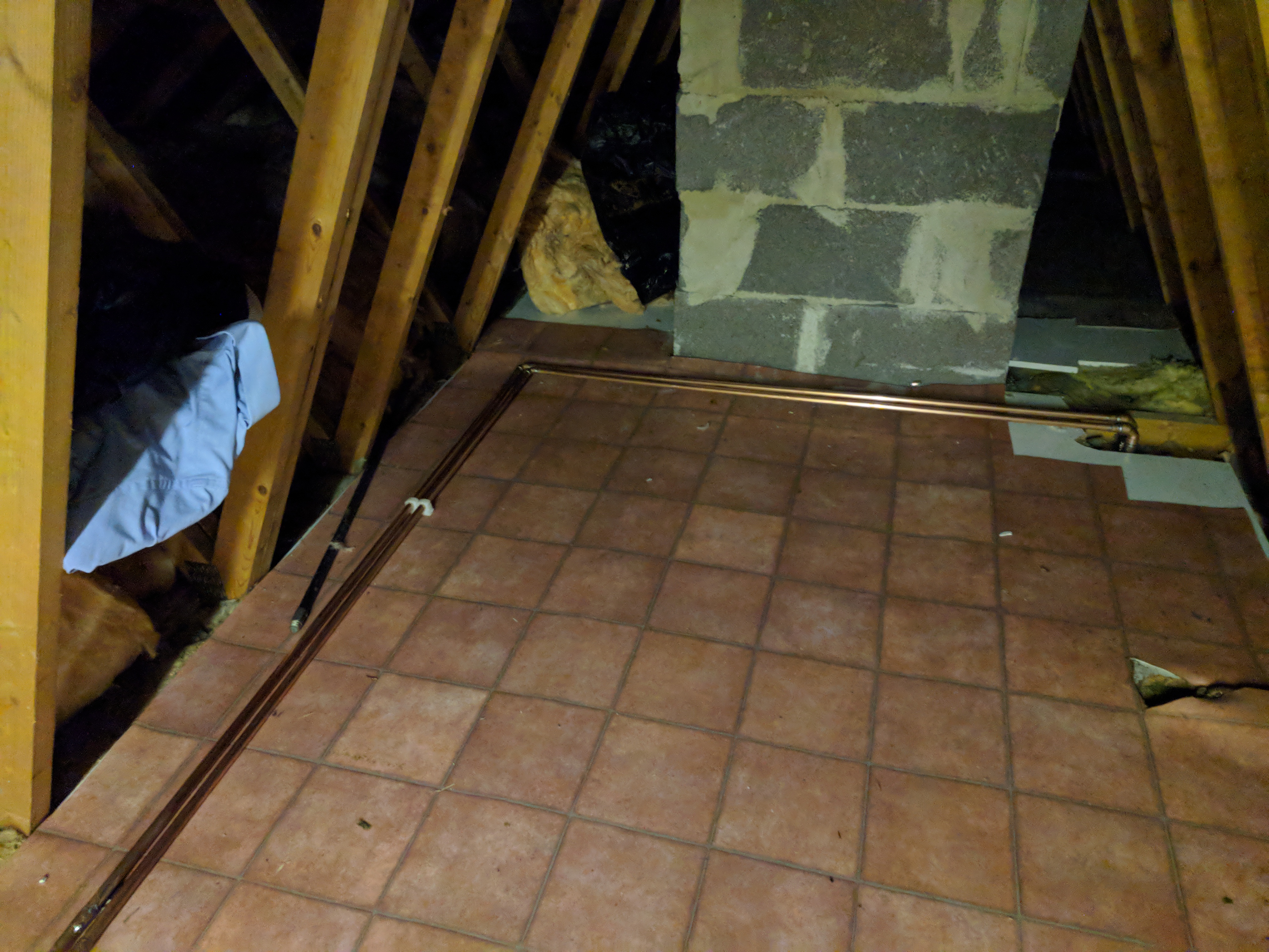

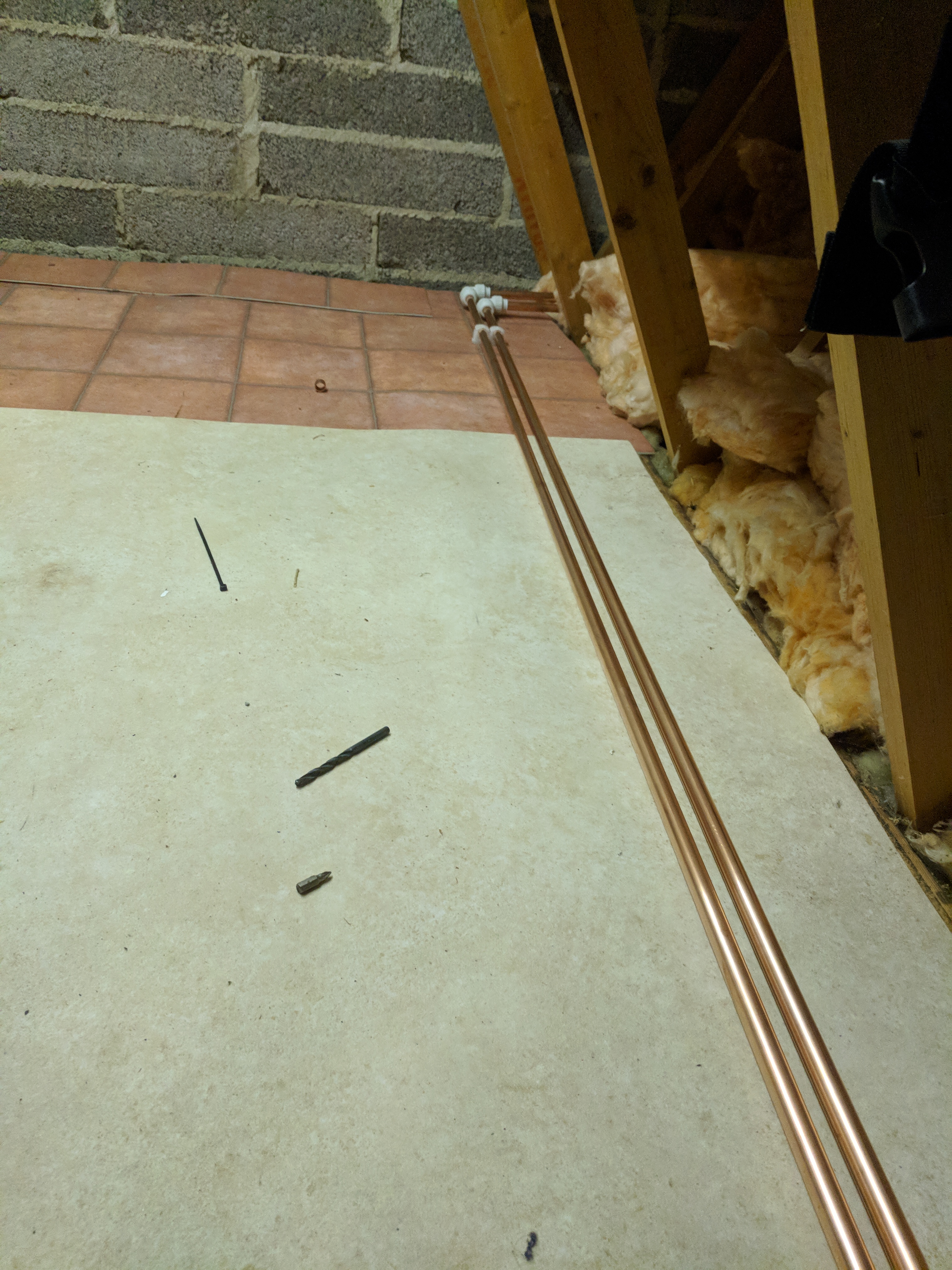

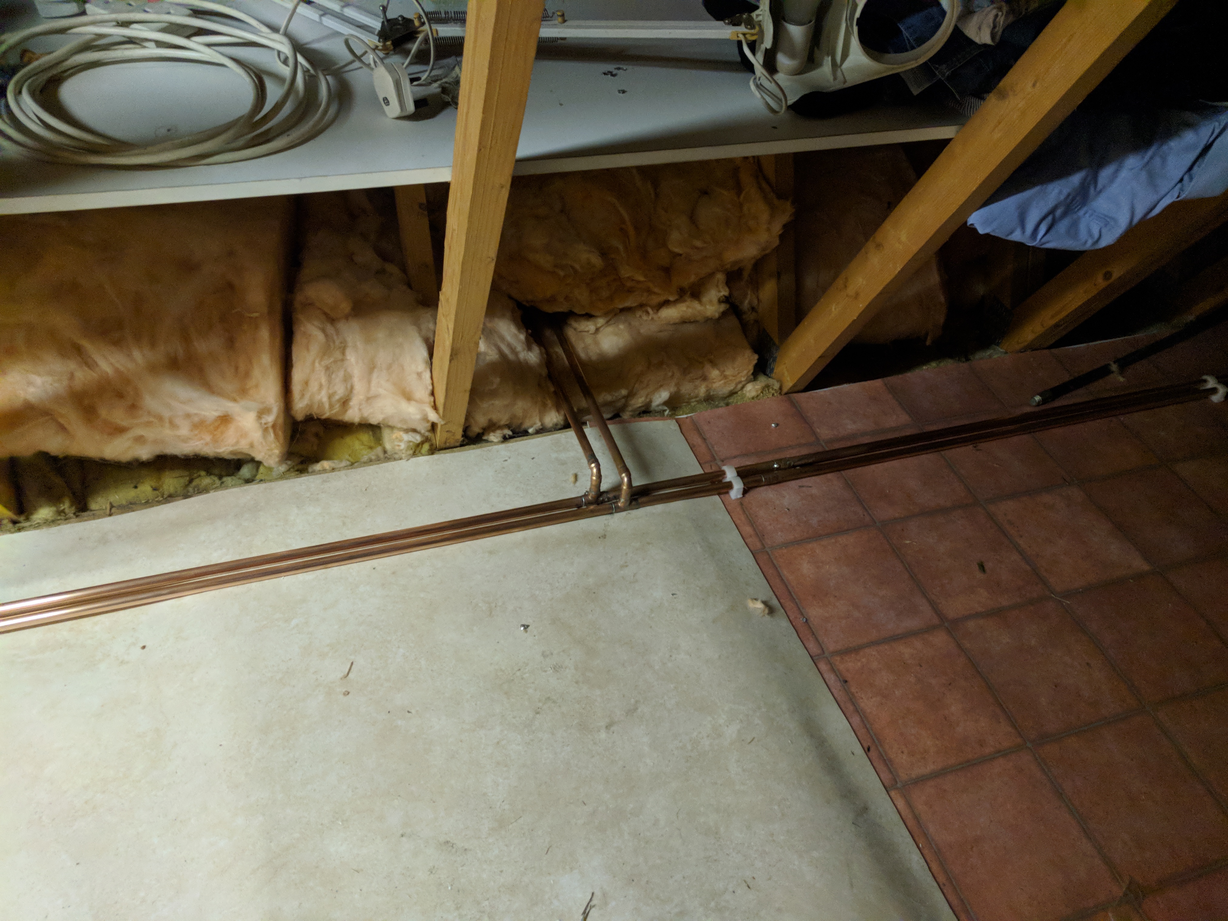

Firstly, the central heating pipes have been installed on top of temporary flooring in the attic, without insulation. I feel like it could have been installed out the way behind the wooden rafters - and it should be insulated, right?

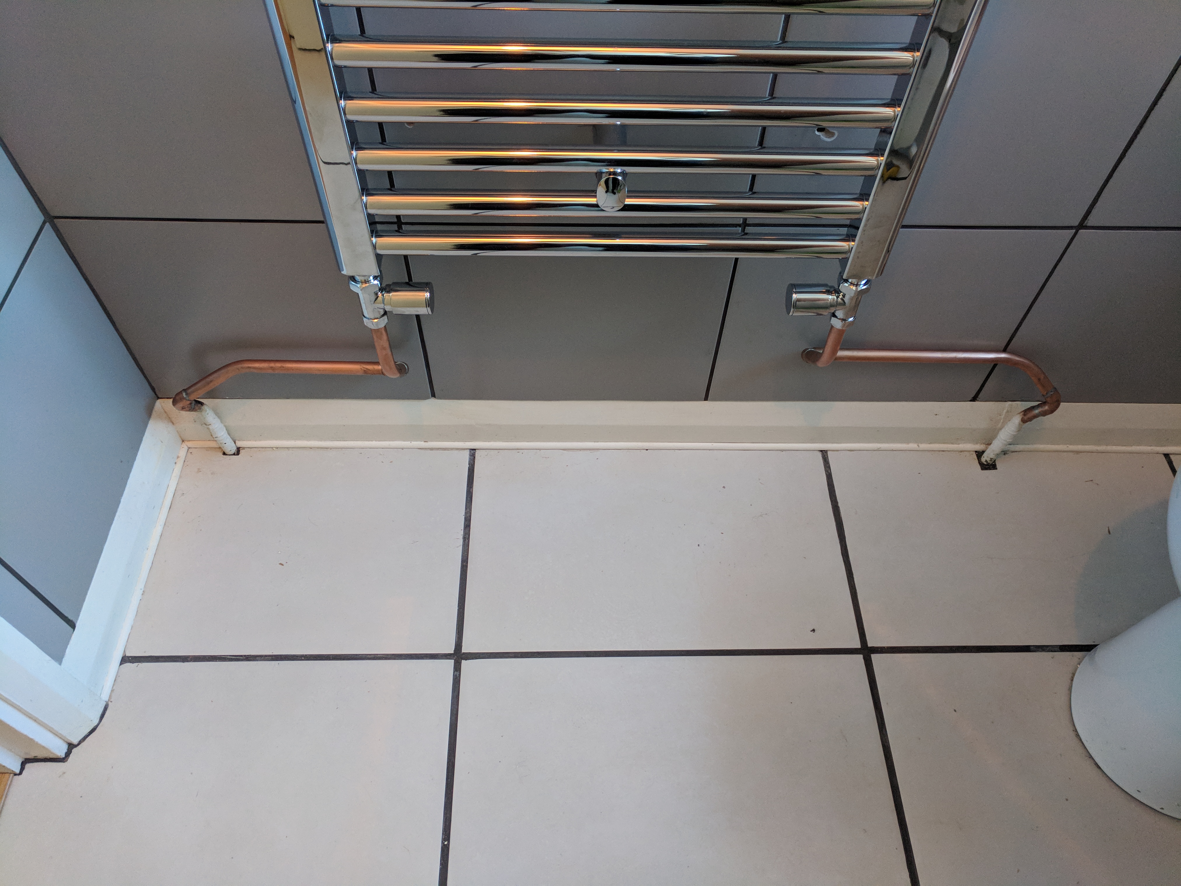

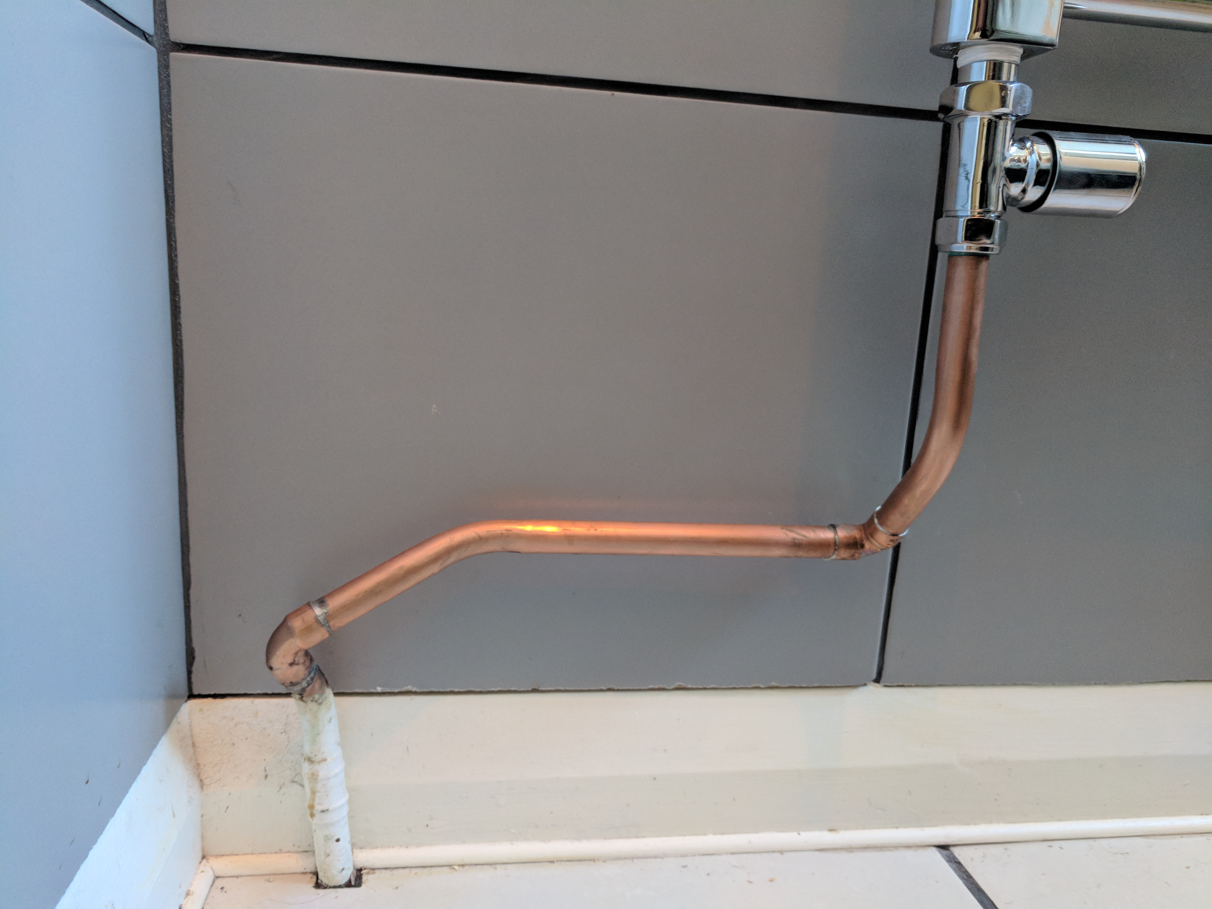

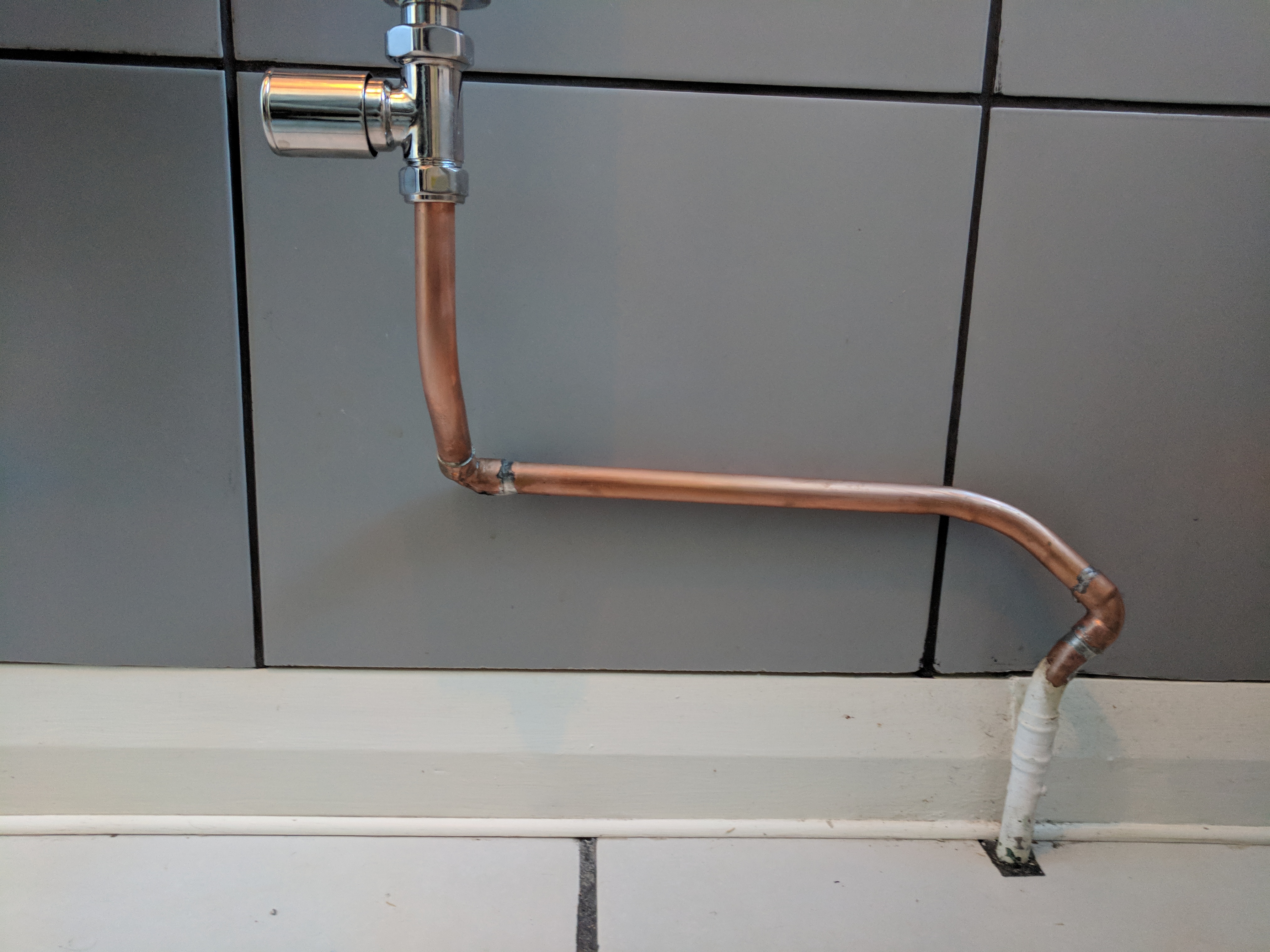

The second thing is the towel rail in the bathroom. We wanted a large one swapped for a smaller one, so I was aware the old pipes weren't going to line up but I feel like the old pipe could have been cut off further down because what he's done is tried to make the new pipes fit with the angle the old pipes were facing which makes them look a bit weird.
I am not a plumber either but that towel rail is hilarious and yes he should have left more space between pipes so substantial insulation can be fitted on both pipes.
Maybe you should have specified you where you wanted the pipes in the attic space? Either way, it does need insulated.
In regards of the towel rail, it's pretty shocking but as you say it would of never looked good regardless of how it was done. I don't know why he/she didn't just use a multi cutter and cut it at a vertical point to get rid of the angle, which does look pretty odd!
I would say that the piping in the roof space should be insulated.
As for the towel rail connections - as bad as they look - I would say the plumber has done a neat a job as possible in the situation. He had to work with what was existing and what you wanted to have installed.
I don't think there is much more that can be done to make it look any better without lifting the floors
Yeah, fair enough...I have no idea how difficult it is so just wanted to see what people thought. And it looks like the general consensus is that the attic pipes get insulated so I'll get onto that. Thanks for the responses!
I think that carefully painting the bare copper to the towel rail so that it matches the grey tiles would improve the look considerably.
Another possibility would be to box them in, but it would need to be done rather carefully and neatly to look any better than my first, paint-job, suggestion.

Cheers Chuck, I think I'll try the first suggestion. Careful and neat isn't really my forte!

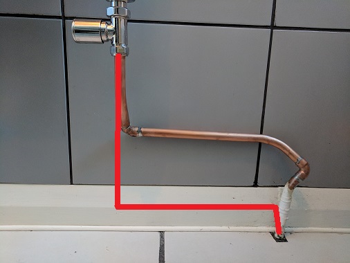

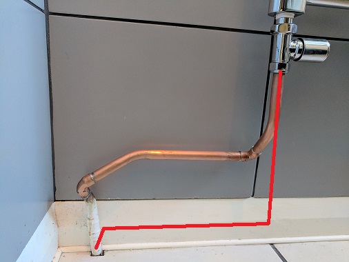

Who employed the installer, you or the Finance company? I would guess it was the FC, in which case you should complain to them and insist that the faults are corrected.
As for the towel rad, it's a very amateurish job. Didn't the man have the brains to think of running the pipes as in the pics below? It would be much neater.

Pipes in lift need insulating as been said,an I think with the towel rail either what doitmyself said or I would of hung the rad inline with the left hand side pipe to go straight into rad valve an brought the right pipe along skirting so you could at least paint it to blend in.
The new pipes to the towel rail should have been kept vertical and then 2 square bends and with a kick out to bring them in line with the valves.
Still would look an add on, though.
The pipes in the attic should have been installed further away behind the roof frames so to keep the floor space free. The runs that go parallel with the joists can normally be run below the floor, between flooring and ceiling, before being bent up behind roof frames.
View attachment 31678 View attachment 31679
How would you cut the pipework ? Secondly, How are you going to solder the pies if they are so close to the skirting boards?
It doesn't look pretty I agree, but what else can you do to make things better? I would rather lift the Floors and change the wole layout

It would've been possible to remove those solder ring straight couplings and replace them with elbows even if it meant scorching the skirting.
Probably a soldering mat, or a thin sheet of metal behind the pipes, (but not touching the skirting) would protect the skirting from the flame.
I sometimes use a builders trowel.

To be honest, the work is tidy, if weird.
While, ideally, the loft work would not have been on the floor, I have done similar myself when the customer didn't care and wasn't willing to pay the extra for me to lift the floor and put the pipes elsewhere. But I would have lagged: 25mm of foam at the very least, and a few extra clips.
Not sure why the bathroom pipework is how it is. The excecution is skilful, but the planning is odd. I think I would have sweated the existing couplings off rather than connecting to the weird angle, but then I wasn't there.
Cut with multi tool. Use file to take rough edges off. Solder carefully with a solder Matt. I (and anyone whoā€™s half descent) do these all the time
