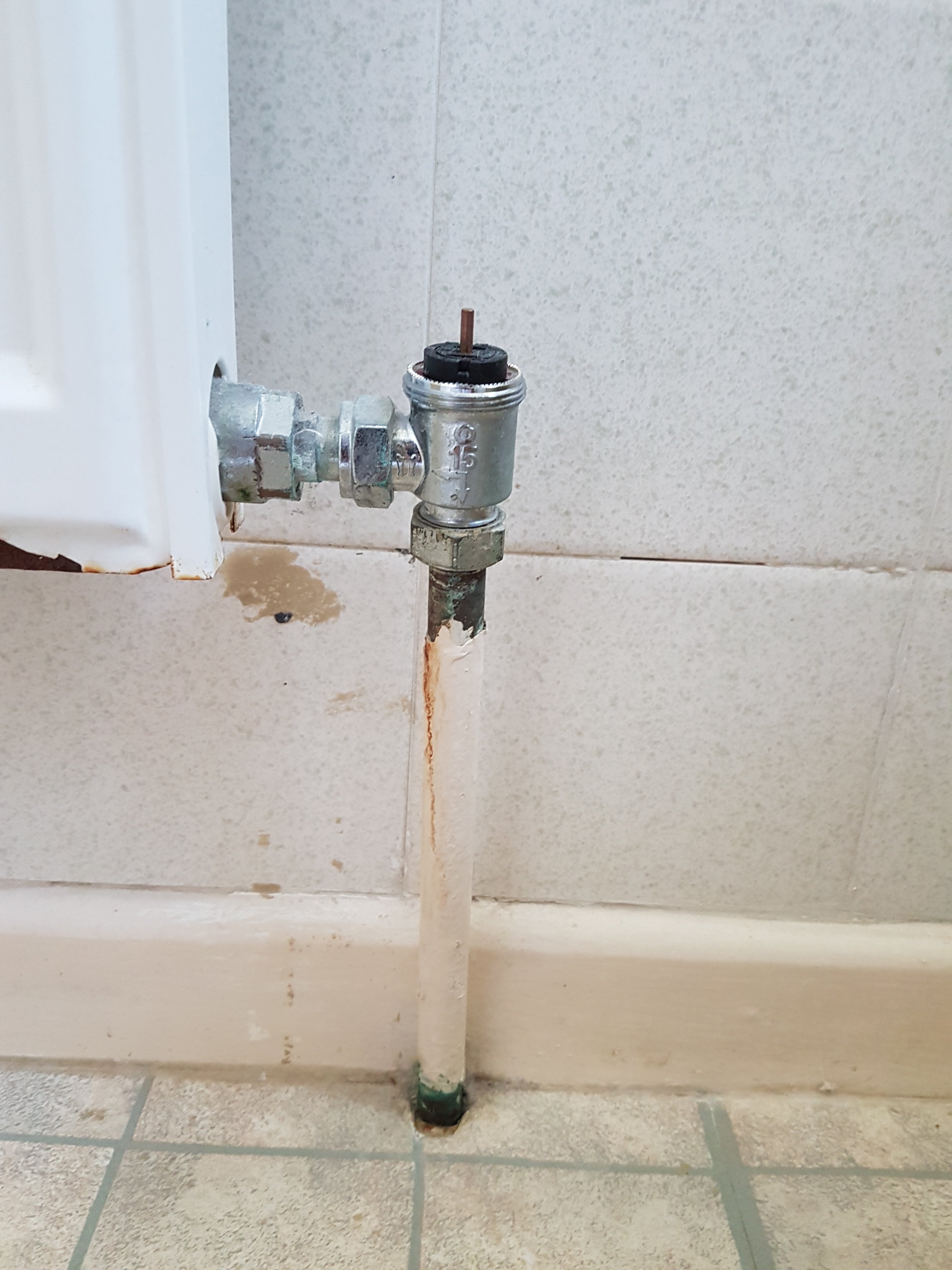

Take the trv heads off and does the pin push down ? Also lift it till it stops don't force it up too much you should have heating

That's fine there lockshield valves won't go wrong unless there shut (anti clockwise to open if your wondering) but if they've worked before leave them point to either controller not giving power to the pump or duff pump
