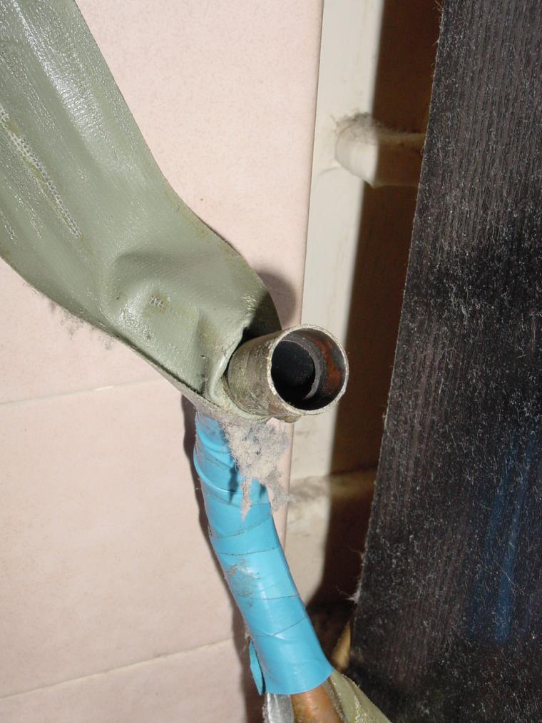

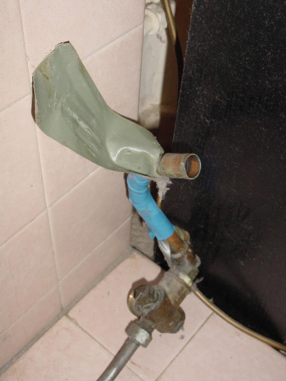

It was a shock when he told me there was a substantial leak in the gas. After inspecting the gentleman asked me to come look at the gas fire. As I squatted down he said "watch this." He reached into the wall cavity and pulled out the entire pipe which extended from the wall to the fire. He asked 'what do you see?' All I saw was lots of tape. That's what I told him. 'Exactly,' he said with a searching look of incredulity. 'Who did this installation?' he asked. I told him it was the same company who had come for the past four years.
The engineer said he had never seen anything like this before. The pipe running from the mains connecting to the fire had been connected with Sellotape! There was not even threading on the pipes as one would imagine there might be to screw or bolt the pipes together. The tape had become brittle and loose around the pipe, thus causing the gas to escape.

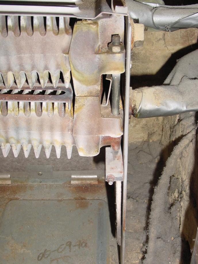

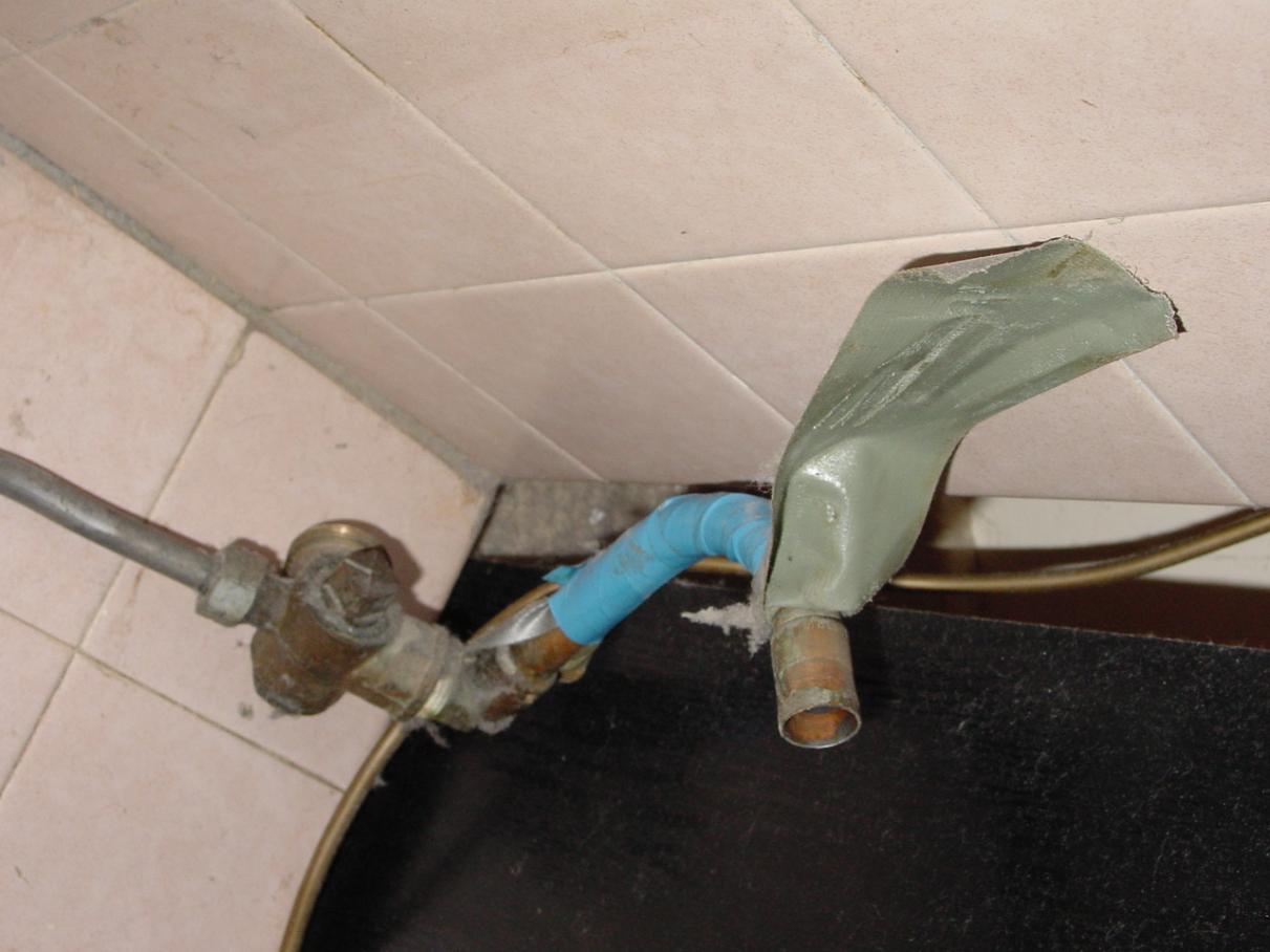

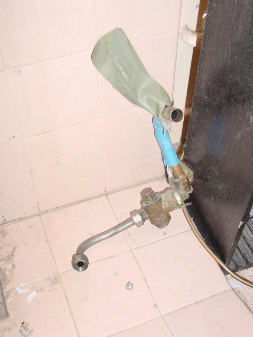

the tape is to protect the pipe from corrosion not to seal it the solder has not run properly this may have been ok on installation but obviously leaked after and should have been spotted this is why a tightness test should be done.I have done LGS certs in the past no drop but later called out to smell of gas and the joint not soldered it was sealed with flux
Wazza is right. You can see on the connector the lead solder which hasn't penetrated the joint correctly.
I think the previous engineer was indugling in a little hyperbole when he said he'd never seen anything like it and it was being held together with tape.
We've all seen and heard of incidences where fittings haven't been made correctly but pass the standard tests for soundness on installation.
It seems this fitting passed the initial check and due to being wrapped with anti corrosive tape passed any subsequent tests.
That said it's still an unacceptable situation, there's been a gas leak due to bad workmanship so it should be reported to the HSE.
As above the photos show a solder joint wrapped against corrosion.
That said if the engineer was carrying out a full landlords safety certificate there are sections on the CP12 where he would have signed for the tightness check (at the meter) and also a box to say the ventilation was correct (ie correct size and not blocked).
How long has passed since the last certificate and this latest inspection? and who is to say it has not failed since then?
A joint like this is impossible to spot with the eye and the previous engineer would have relied solely on a tightness check.
If the air vent is the only one into the room and it was blocked then that should have been noticed but I cannot see how you can blame the previous engineer for the leak?
After all looking at the boiler it was installed 15 maybe 20 years ago and I would be very surprised if records exist saying who installed it.
