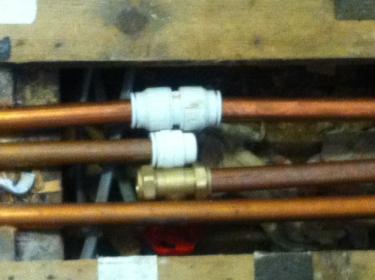

15 mm pipes not been flushed but system has been drained 5 times in the last week and the water was very clear.can up any other pics you need of pipe work
I'm not sure what work thety did to zone valve pipe work or If they just turned it around I know they made changes to some pipe work under the floor boards I will try and up a video when I can sus how to.
That's a central heating pump and zone valve fitted under your bath!!! Shheeeeeeeeeeeeeeeeeeeeeeeeesh!!! (gas-engineers sharp intake of breath) Was not expecting to see that! LOL ...

The plumbers who came out made changes to pipe work I can take a pic as it will be easier than trying to explain
As you can see in 2nd pic the middle pipe has been capped and a valve fitted on the other disconnected end which was on the pipe that has been reconnected with plastic fittings pics 3 & 4 are in correct order as they enter cupboard.As you look at pic # 3 the top pipe oes to the bottom of cylinder and branches either to or from c/heating header tank.The middle pipe on pic # 4 goes to upper pipe going into cylinder and goes to or from c/heating header.
Deden, did your plumber move the pump when he did this new work. As having the pump installed with the body facing up like that would cause air to be trapped reducing circulation and burn your pump out faster. Which could be part of the problem.
No the pump has been positioned there since the previous one.This room was originally a bedroom before making It the bathroom approximately 15 years ago.All pipe work was done at the same time
