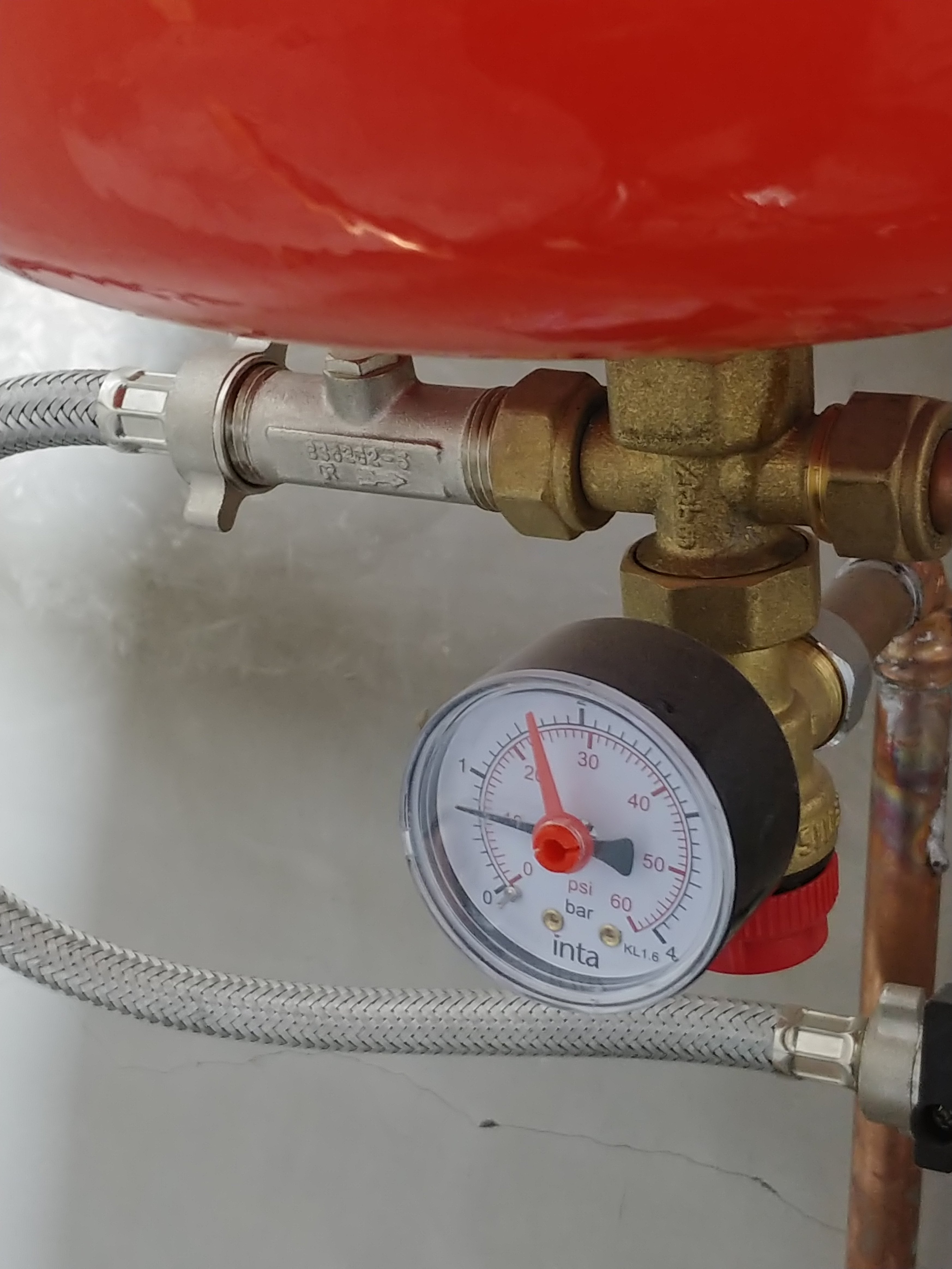

I've been told that if the gauge on this orange vessel thingy is too low then we might have a leak. Looks a little on the low side to me. Is this normal? See attached. Thanks again for the help. Really appreciate it!
You might

Sorry to reignite this thread. The heating system appears to at least be working ok since my last post however, one thing happened a few mornings ago that concerned me.
When the heat switched on as scheduled around 07:15 a few mornings ago, there was loud banging and knocking noises that appeared to be coming from the attic. From my bathroom I could hear the knocking noise clearly alongside a louder than usual sound of flowing water. It sounded like there was water being poured on the ceiling above me!
I checked the newly installed cylinder and noticed the gauge below the expansion vessel had dropped to zero. I turned the little tap which I believe allows water to flow into the system and switched it off again when the gauge got to around 1.5 bar. The system seems to be working ok and the gauge hasn't really dropped since this happened a few days ago. It is concerning that this happened and I'm not sure if something more serious would have happened if we weren't at home. Any ideas what may have caused this?

Not good can you get into the loft / where the noise was ?
Pressure should be a min 1 bar in the system

Thanks. I stuck my head up and thankfully no sign of any water or leaks. I just don't understand why the pressure dropped to zero and all the banging and knocking noises started. I guess there is just a lot of air in the system. Might bleed all the rads again. We've had to do that a few times already as some of them weren't heating that well. Thanks all for the fast replies!
Boiler is in garage but noise resonates through pipework and can give a false signal as to where the noise is actually coming from.
