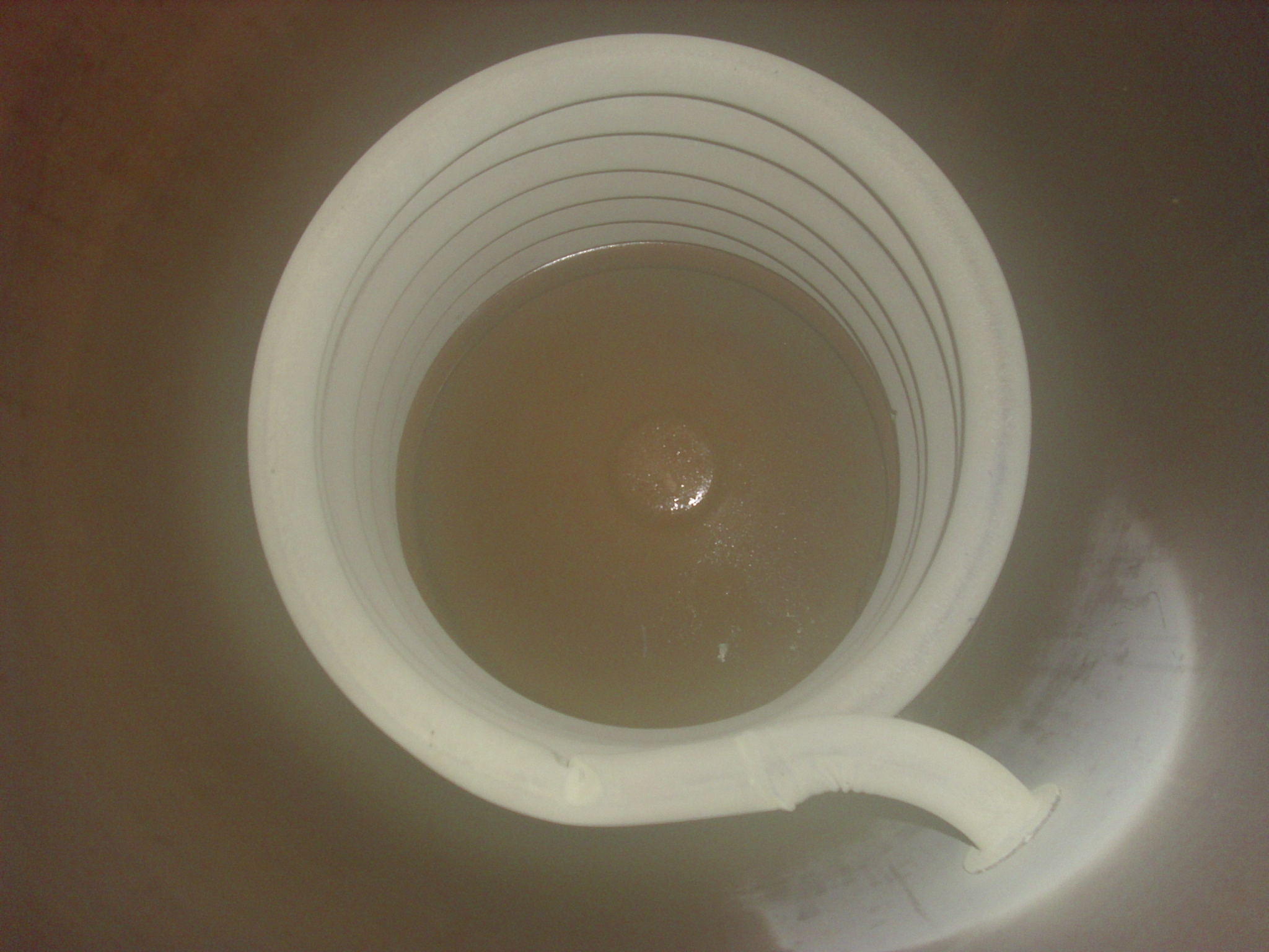

Well, the hardest thing was having enough strength to coil the poxy hose back up after I'd drained the cistern. Realise now there was no need to drain the cistern, but obviously thought processes not at maximum levels!
The cylinder was also empied. There is a thin coating on the coil, but it looks to be relatively minor, though I appreciate that the thickness of scale is hard to assess. I think I'll dump some citric acid solution in the cylinder and see if I can dissolve some of the limescale, and hope this won't wreck the cylinder! Apart from some none-too-impressive pipe bending inside the cylinder, it seems relatively in order.
Also, a drained cylinder allowed me to test the heat required to heat the primary circuit. Gas input required is 2.28kW before the boiler thermostat switched off. This is interesting. While it could mean the boiler is <50% efficient, assuming my guestimates of heat required by the primary circuit are accurate, it also means that, in summer, the boiler has to use as much gas as, burned efficiently, would be needed by the DHW cylinder (heating the whole cylinder through 15°C requires 2kW) just to get the primaries heated.

Hello Ric2013,
The Cylinder looks fine, how old is it ?
As You know a `badly scaled` Cylinder would have not only much more Limescale on the Coil but also there would be Limescale debris in the bottom where it had broken off the Coil.
It is very interesting when the results of `experiments` like you have just done are available because we very rarely get to see the figures from a physical `Test`.
How much water do You calculate is contained in the Primary pipework and the Boiler Heat Exchanger ?
Obviously the Boiler Heat Exchanger Limescale level is unknown regarding how much additional heat is used to `heat through` any scale.
Chris
