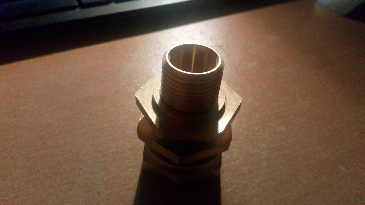

I've "repaired" my mums loft water tank from leaking but I'm unsure if I've done it correctly so thought I'd join this great forum and ask some advice from some people much smarter than me.
Basically my Mum was worried that her overflow from the loft kept running water so I went round and had a look thinking it was the Float Valve,turns out I was right as it was trickling and overflowing,it was also the old part 1 type from what I understand. I fitted a new one in my own tank a few months ago so knew what to do.
The tank was filthy inside and also full of rotten wood which was odd. After checking all the nuts I told my mum that it would be fine until the next day when I could pop and get her a new one. When I got back home she phoned me in tears saying the roof was leaking,so I went round and turned her water supply off and drained the tank as I couldn't find the isolation valve.
I then noticed there was a leak in the supply nut on the outside of the tank (on the right of the photo) going into the float valve. I can only guess I loosened it my mistake when I was checking things by hand.
The next day I got the new valve,float and a washer kit just in case. Gave the water tank a good clean,removed all the limescale and fitted the new float valve. Tightened everything up and turned the supply back on. There was still a major leak coming from the supply nut where the pipe goes into it,so the water was turned off again quickly.
I completely removed the back nut to look inside and I couldn't see any kind of washer or olive? I found this odd as I always thought a nut connection needed one? Also my parents have lived there for nearly 40 years and they've never had a tank leak before.
I'm really not sure if I did the right thing here but I found a right sized olive in the washer set and placed it over the pipe under the bolt and reconnected and tightened everything up. Water came back on and everything looked ok. I had a coffee and then went back up to check 20 mins later. There was a slight bit of moisture around the nut where the pipe was connected,probably about a quarter of a drip so I tightened it up more and everything's seemed to be ok since.
I'm going to pop by tomorrow and check things over. I'm just worried I did the wrong thing and things will start leaking again. Obviously being in the loft its hidden from view unless you go up and folks are getting on a bit now.
Could anyone give some advise and tell me if I've done anything wrong so I can put things right?
Thanks loads in advance and sorry for the long winded post,I just wanted to give as much detail as possible.
Just so you guys can see here's a pic of the water tank before I butchered it.

I just wanted to know if I did the right thing or something seriously wrong with putting an olive on when I couldnt see any kind of washer or olive on it already? Didn't expect a "*****" to come and have a go at me.
Obviously I havent got insurance,I just wanted some advise.
I just wanted to know if I did the right thing or something seriously wrong with putting an olive on when I couldnt see any kind of washer or olive on it already? Didn't expect people to come and have a go at me.

Ok,thanks loads for that. So I didn't need to place an olive on the pipe then? I have the 1/2 fibre washer in that washer set I bought. Would I be right to go back and replace the whole valve even though its not leaking anymore then? I'm probably a typical guy and just watched youtube videos where they all said theres normally no need to change the whole tail part.
No just a fibre washer but you might of damaged the soldered tap connector (attaches the copper pipe to the ball valve tail with you putting an olive on it
They can sometimes drip where the two faces are different
Hope this makes sense?
Yes I think I know what you mean. Oh crap,really not sure what to do now. If I go and remove the pipe where the olive was to put a fibre washer on and its damaged then I've made a bad situation worse. Now things aren't leaking is it best to leave with the olive settled and sealed or start from scratch? I'm really not able to solder a new pipe in if I mess things up.

Yes I got basic tools mate. Thanks so much for that. I'm not sure if the supply pipe is long enough though as it bends just after the soldering?

I defo will let you know how it goes. Am I right in thinking that I put an olive and NOT a washer on the end the supply pipe goes into? Sound stupid I know but I want to be 100% sure. Obviously a 1/2 fibre washer goes into the end that connects to the tail part of the valve.
Thanks so much for all the advise,really appreciate it.
On a compression fitting it goes nut olive valve / fitting
So i thought right then,that's a relief. Thanks again,really do appreciate it. Ill pop to my parents tomorrow and let you know how I get on. Ill see if there's enough pipe first but if I'm unsure Ill be back on here. Thanks so much for being so helpful.
How is it possible to tighten a tap connector up to a valve with an olive where the fibre washer should be? Surely that's not even possible?
You have 15mm copper pipe going into a solder ring tap connector, that then attaches to your threaded valve shank.
The water tight seal is made using a 1/2'' fibre washer, there is nothing in that picture that I can see where an olive should be used.
Thanks loads for the input mate. Frank Spencer (Me) must have managed to get an olive mixed up with a fibre washer. I can only guess that the olive is pushing against the old washer which I failed to notice and formed the seal.
I think in the back of mind I was thinking back to when I replaced my washing machine tap and I remember fitting a new olive then. I live and learn but I'm just glad I don't do it for a living o_O
I'm going back tomorrow and think Ill start from scratch and replace the whole tail part of the valve. If I havent damaged the pipe with the olive Ill replace it with a new washer but if not Ill install the service valve like Shaun suggested.
Some ball valves come with a tail that has a more or less flat face for to suit a flat fibre washer onto the fitting you have.
But some valves tails also come with a tapered more sharp end to them that only strictly speaking suit a brass nut and brass or copper olive. Personally I prefer the nut and olive connection method as it is trouble free, but needs done by somebody competent
Thanks for that easy explanation,really appreciate it. What a great forum. Ill look tomorrow and see that the valve tail connection is. I'm assuming its the flat one though as I couldn't see an olive on there at all. I think I'm going to do a proper job and replace the whole tail though.
This is the one I got with the float valve so I'm assuming it will be a fibre washer?
That looks to have an internal taper which will suit a brass or copper olive. However, I notice there is a fair bit of flat face also, which will probably hit against a flat type washer. Some are more sharper than that tail.
I would say that particular tail in photo is really for a nut and olive connection to do it properly
i would say either would work and bet you paid a pritty penny for the valve
Nah,it was only about £7 from screwfix,unless you're taking the mickey lol.
thats a good price esp for one with brass nuts normally all plastic these days
Thanks for that,really appreciate it. I've got more olives but I think I'll try the washer for now as from what you said it's a safer bet for someone less experienced like me.

ive just had a thought that looks big you sure its a 1/2 thread ? (should be 20mm dia ish)
Thanks again,the left YIF one was the one I was going to use until I saw the thicker ones in the set. I'll let you know how I get on tomorrow. If the olive hasnt damaged the pipe I replace the tail and put the proper washer in but if it has Ill do what you suggested and fit the service valve.
Well its the tail that came with the float valve mate. Just checked the washer against it and its an exact fit across the top flat part,does that sound right?
yep just looks mega big in your pic :D

Sorry to say this, as it will sound very negative, but I wouldn't use a tap connector type fitting, to connect to a ballvalve that is designed for a nut and olive. They are one of the most pointless fittings to use on side entry ballvalves. Why a washer seal is deemed satisfactory or necessary there is beyond me.
Exactly the same with toilet ball/float valves do you use a nut and olive on them doubtful
It is not exactly the same with toilets.
Toilets ball/float valves usually were plastic tailed, so not as ideal for nut and olive connection.
But most toilets are bottom entry ballvalves that more suit a flat seal because of 4 reasons, -
(1) supply pipe has often not enough up and down movement (even though it really ideally should have) for typical 1/2" needed for compression joint.
(2) pipe requires usually installed neatly, so can be better looking with a sharp bend away, rather than just straight up or offset from floor
(3) Many plastic or brass tailed cistern valves are made to suit flat washers.
(4) Plastic tailed valves more easy damaged using a nut and olive joint.
Whereas a side entry ballvalve on a toilet often will have plenty of movement on the pipe and especially on a cold water tank in a loft normally the mains pipe will have lots of movement on the pipe to aid installing or removing the complete valve with tail.
Never seen a properly done compression joint leaking on a tank ballvalve, but have seen lots of fibre washer solder fittings leaking, some very badly and causing water damage. Just another weak link in plumbing with a limited and unknown lifespan.
