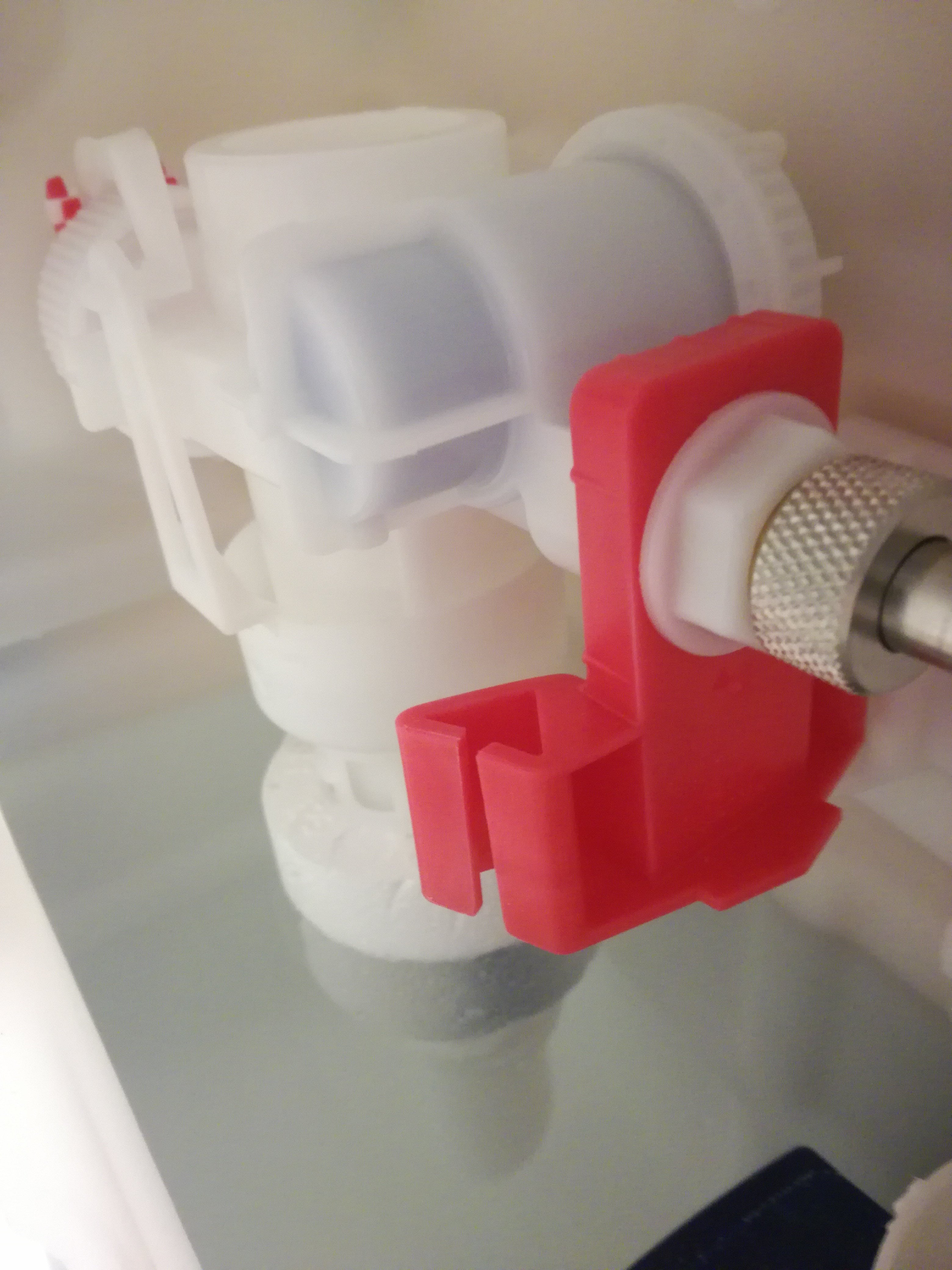

Wish i could answer these questions, again none of the people that visited did anything, or questioned anything, and rather just change the constituent parts. Photo attached. Can't really get phone inside.
Can you see what the flexi connects to on the other side? Is it a float? The syphon might not be fitted correctly also? Bit more likely the inlet valve

Hi here is another picture! I've come to think it's nothing to do with the cistern or frame because everything changed multiple times. Can it be something else? Don't think water pressure particularly high.

Not what you wanted to here Leigh , but those pics bring back nightmares for me , last summer I had hours trying to sort a problem with one of those valves / cisterns. I ended up slinging it and putting a different cistern in , and I love Grohe gear

The silver flexi that you show in the photo on the left hand side,follow that flexi back to the right hand side and take a photo
There will be an isolation valve either inside the cistern p, connected to the silver flexi or just outside the cistern. This should be accessible to you.
