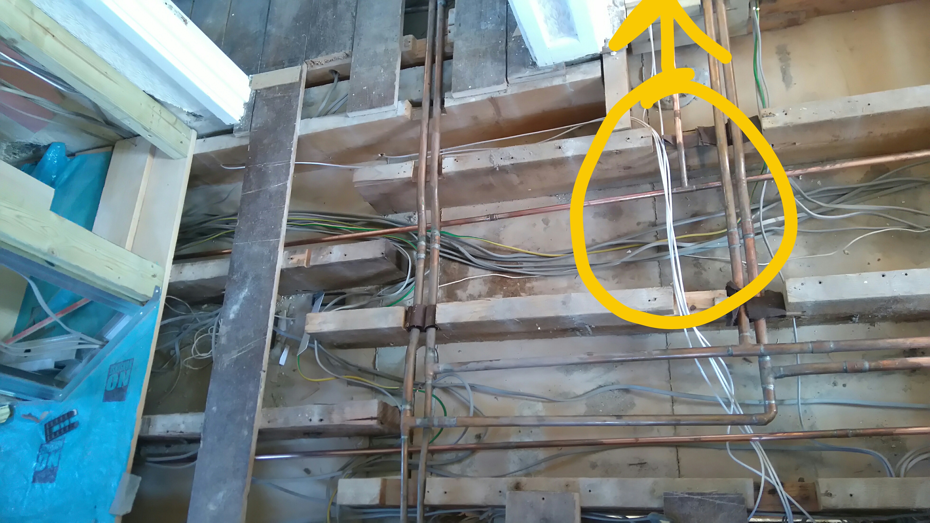

May have pic somewhere of landing feeds to a "T" where pipes move most. See attached. Ive circled the cold main showing up arrow points to 4m straight pipe which then drops 2.4 m to my stopcock then into original lead pipe into concrete floor.
Combi boiler will not help. Now all your water pipes are on mains pressure running through the boiler, so any pressure surge from the mains supply will affect your hot pipes too, to some degree.
Your floor joists are FAR too substantial for you to be my neighbour: mine are only 6.25 x 1.5" ! Although I note the same 'notch out half the joist' technique has been used (joist notches should not be more than 1/8 the height of the joist).

Yes a complete hack out job so may just as well be 3.5" deep all the way :-0. luckily the timber pre 1950 was a lot better than the matchstick stuff i've been using upstairs.

So, as most of the floor boards are still accessible and not fixed back down again yet, should I take the opportunity to strap as many of the accessible pipes down now.
Unfortunately the plumber has left some of the pipes dangling mid joists and on cables completely unsupported and this may make strapping or clipping these ones a little harder full stop see additional picture .

To be honest, that wiring is a snake's wedding: I have seen PVC cable cores push right through the insulation when in contact with a hot pipe, so I hope it is kept away from hot pipes! Also, 15mm pipe should be supported every 1.2m horizontally (about 4') so that isn't the greatest plumbing job either. It is also considered good practice to keep a 25mm clearance between electrical cable and any pipework. The proper way to support it in that location would be Munsen rings, or you can use plastic clips on a very long screw with a pipe offcut over the screw to give a decent length. Thinking alternatively, you might even be able to suspend it with some loops of cloth (old pair of jeans could be cut up) held by screws and washers to the joist on each side of the pipe. But sitting on cables is not an option.
Thanks. Pipe will be moved above cables as there are even some cables over the top at some place. Very disappointed at sloppiness of install. Will need to cut pipe to do so as the cables will not be removed from CU. so I may as well move it to the joist to the right or left .
Incidentally all these cables and main fuse board , sit directly below the bath... Hope the new bath doesn't leak :-/
