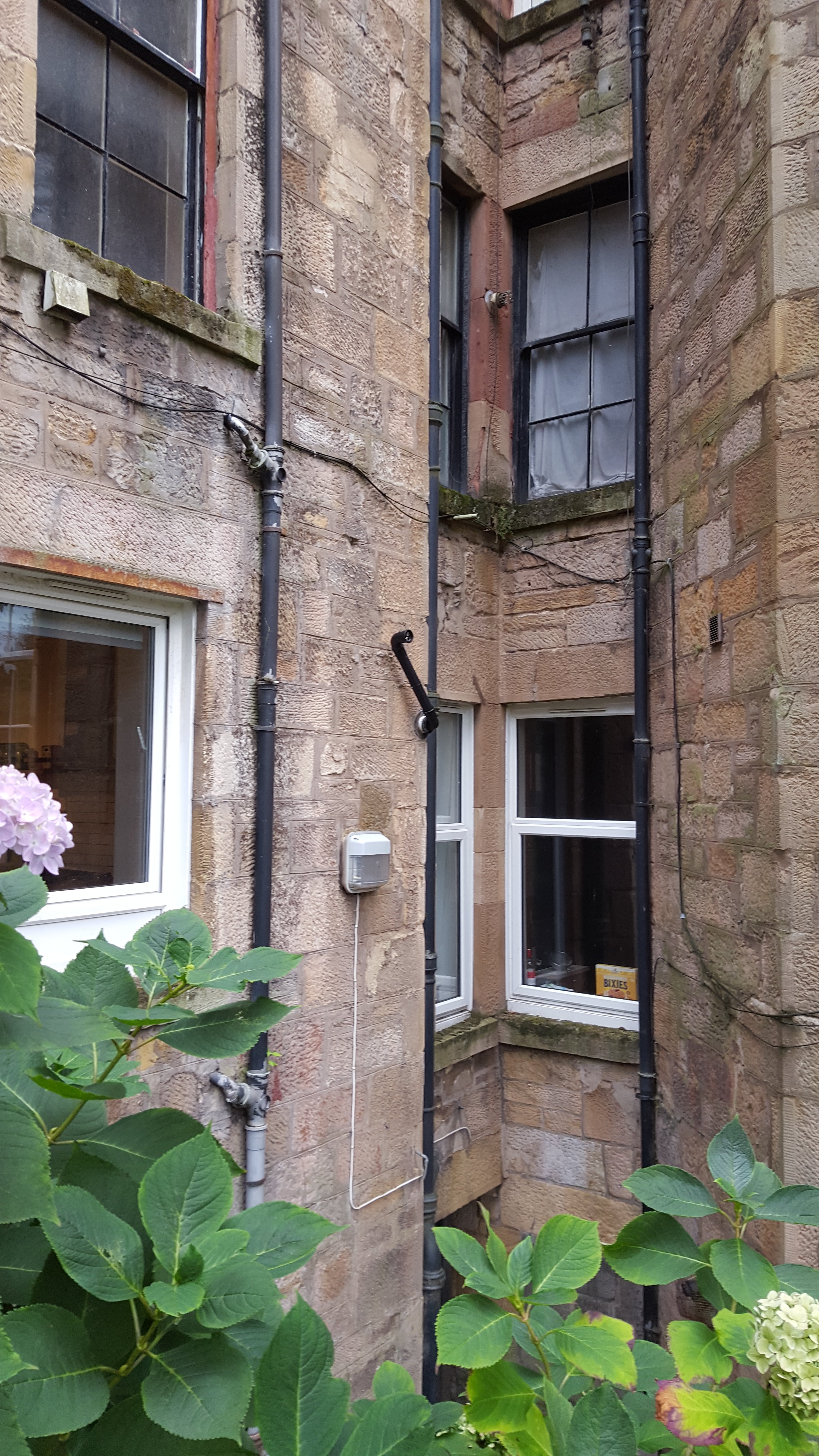

Hey folks, got a weird one here. CH system has been isolated and is not dropping ( gas test, acoustics, gauge on radiator ) Its a brand new worcester bosch 24i and is fitted with a snorkel/vertical extension outside, this is spurting and abnormal amount of water when the boiler runs, the condensate is dry but dumps a mug full of water about every 20-30 minutes. PRV has been bagged - dry, Heat exchanger seems ok. Expansion vessel seems fine, Im stuck guys, any help would be appreciated.

shaun... would it be normal to see water spurting out the top of a vertical flue...
How much water a drip is normally flue running the wrong way

sorry, picture is quite far back... i have video... but its not shareable here....
