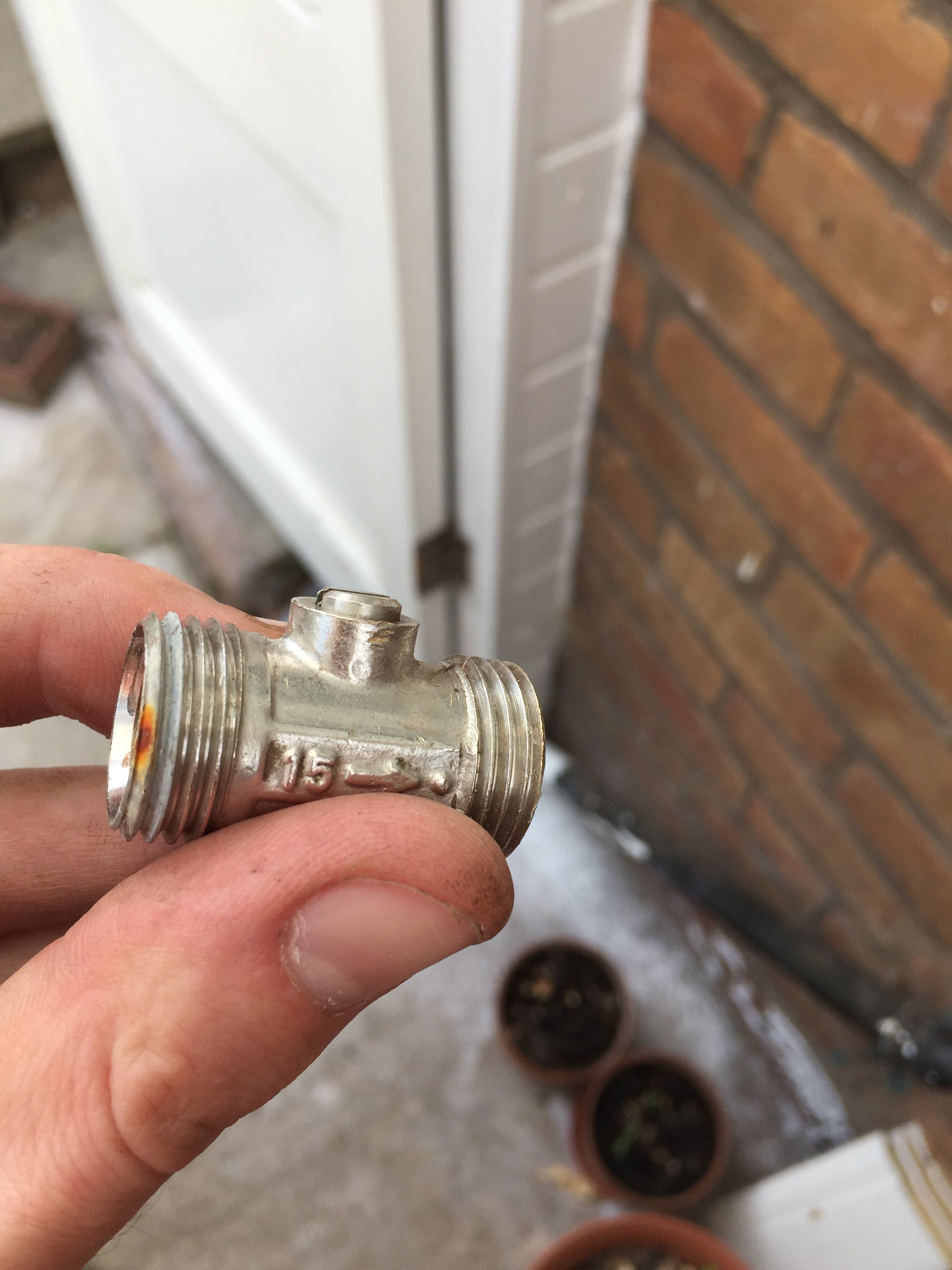

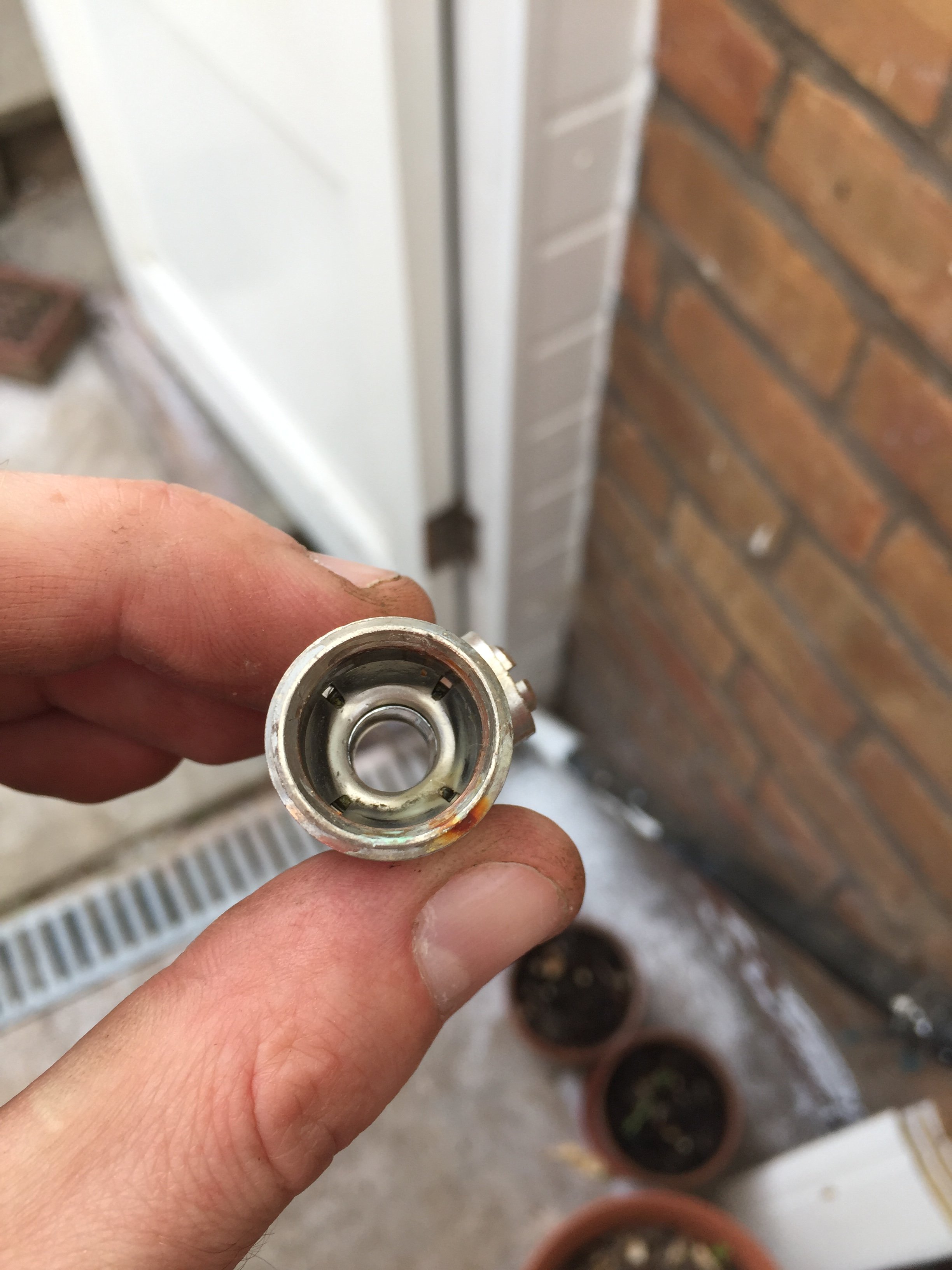

So update: replaced what i think was an inline check valve (pic attached) but no difference, in fact i think the pressure is lower still. It was just a inline connector with a small diameter internal hole - not sure if that is a check valve of not? Replaced with an inline connector which had a filter inside it - assume that is suitable.

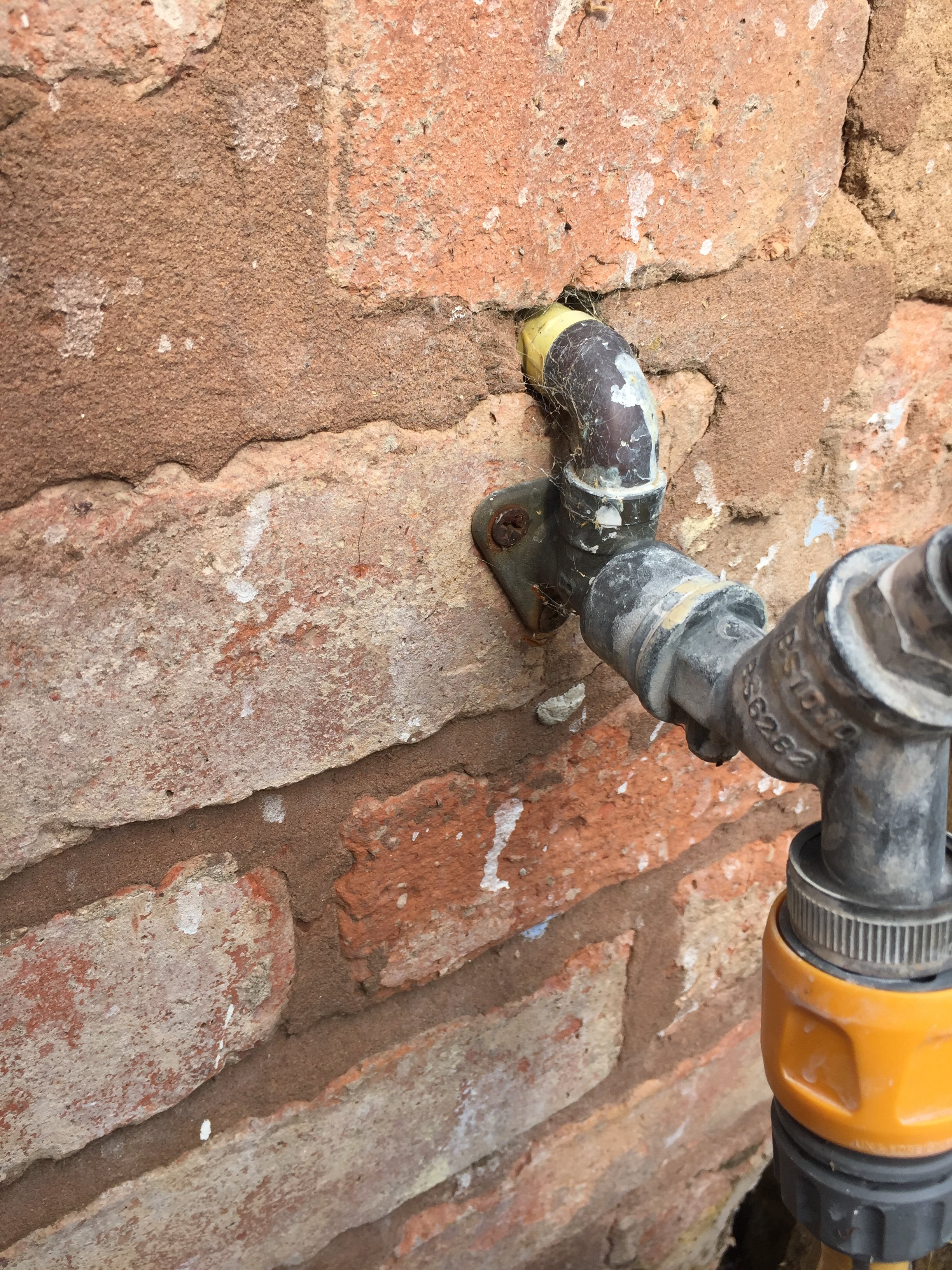

Anyway, i assume garden tap is next, already changed the stopcock. Ive attached a photo, not sure of the joint between the garden tap, doesnt look like anything ive seen before - any advice on how to replace?
Thanks all
4th pic down there's your check valve
And just unscrew the outside tap from the back plate
Lefty loosey
Right tightey
Lefty loosey, righty tighty :), ha ha. Thank you for that.
Yes, check valve is what i just replaced. Happy i might just be able to tackle the garden tap. My real concern is the joint between back plate and pipe, looks like a push fit but copper? Not seen anything like if before, usually back plates have a standard compression nut and olive joint...how would i replace the one in the photo?
You don't need to replace the back plate just unscrew the outside tape from the back plate
Apply ptfe to the new one
And tighten it into the back plate
Lefty loosey
Right tightey
