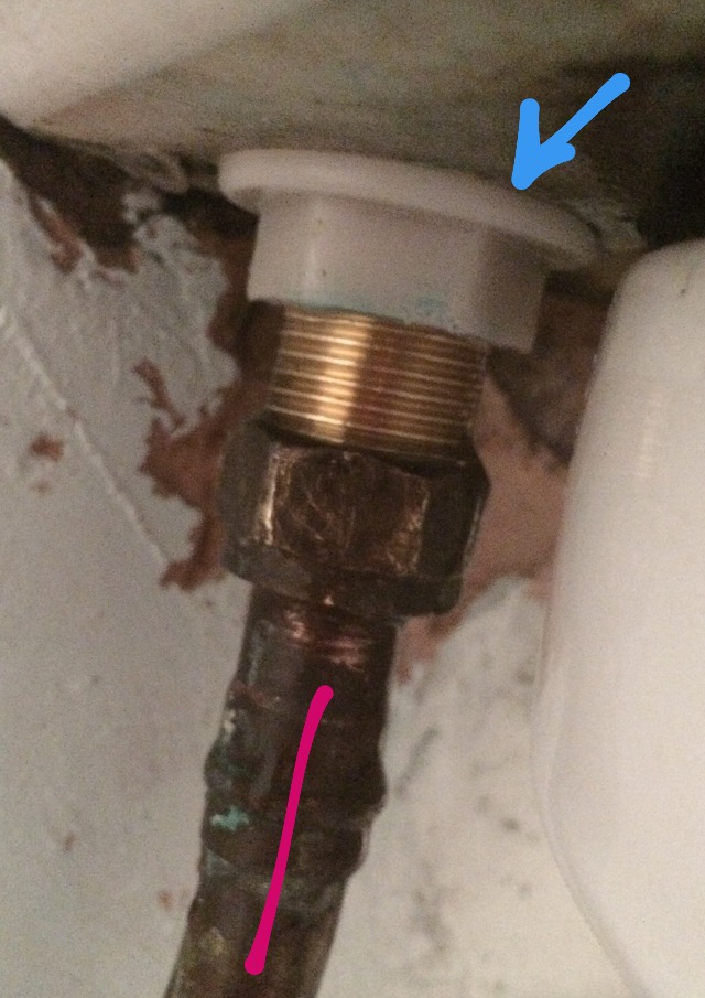

I've just taken some photos, maybe these will help. So the pink line is the inlet pipe, it's hard to tell on the photo but it's not straight and so when tightened onto the valve it pulls it on an angle and leaks around the nut where the blue arrows are, I guess the rubber washer inside the tank isn't flat/tight.
Have you only tightened it finger tight then with you saying you cant get tools in there? They always leak if not tightened enough.

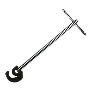

Could you get to it with one of these?
Adjustable Basin Wrench

I tried with the new nut which I could only get finger tight, then on your advice tried the old nut which is shaped slightly different so I could get a spanner at it but even so it's still pretty hard to get at so I didn't manage to get it much tighter. Still leaky.
remove the cistern, tighten the inlet. Or, cut the copper pipe and replace with a flexi
Ha yeah I thought that might be where this is heading. I think I might just call a plumber tomorrow. It's getting a little beyond me now, it was just supposed to be a simple swap!
