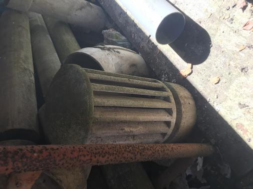

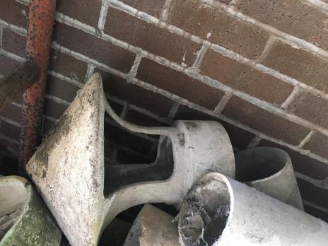

What like these :D
:D
Scary! That's the stuff! Am sure that shouldn't be lying about, but put into bags
I used to cut it using a saw blade for metal, with dust going all over.
