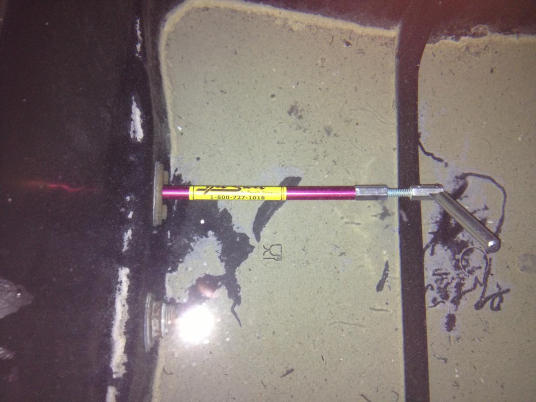

Don't think i would use it to stick like in the video (assuming it's the same as the youtube video) but to blank off tank outlets and to temporarily block feeds from F and E's while flushing, worth it's money.
Sticking bluetak in an outlet, one day it's get sucked in.

I will say this, they are fine for when another valve is letting by or you want to extend a tail from a floor but there is water in it, allowing you to hoover it out
.these are not to replace live valves......... Ever!
