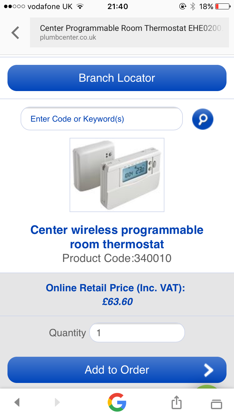

If you would like something similar to the one that you have already. Try this one. Cheap and cheerful and made by Honeywell and aparently no display problems.
thats the wireless version mate hes got the wired one
Sorry mate one of the kids woke up before I had finished what I was doing. Must have clicked post by accident. Was going to say if you can stretch to it have one of these. I also have started to fit draytons
