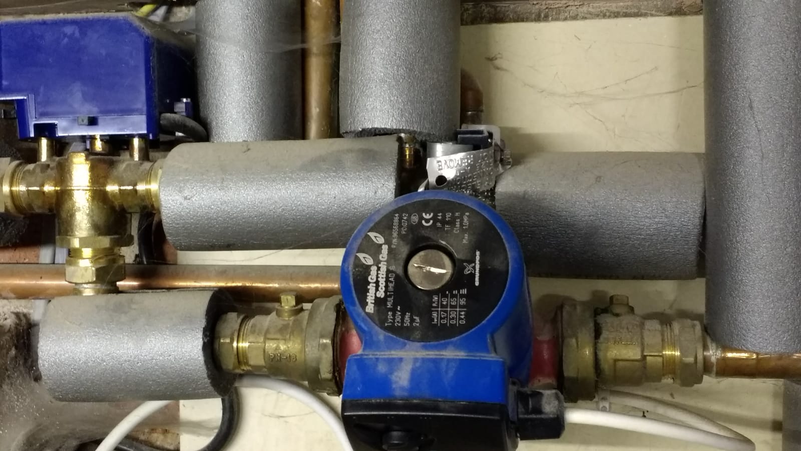

My heating pump was installed by BG with the motor shaft at a 45 degree angle. Could that account for why it is so noisy? From what I have read, pumps should always be installed with the motor shaft horizontal so that the bearings wear evenly.

Should I ask BG to sort it out on the next boiler service?
thanks
Yes it's wrong.
That'll be acting as a trap for air, possibly what the noise is.
I suspect the pump was already that angle and BG have fitted a new head without bothering to straighten it up.
when was this fitted ? it looks like an old one like we used to buy down the pub - but its still wrong unless you are in Australia

When is the service due? I would get it changed before it can do anymore damage to the bearings.
its a mutihead pump kit that british gas use can be fitted to several different pump bodies
Get the whole pump replaced probably fitted to a dirty system when was it last flushed and cleaned ? Kop

Also some BG engineers are really service engineers (like my drinking colleague in pub) not intervention engineers - this job is clearly wrong
and has returned to haunt you after a while - new pump from BG set up correctly and all FREE ..make that call

Tbh if BG have replaced a faulty/ worn pump under a service contract then you won't get the engineer altering the position of the pump if the head can just be swapped.
Depends what's been paid for

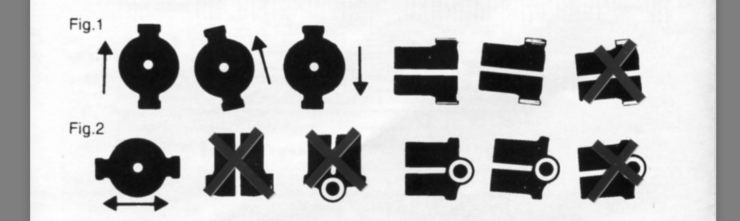

3E86658A-9B10-4EBA-B0D5-3CA5C04CC4F1.jpeg Grundfos pump head with BG logo acceptable pump positions hard to tel from photo but if don’t match get them back
