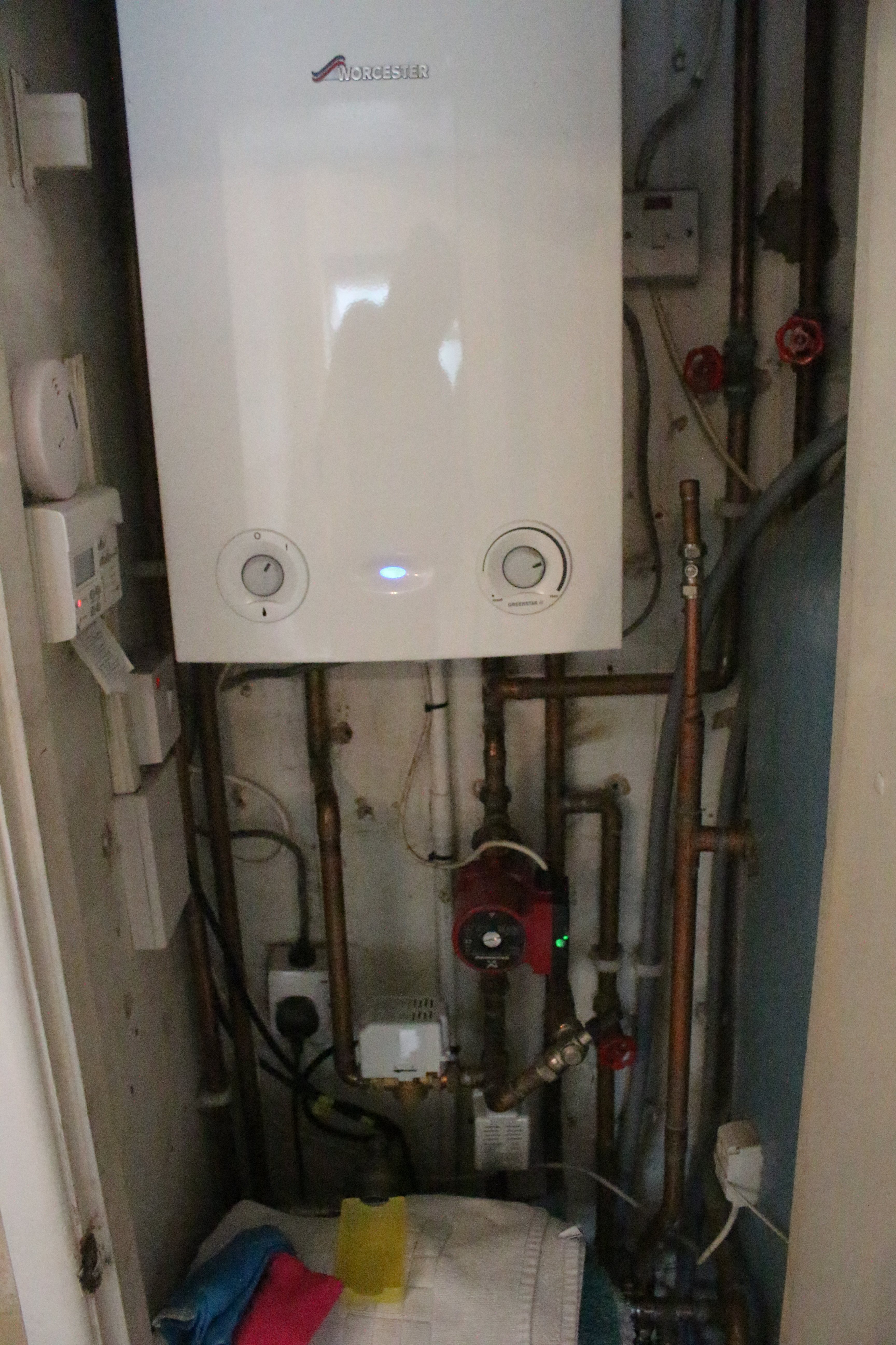

Our gas central heating comes on for an hour and a half in the morning at lunchtime it is set for on 1200 off 1200 and in the evening 1700-2200. Since we moved into the house 2 years ago it has randomly just failed to go off. For example the heating was on 1 pm ish twice last week. It can go 10 days without doing it. The first gas safe engineer I had changed the timer controller. That didn't fix it. The second replaced 2 valves, still no joy. So neither has any idea what this could be.
Any ideas?
What make & model have you got, have you spoken to the manufacturers, with so much being controlled by microchips these days it could be one of several things.
It's getting a live from somewhere.
Find somebody who will get the testers out before throwing parts at it.
The boiler is a Worcester. Going to get the wiring checked. Presumably whoever installed the new controller wired it like for like and so the problem followed through to the new one?
Really cant see the programmer could be at fualt especially as its been changed but didn't cure the intermittent fault, more likly to be the boilers frost protection or anti -seize function causing it.
The only programmer I can remember where the orange lights would come on when there was no demand was an old Landis & Gyr RWB2 mechanical type but the boiler didn't fire up it was feedback from the 3 port valve I think. Have you asked Worcester if thay have had others with the same problem?
Did your last guys actually check anything with a multimeter? I’ve had zone valves send live up orange off their own accord!
