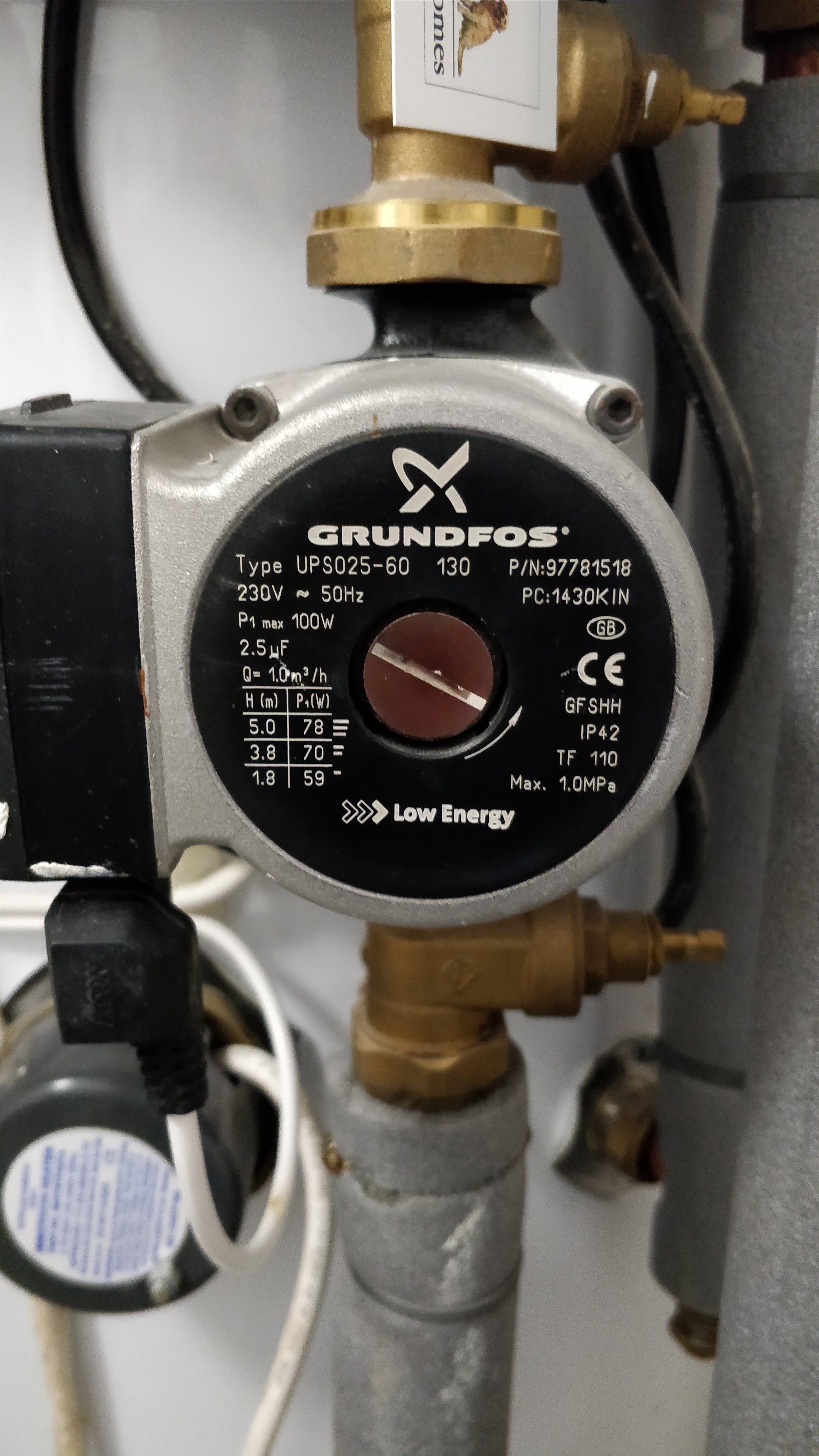

Hi All, Thanks for all the comments so far. In the early days of us moving in when we reported the cold the builder just chucked bigger rads to multiple rooms. Could they have pushed the system so the pump is not powerful enough. We have a Grundfos UPS025-60 130 which seems to have a flow rate of 1.0. The newer UPS2 pumps have a flow rate of 3.3. Could this be the solution?
