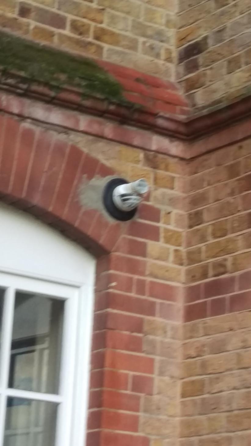

what boiler is it and could you take a pic of the flue outside

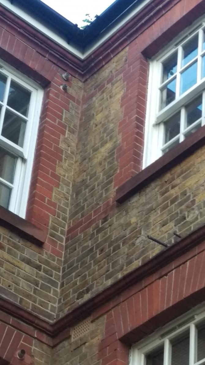

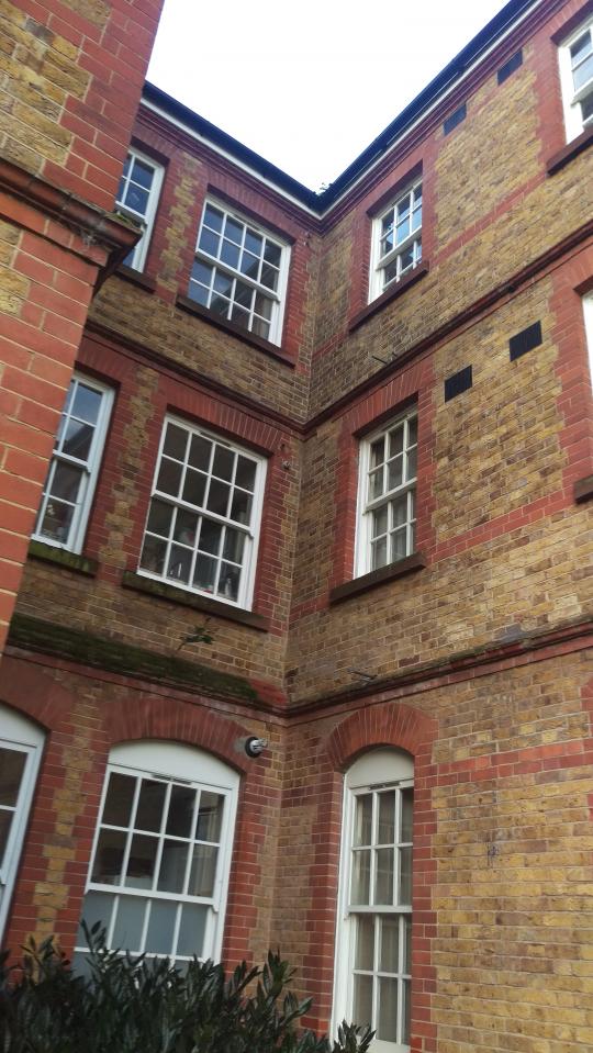

Does sound like a gutter joint leaking onto it. You will need to go outside when it's raining and see if rain water is being directed onto it from somewhere.
so, based on your posts, it looks like the drain at the top of the building is blocked and is probably overflowing during heavy rain. There is a plant growing in the guttering, and i can see the moss has been washed away over where the flue is on the wall.
I would think this is the most likely cause? and would explain why it only happen in heavy rain
i will ask the management company to resolve this.... whoever they hire to clean the guttering obviously did a crap job.
is there some way i can prevent this from happening again in the. future? I am not in charge of cleaning the gutterings, and this seems like it could easily happen again.
