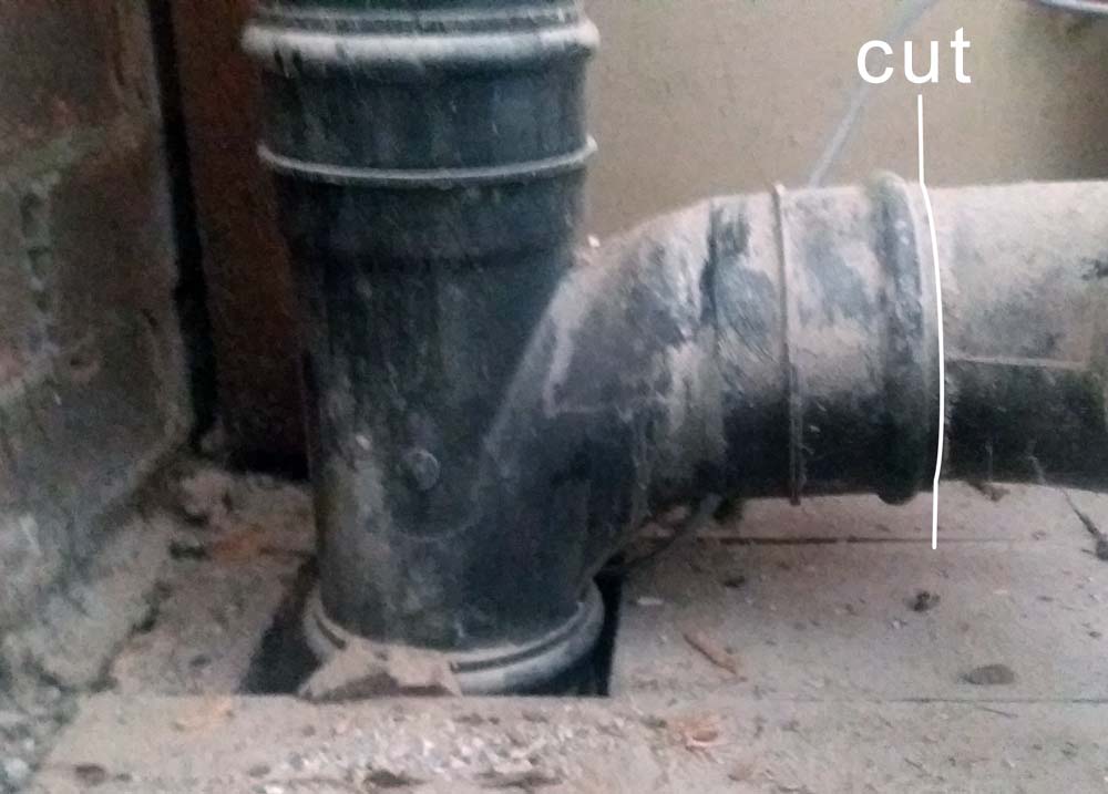

I would like to add a 40mm waste pipe into this old fitting on the soil pipe shown in the photograph below.
There is 50mm clearance between the the bottom of the inlet pipe and the soil pipe rim just enough room (I think) to put the strap around.
The diameter of the pipe fitting is the same as the soil pipe and the plastic reacts to solvent weld glue.
If I can get it to fit is this a practical solution?

no you cant as its a bigger dia and the strap wont fit replace the t
and as above if your working as a plumber you should know the basics before you quote/ are doing a job

The strap should fit:

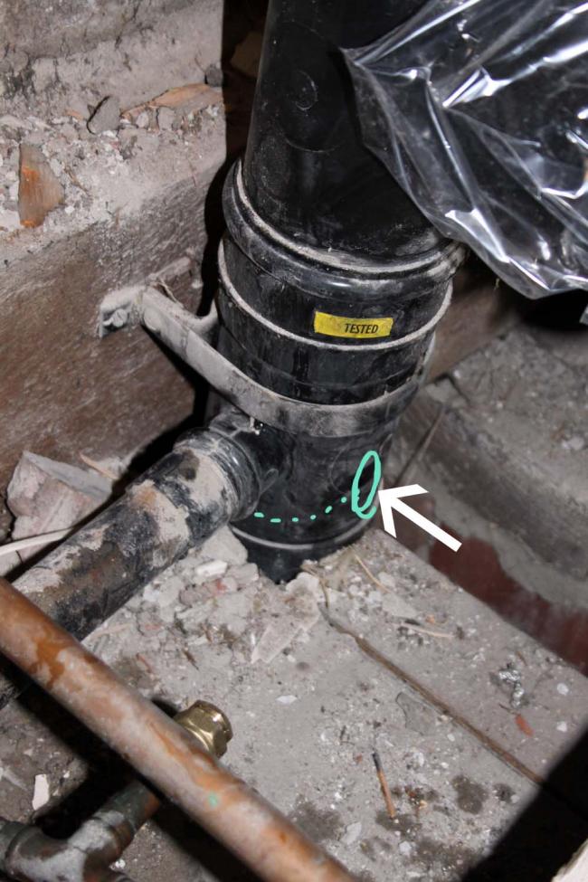

Same - different angle and some floor boards removed though
I`m not getting in to an argument with you as camera angles can alter a picture however it looks different to me.
I`m out.

Still won't fit
Judging by picture, which might be deceiving?
You can't attach another pipe there because of the danger of cross flow.
