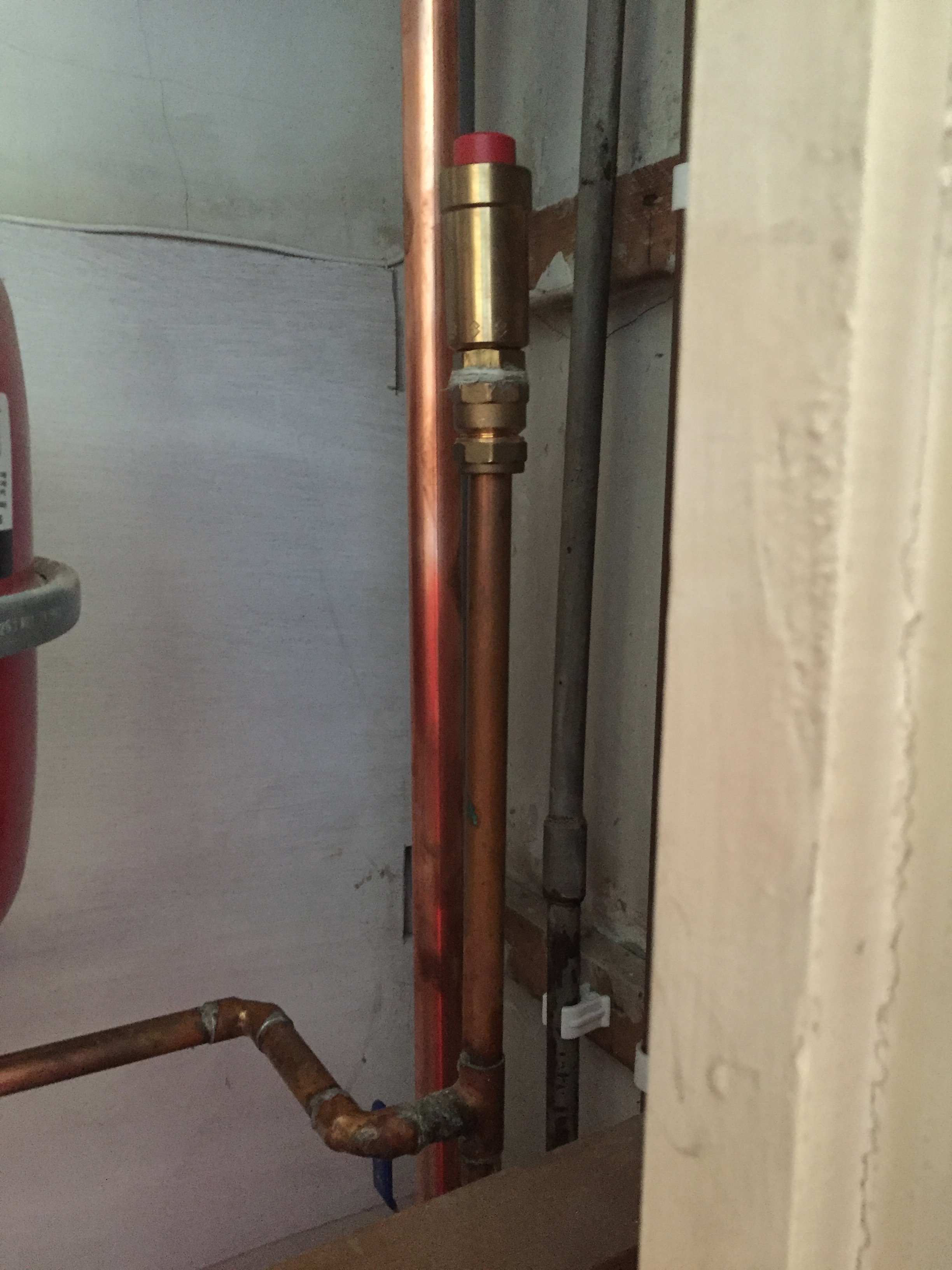

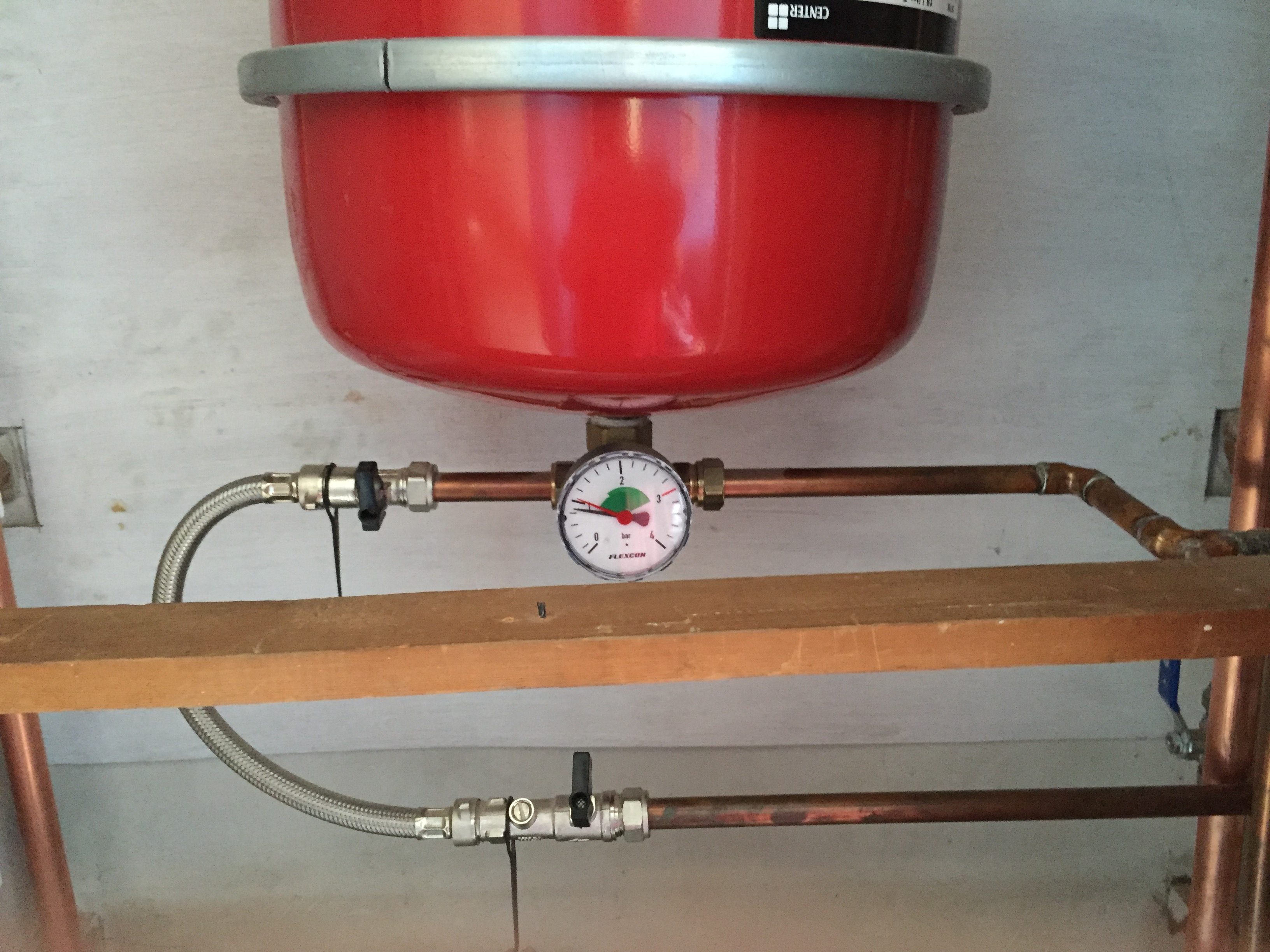

My current setup (see photos) has a separate pressure valve but all of the new vessel connectors seem to have it included in the connection assembly.
Could I simply plumb in a new connector with an integrated valve and remove the one and cap or modify the pipework to get rid?
Secondly, I don't see any pipework heading outside as a pressure valve overflow so I would assume my existing valve would just open and let the water out into the airing cupboard? If that's the case could a new integrated valve be do the same? I don't see why not and other than making a mess would be the same as now.

That vessel in incorrectly installed and should have been fitted with the water end upwards - in other words, the gauge end in photo should be the top

The valve in pic 2 is an Auto air vent.
That's why there's no discharge pipe.
The discharge pipe must discharge somewhere other than a cupboard where it'll would get rather hot, steamy and wet.
