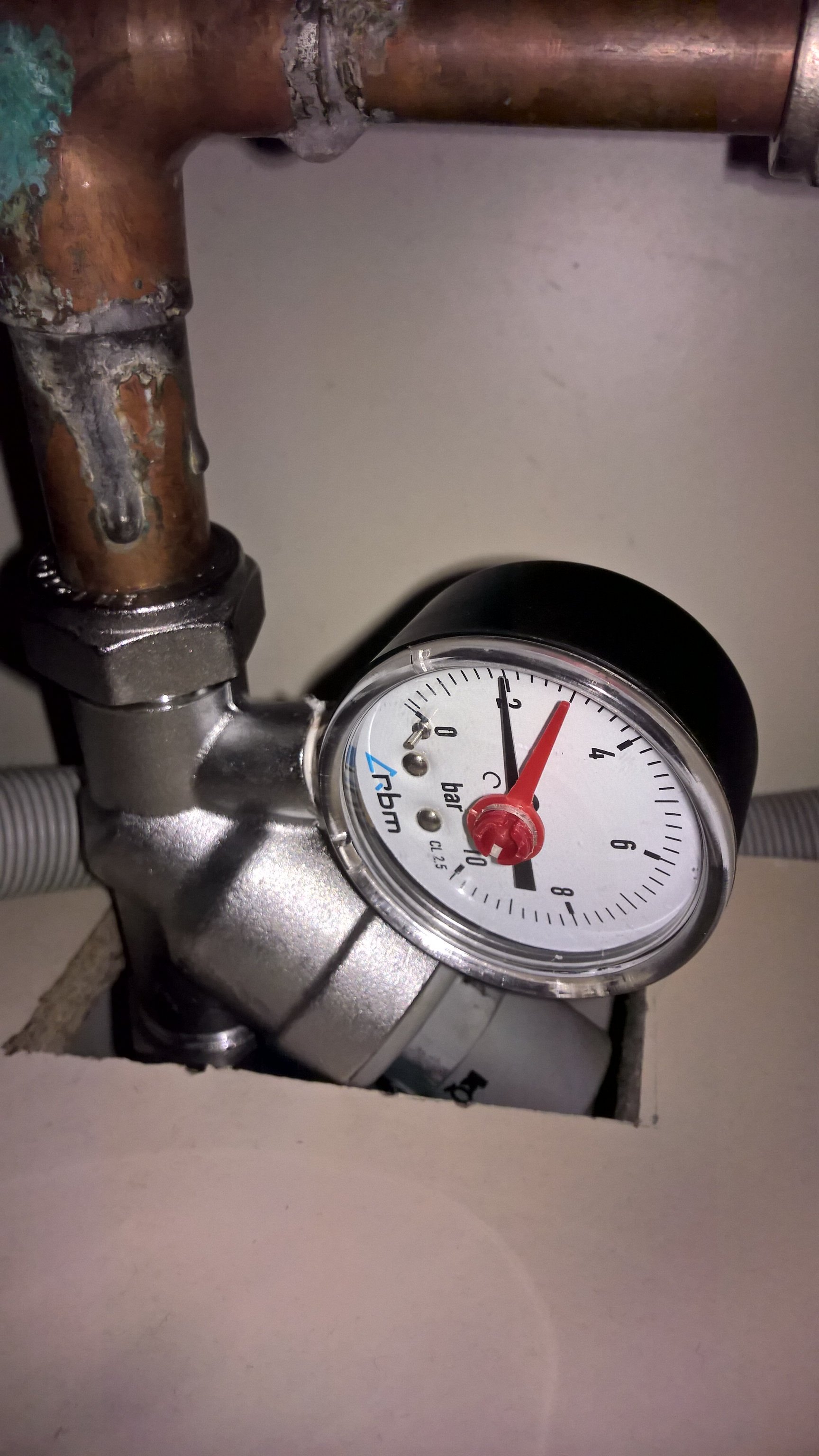

Best - I don’t know if the plumber who fitted the PRV is G3 qualified unfortunately. He fitted the PRV and changed some taps for us, and didn’t do anything else. I can attach a picture of the PRV if it would help? It has RBM on the face of the gauge. Excuse my ignorance here, but what could be the right (or wrong) type of PRV for the situation?

A picture would be great
I've attached a couple of images. A 'before' one with the pressure at about 3.5 bar, and then an 'after' one when a tap has been opened and closed. I hope you can see enough of the valve in the pictures? Otherwise I'll need to empty the cupboard and pop out the shelf.
The water regulator you have will regulate the pressure of water flowing. It may creep over the set pressure a little when standing but not normally by much.
