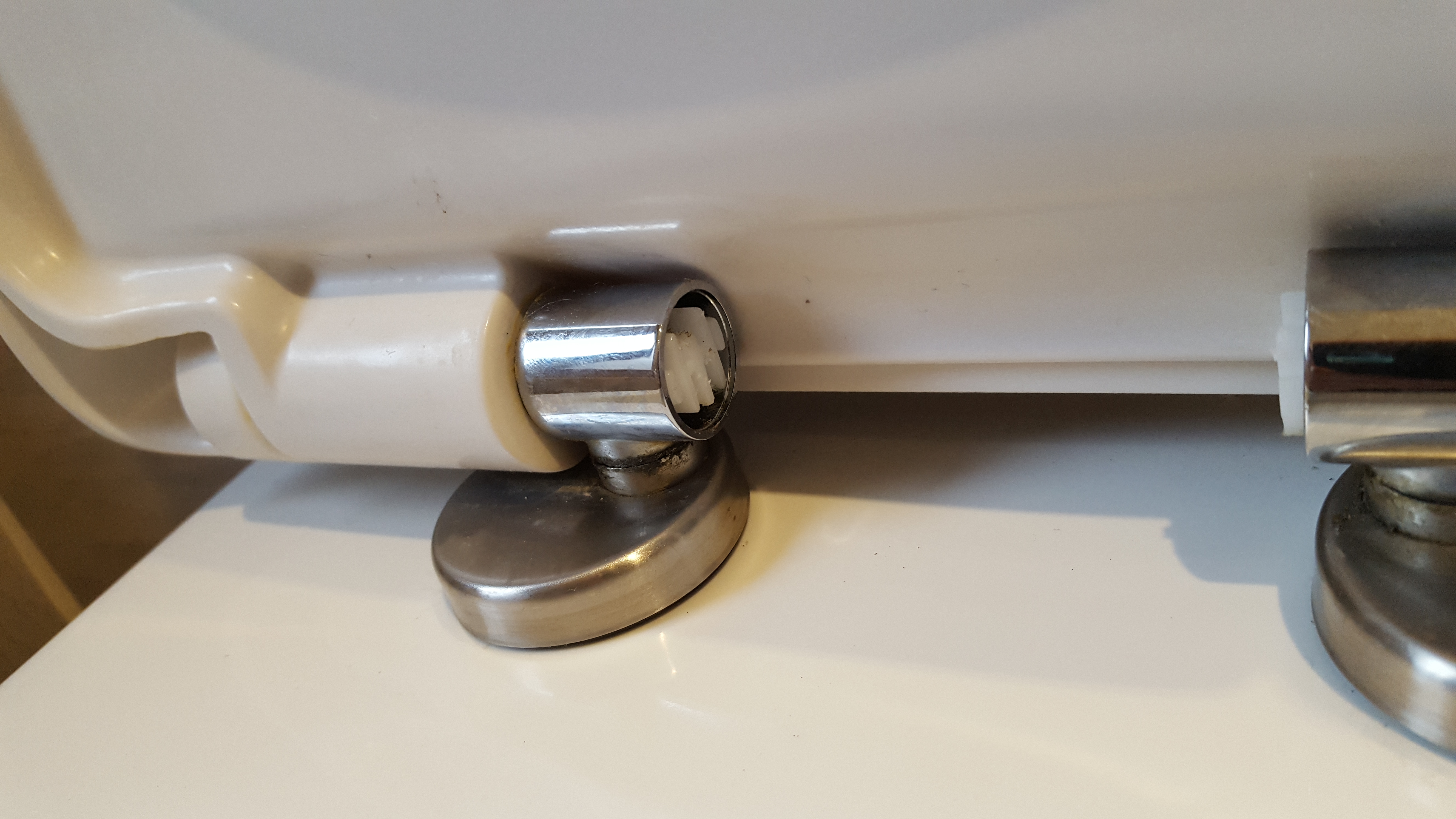

Hi
I am trying to remove this WC lid, thought I could just push in the lugs and lift off the seat. (It is top fixing as you cannot get access underneath)
I need to remove the seat in order to tighten the connections as the seat is loose.
Anyone any ideas please
Paul
Hi there. Just to let you know that the picture is a toilet seat and not the WC lid. Do the white parts inside the chrome parts turn or move at all?
Sometimes you can remove just the toilet seat by pushing the white things inside the chrome part and then you can lift the toilet seat. Once that done you could do as explained above lift the chrome plates and there should be a screw to ooosen the rest.
