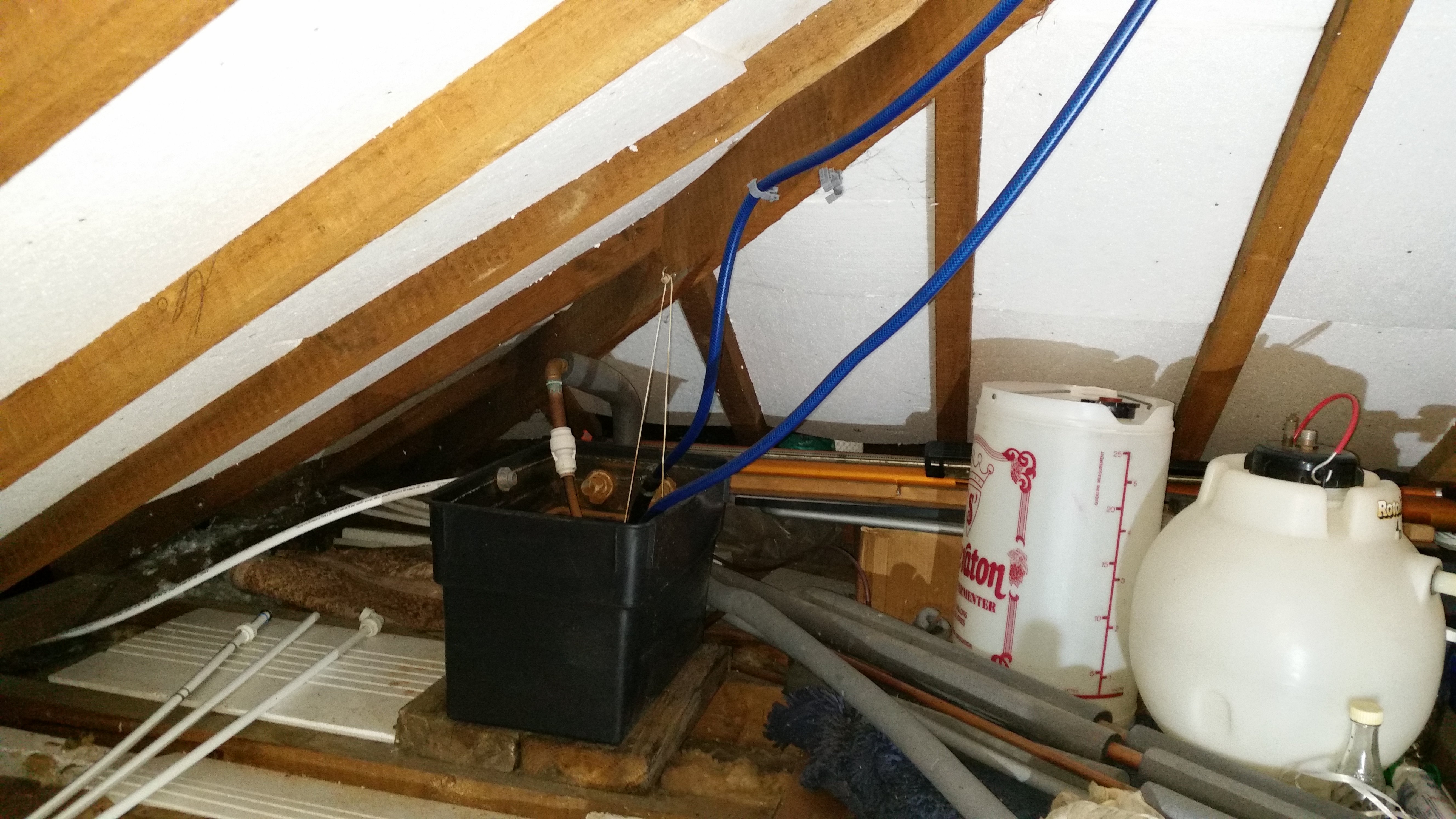

I went to look at a job the other week. Customer said the had a leak in the airing cupboard. There was a nut he wanted me to tighten.
Flow and return on coil leaking but not from the compression fitting. The cylinder was damaged. I said he needed new cylinder. He also said he had a leak in the airing cupboard above the cylinder. I could see why overflow not even glued. I said do you mind if I take a look in the roof space. One not glued joint could be more.

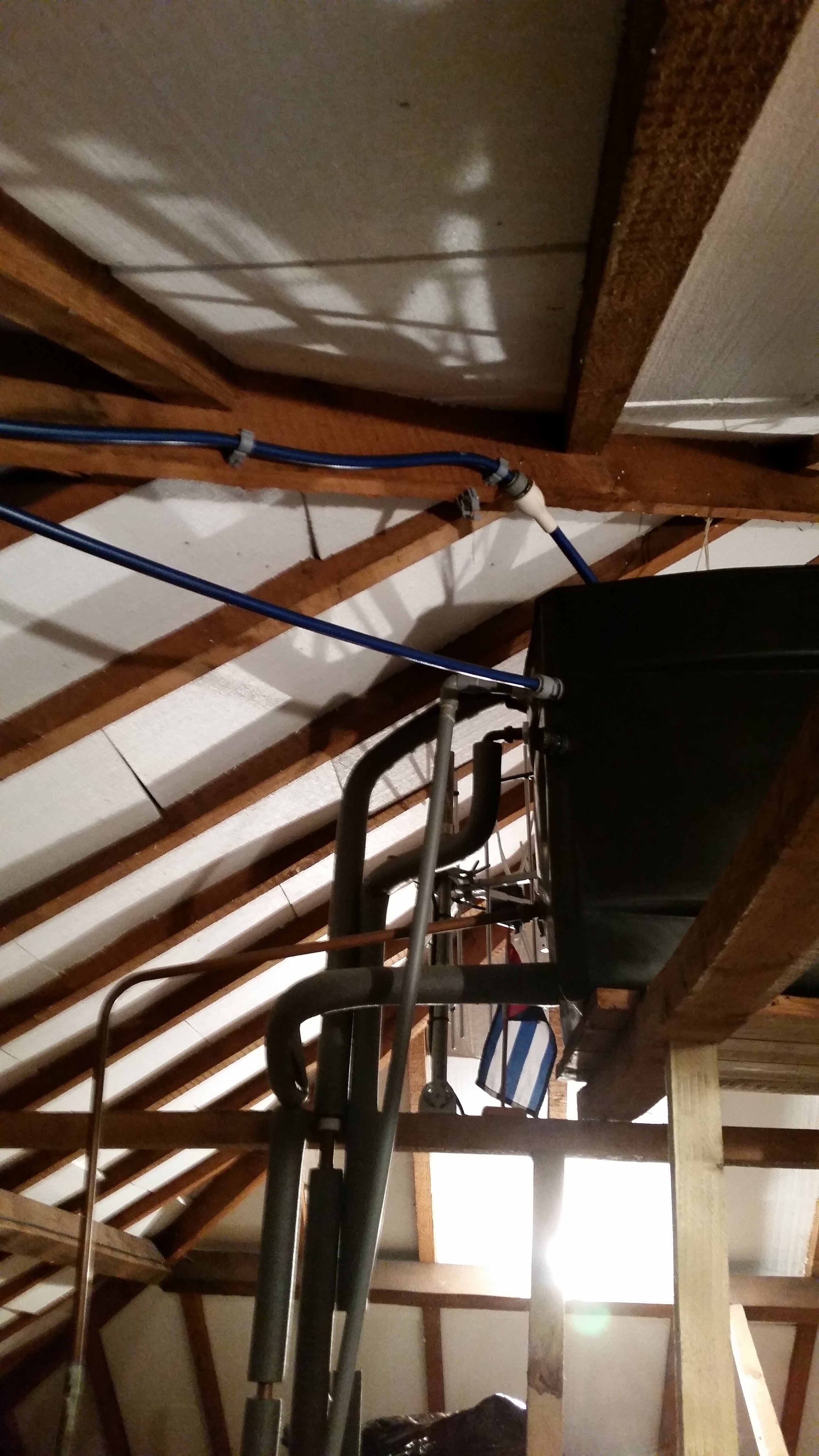

He said he had stopped the leak with a bit of tinkering in the roof space. Can you imagine the shock I had when I saw this.

Lucky for him off the shelf cylinder, and all new section of overflow. One happy customer.
Crikey! That copper pipe joined to near the bottom of cwt is extremely angled. Maybe tank is being stressed, but photo not clear enough.
Pipes angled across the joists from around the f&e tank just always seems wrong to me, getting in the way and wasting space.
The vent into the f&e could have easily been piped a lot higher
They are hose pipes :D
everything was a bit strained. all sorted now :)
He had connected the feed to the F&E to the cold water storage, via his own connection, and the expansion for the F & E into the top of the cold water storage :eek:
On the plus side, - the timber below the f&e tank would support the weight of an elephant. At least something is good. :)
What's wrong with that? That'll be fine for years:p:p:eek::eek::eek::eek: only joking. Did you explain to him about messing with stuff like that? And that he would have done damage to himself and his property in the future? #whatgoesthroughpeoplesheads?
I suggested he should of kept trying to find a plumber before he did this. I explained he could have contaminated the cold water in the storage tank. At which point he climbed up a ladder and looked in. Perfectly clear he said. :D
You just can't explain to some people. Health, Dangers etc.
I knew you had been there before, the truth is out :p:p:p:D:D:D only joking.

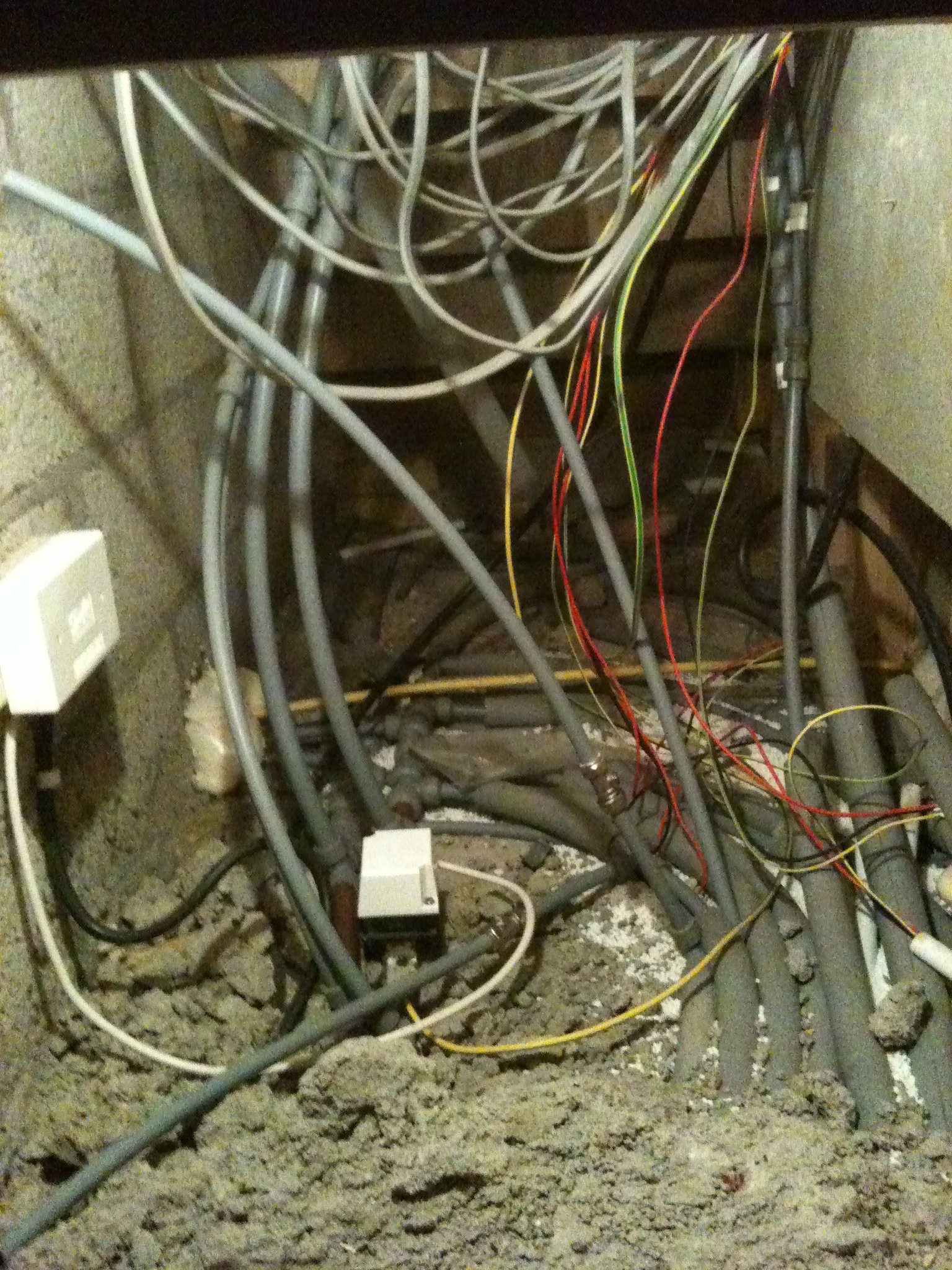

That was a new build house, (part of a large development) where I was asked by the owner to try to fix loads of heating faults.
That was below the stairs when I opened the door to look for faulty motorised valve. Any builder and plumber doing work and leaving work like that has clearly no interest in doing proper work.
I did not do that work, nor would I do temporary work like that.:)
Oh!! a throw it together job :D. I don't get involved in any of that time of job.
