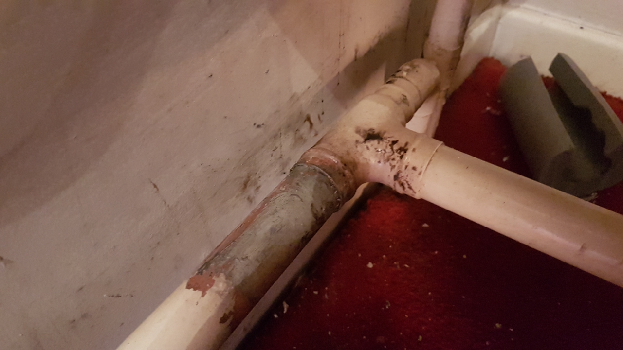

I am not to impressed by the state of the prep and soldering.... to me it looks like they have not cleaned enough of the paint off...
We now are left with no heating and no hot water as they have not replaced the immersion heater element...
See Attached.... a bit messy don't you think?

We have had a Gas Engineer from British Gas to alter the Magnaclean onto the return and he has pointed out a couple of problems.
  1. There is still a water leak in the airing cupboard which he said to me on the phone has not been soldered properly. It is the one closest to the floor. He also said, and put right, a leak that was still there above the boiler with a new drainer off.
  2. The central heating pump has been fitted on the wrong way round so the flow of water is wrong and could cause the boiler to overheat if set to high.
