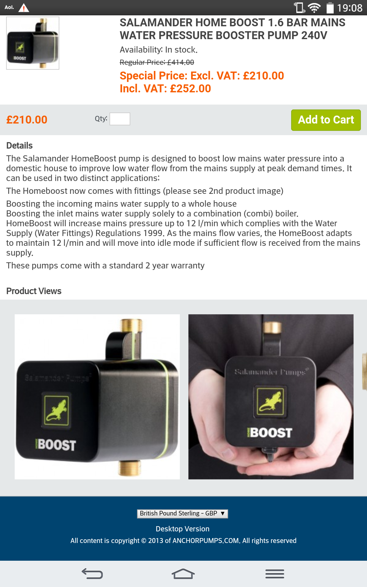

Salamander homeboost pump is a affordable option it will give you 12 litres a minute at 1.6 bar but it would be best to know what you have before committing to anything as shaun said. Cheers kop

This problem has been discussed many times you may have sufficient pressure and flow on the ground floor but it drops off the higher you go in the property at times of high demand morning and evenings it will be worse , i suggest you employ someone to carry out the tests as shaun has described , if this does not improve your supply then the Homeboost is a affordable option it needs to be fitted as close to the main incoming stopcock and obviously before any take offs download the installation instructions to see if its a viable is my advice best of luck kop

Steadyon has described it quite well someguy the higher you go the less pressure you have to supply your outlets , what do you mean pumped electric shower ? Just fit the salmander homeboost it will adapt to the demand needed and a normal electric shower unit .cheers kop

The Homeboost will just bring your pressure up to an acceptable 1.6 bar and 12 l/min flow rate for your combi through the main. The combi boiler won't "know" there is a pump but will just enjoy better flow rates and pressure which will passed on up to your shower. The homeboost is ideal for what you are trying to do.
Stigster has got in before me but that is the advice i would have given you can boost the water supply to a combi to give you a better performance, you cant have a pumped electric shower off the mains as one unit,your new Mira shower will be fed via the homeboost connected to your rising main water supply and be powered by electric via a 10mm twin and earth cable from your consumer unit and a isolator normally outside the bathroom , the other hotwater outlets will be fed by the combi . cheers kop

So, while I'm still not sure if something like the unit I linked to above is actually within regulations off a direct system - the actual answer here is that I'm better off boosting the water pressure as a whole before the combie, rather than just a pumped electric shower.
