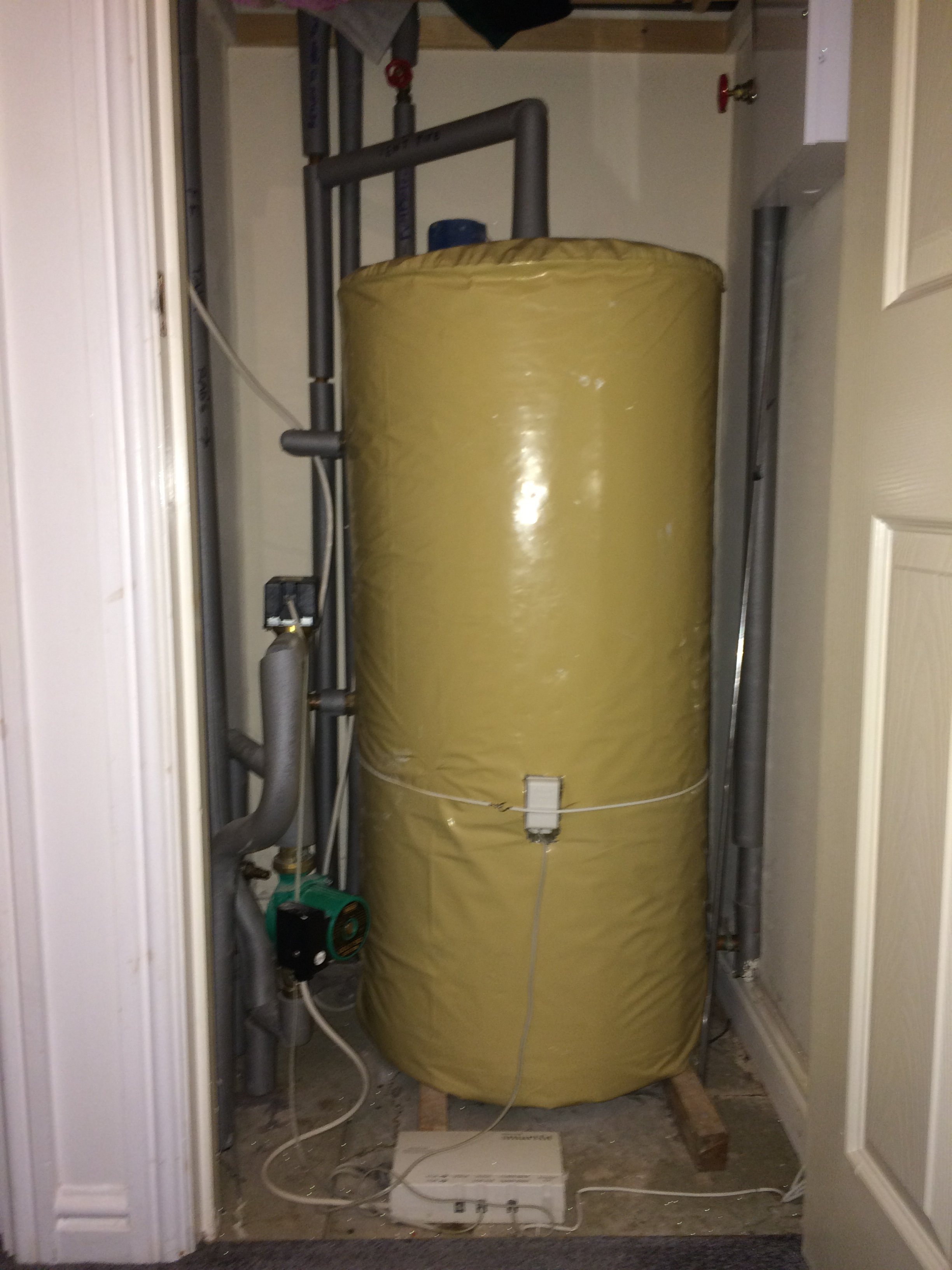

Would any pictures be of any help in loft or cylinder layout
Thanks for the pic, your system is fully pumped - it's great to see the pipes in the cupboard insulated as well!
BTW did you replace the float "ball" when you replaced the ball cock? What I'm getting to is the float "ball" filling with water and opening the valve?

On another point, - that shower pump has been installed completely wrong. Looks diy. I know this is nothing to do with the overflow.
The pump manufacturers instructions have been ignored obviously.
Pump would be best on floor in airing cupboard. Pipework is wrong - hot from cylinder and pipes from cwt. Ballvalve is supposed to be opposite side of tank to outlets.
