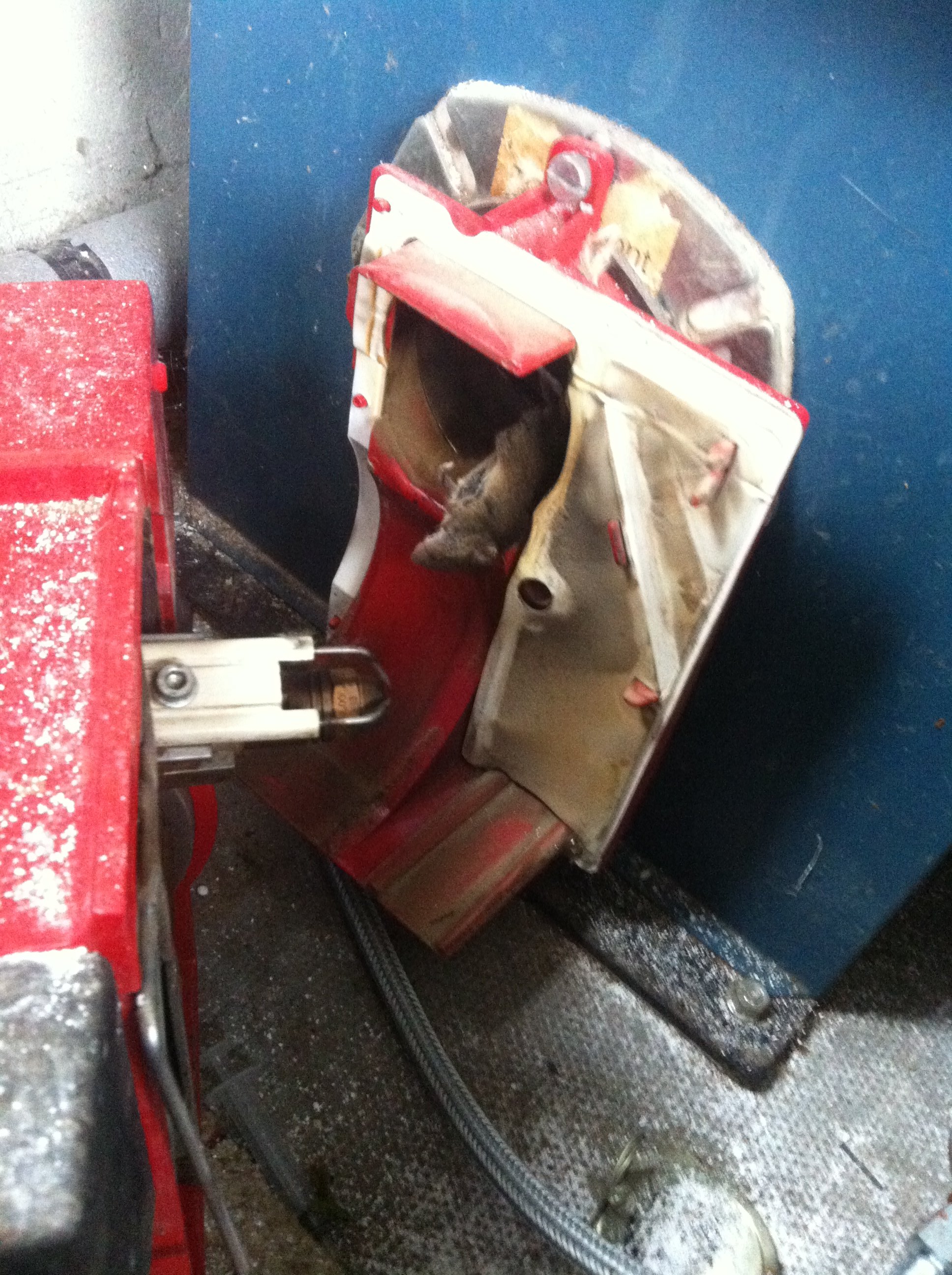

I had a mouse break down. Autopsy report said "electrodes working well"
