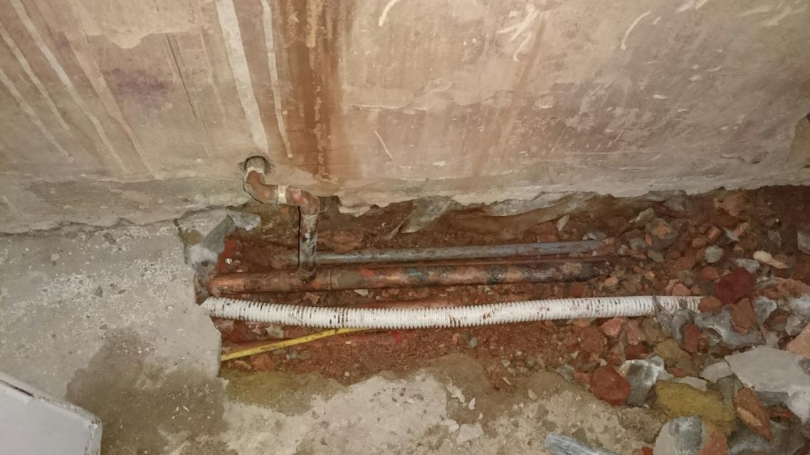

Basically I had a leak in the central heating system (it's all brand new and the combi boiler started losing water pressure few months ago and it gradually got worse) after months of looking for it, I think tey'v efound the issue. It was a small leak under the bath and yesterday when they removed the bath and dug out to expose the pipes they foudn the leak.
The leak was in a T junction of one of the big copper pipes (22mm I think) and the drain (to empty water in central heating pipes) going outside the bathroom/house. This new plumber used by my builder/contractor yesterday created this apparatus to connect a compression meter and left it overnight. This morning we found there was no pressure loss in the combi boiler (phew!) and the plumber said the compression test passed. So we know that small leak was what was causing the loss in water pressure.
Anyway this morning the plumber left pretty much all of the apparatus but I am not entirely happy with it so wanted hear expert opinion. There are lots of joints in there (probalby 5,6) plus he's got joints going from big diameter pipe (probably 22mm) to small diameter copper pipe (probably 15mm) back to big diameter pipe. I've read that leaks are likely to happen in joints and the more joints you have surely the more chance of future leaks?

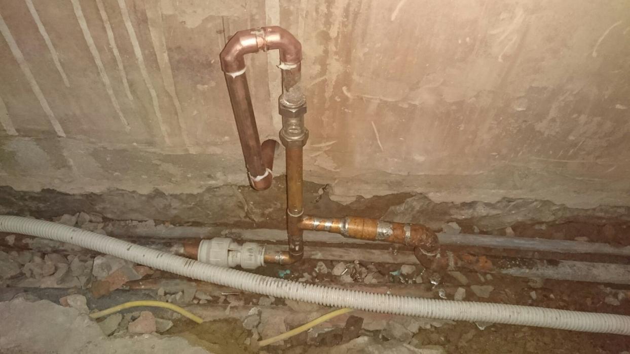

What do you think of this work? See picture attached. You can see how it was before and how it is now.
I probably prefer it to one straight pipe like before (but without the leak obviously)

Pipe straight through in 22 mm,with slip coupling, and put drain off at rad valve where any future plumber can find it. Get rid of plastic fitting.Sheath pipe to allow movement. Original leak probably caused by restriction of tee piece in screed.

All brand new work, - you said?? Looks very poor DIY job. Those pipes should have been insulated to begin with.
Re: Central heating leak found but not sure about how the plumber has welded the pipe
i agree poor effort, also to insulate correctly they would have to dig up more than is there. all the copper needs protecting from the concrete, not just the small section shown.
And the 15mm valve is not rated for central heating.
If it's all buried as it looks just in concrete then prepare for many leaks in the coming years as concrete attacks copper and rots it over time.

Poor effort I'm afraid alot of things wrong there

The pipework ( new and existing) is terrible. No insulation, nothing to stop corrosion. That's just the pipework!
Where's your damp proof membrane, where's the floor insulation? Your guarantee is not worth anything.
I would get building control to have a look at this, as your looking at all sorts of problems in the future.

Guys, thanks for the replies but I'm stuck between a rock and a hard place. I did a full refurbishment as soon as I bought the flat about a year and half ago. At the time I had no idea about anything building related but I've learnt quite a lot (and important lesson not to trust most tradesmen and always keep an eye on them) but there's still a lot I don't know. I relied on my builder to do the right thing and whilst I think he's a good guy (he's sent his men around numerous times to fix things) he wasn't supervising them.
I dont' think the the plumbers he's used are gas certified. I believe the boiler installation was done by a separate Gas engineer and I've already got a gas safety certificate for that. Anyway I'm going to get an annual boiler service done by a British gas engineer soon so I'll ask him about the installation.
I go the plumber to dig out and expose the pipes in the bathroom and insulate all of it before adding concrete. I don't know if rest of the pipes that's under concrete (in the kitchen and part of the living room) are insulated or not but when I spoke to the plumber who did the work originally, he said he did insulate them but not sure what happened in the bathroom. He said he did insulate the pipes in teh bathroom and someone else has removed the sleeves.
It appears there's no damp proof membrane or insulation installed on the floor. Could this be causing damp issues? I had another thread created a while ago about tiles breaking in a section of the bathroom floor and how the floor was damp when the tiles were removed. Teh damp could be as a result of the leak from the pipes but the section of the floor that's damp seems to be about 1.5m from where the leak was.
Realistically there's not a lot I can do. What if I get building control? What's he going to tell me that I don't know? It's really not an option to rip out living room floor (wooden), bathroom and kitchen and re-do the whole thing. I think I'm going to have to bite the bullet and hope that no leaks/other problems appear in the next 10 years or so. After that I could do another refurbishment but this time armed with the knowledge I'll make sure the builders follow proper guidelines.
PS: A quick googling of copper in concrete revealed that there;'s no conclusive evidence that concrete corrodes copper in fact some studies found it has no effect but they seem to suggest that joints could be damaged.

It looks fluxed but not soldered in the picture

Funnily enough I thought the same but assumed it was the pic

I also would not use a push fit ... will definitely leak at some point ... as mentioned here many times get a proper plumber out and let him do a professional job .. pay a few quitt more but in the end you safe a whole lot.
Once everything is been installed and hidden it will be a lot more expensive to you to sort those leaks out.
What's the point of leaving it in as it is ? Just get it done and bite in the bullet that way and get it proper installed, you will eventually thank your professional plumber and ukplumbingdorum for all the advise you got from fully qualified engineers.
As mentioned above did you make sure that the other joints are welded ? If not next time you fill up it will gush ..

PS: The 2nd picture was taken before the guy could solder the joints at the top.
