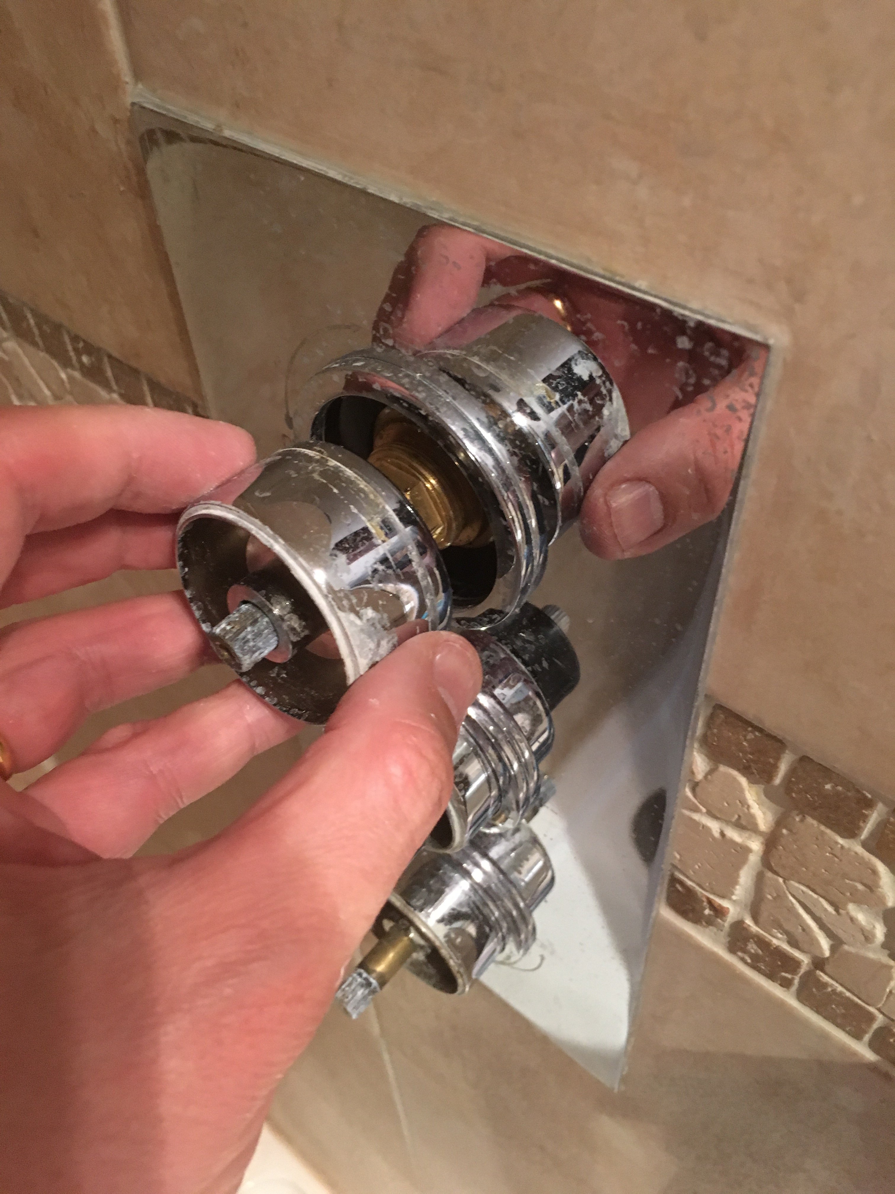

Same old story, bought a house a year ago, the vertical concealed shower unit has started to malfunction totally - no cold water at all entering the mix. No branding anywhere on shower, and no paperwork from previous owners. Would like to look at replacing the cartridge. Have also posted the pics on shower doctor. Any help much appreciated!

Attaching a better photo of the full valve. Does this help determine if it's TC Bathrooms? If so, any idea where I might go for the spare

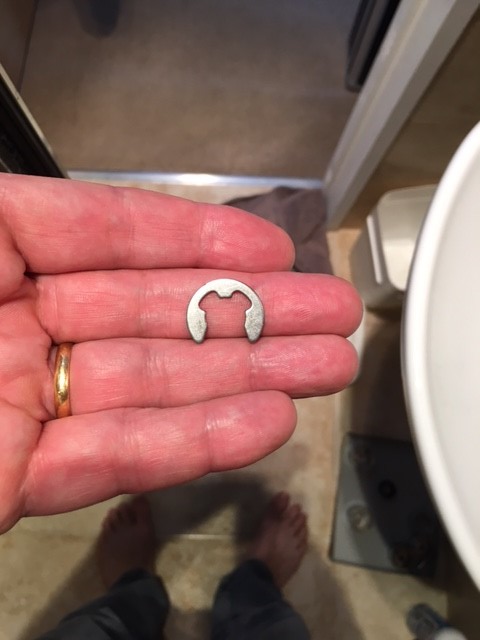

Also - I forgot to mention that I removed the thin silver collar that you can at the 10cm point on my original photo - see also new photo attached of it sitting in my hand. This collar was stopping the full movement of the central shaft in the cylinder - you couldn't get the handle to turn at all on the unit - but it's since removing it that the cold water has disappeared totally from the mix (despite the fact that full movement has returned to the shaft). Could this be the cause? (apologies in advance - this might be a completely stupid question)
