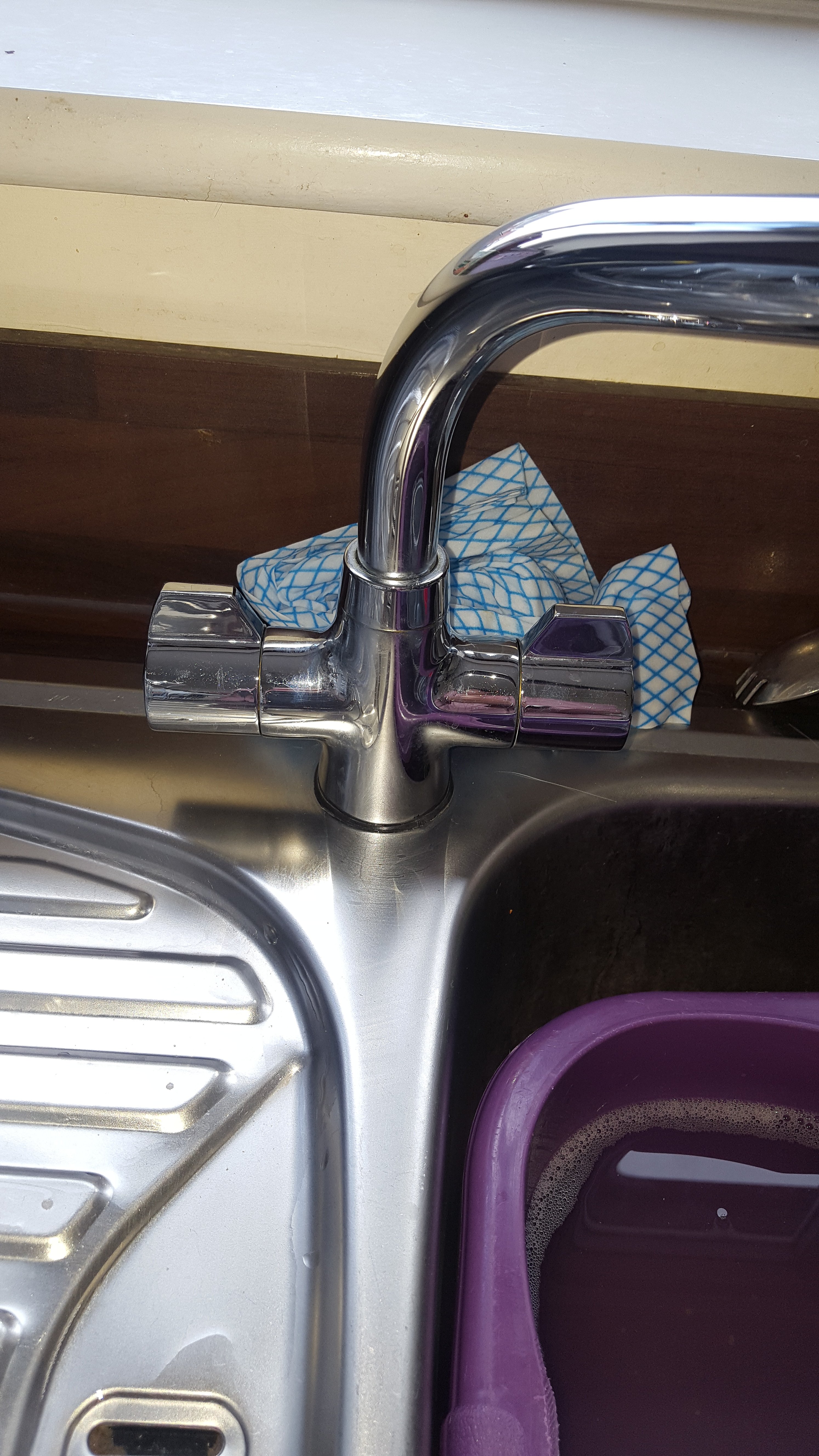

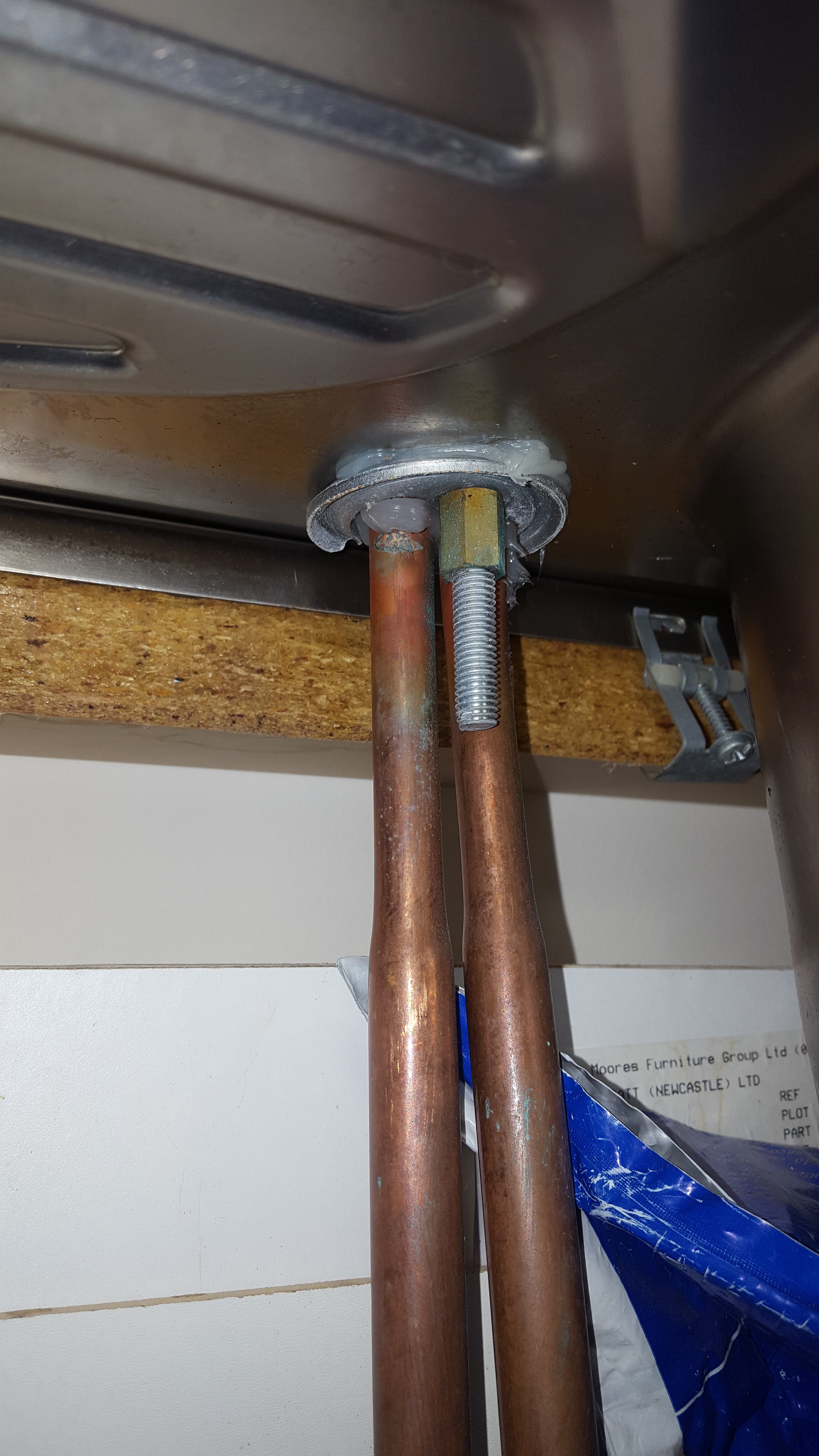

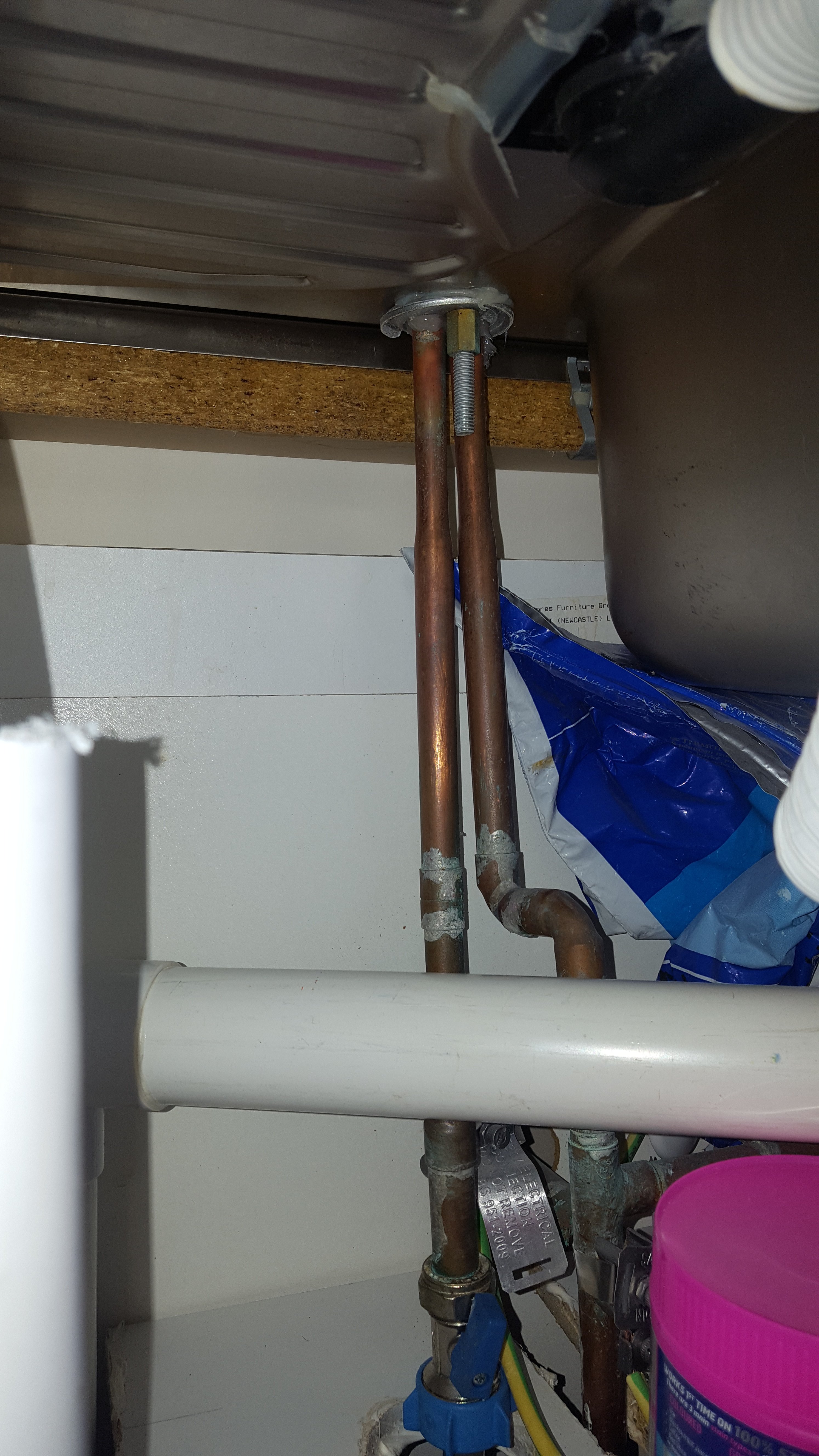

Been living in a new build for 4 years, my kitchen tap recently broke. Took pictures of it to B&Q for advice and they told me I wouldn't be able to fix it on my own as it looks like a botched job (copper pipes directly into the tap rather than a mixer?) Can anyone confirm if and what has went wrong? Pictures attached. Will be greatful for any advice.
Copper tails are sometimes supplied instead of flexible hoses and there's nothing wrong with them, in fact most prefer them. Apart from the silicone which shouldn't be needed at the top of the tails there's not a great deal wrong
Just be a little bit careful as to which is hot and which is cold. Hot normally goes in on the left, but in your case the left hand side appears to be connected to the cold.
Connecting them correctly means the hot comes down an inner pipe to the spout, and the cold is outside that. To an extent that arrangement stops the spout getting too hot to touch.
As above not alot wrong apart from the silicone thats not needed copper tails are fine cheers kop
Didn't notice the silicone to begin with mate. My bad. The op questioned the pipes underneath. That's what I was commenting on when I said looks fine to me. When the silicones was brought to my attention by somebody else that's when I said the oring has probably gone or is missing hence the silicone.
Fair enough mate now tell me would you consider that a bodge on a new build where there is time to highlight the problem of missing O-ring?
OP, I would replace the whole tap as it is broken(?). Buy another then post photos of what you have and the good guys here will and can guide you through the fitment.
The copper tails were probably supplied as part of the mixer tap and are generally thought of as better than flexis, (which are only rubber pipes with outer metal braiding to prevent them bursting.) So the copper tails are good and your B&Q are obviously wrong.
The silicone might have been done by the installer to try to be belt & braces with sealing the mixer to sink.
The soldering is typically a bit rough, but one thing I consider is a bodge is that the copper tails have been connected by soldered fittings to your pipework. Really should be fittings that can be uncoupled, - like brass compression fittings IMO. But no law against soldering directly to the copper tails, just daft though.
If it was like that from original install then yes. But if it has worked loose over time due to it being on a thin metal sink with no support between the bottom of the sink and the retaining clip and nut and someone has done it afterwards, then no as then it would not be the house builder fault. Just trying to look at it from all angles mate.

When you buy your new tap make sure its WRAS approved rather than cheap crap, pipe it correctly, make sure it's suitable for your hot water system pressure & fit good quality (e.g. Pegler) full bore isolating valves so future maint takes minutes.
