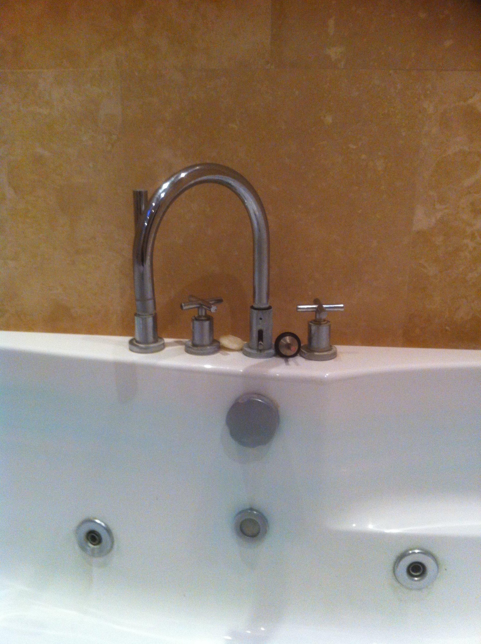

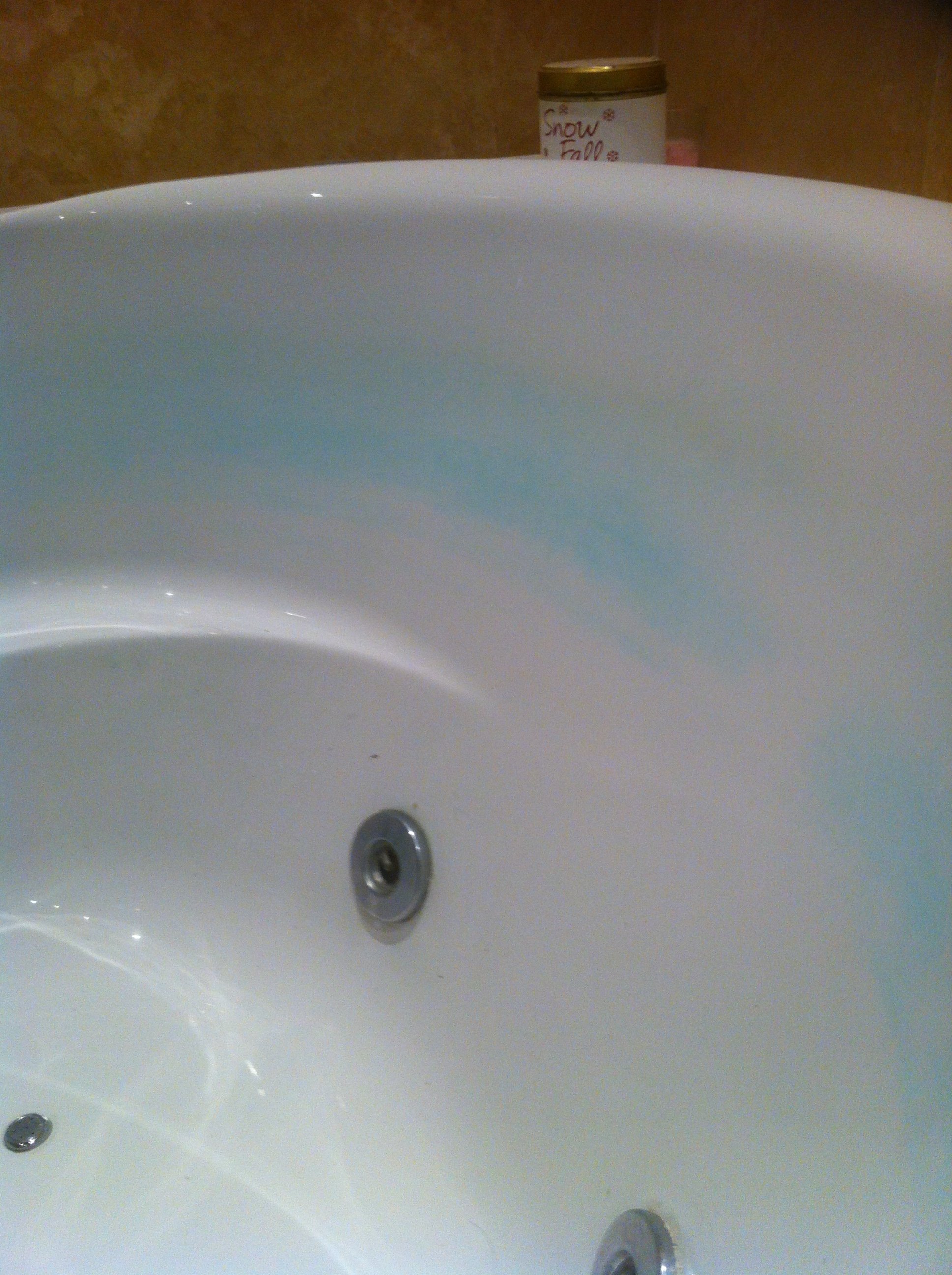

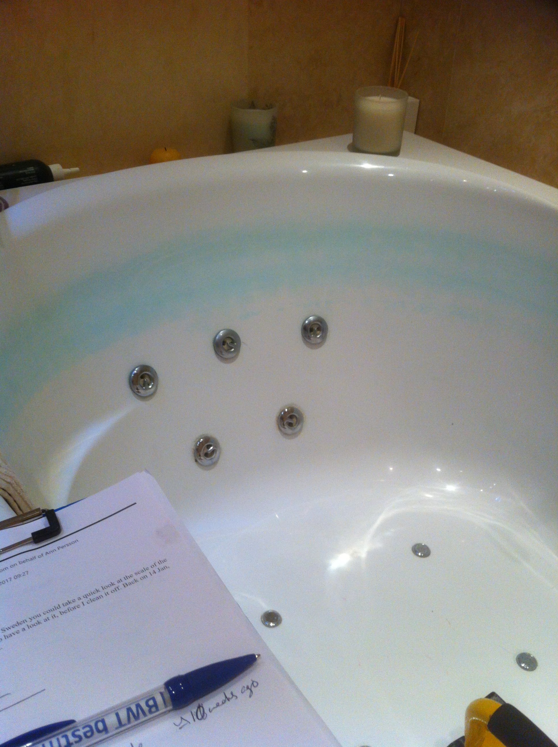

Hello, my customer has started to experience blue staining around the rim of the bath. PH reads 7.25 - normal for here. Harveys dualflow water softener installed. Un-vented DHW system. House is around 15 years old, no recent / new copper pipes fitted. All other piping is copper. I'm considering a number of possibilities (probably not exclusive) but am on the border of my knowledge
1. The sacrificial anode (if there is one) in the hot water tank requires replacement, or if electronic then the circuit may/may not be functioning (resulting in your copper pipes being eroded)
2. Earth leakage or other earthing issues in the electrical system causing the copper pipes to be used as alternative earth causing erosion
3. Excessive velocity in the water pipes dissolving the copper
4. Possible lack of di-electric connectors on some of the connections on the hot circuit allowing a “battery effect” to occur
Can anybody help here please. Has anybody got any other hints ? IMG_8342.JPG IMG_8343.JPG IMG_8344.JPG Thank you.

I've seen this in many hot tubs and no idea of the (blue) cause but a biocide in the tub to clean the tubes sorted it really quickly - basically put the Jacuzzi on full for a bit with the biocide (chlorine/descaler/degreaser) and it'll strip any crud off the pipes that may be re-depositing at the bath tide mark. Incidentally hot-tubs when used by freshly showered guests never had this issue, it was only guests straight into hot tub 'dirty' with cosmetics/sun cream on that had festering water. I never use a hot tub or Jacuzzi anywhere without dip testing water (sad I know).
Thank you Neilrj. The single user of the Bath is an elderly lady. I will make discrete enquiries re makeup / lotions etc and see what chemicals are uncovered.

The blue colour is mostly around the scum line so my thoughts are bacterial or maybe some chemical reaction between soaps, bath salts, general contamination from cosmetics etc and I shudder to think what else.
