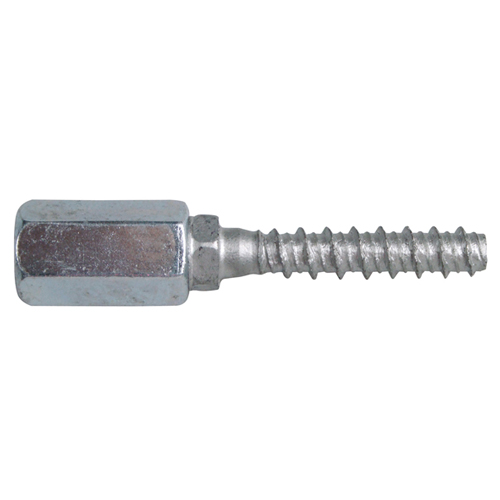

Those multimonti type concrete screws are great. Ive just discovered tapcon rod hangers. Great on commercial stuff. Saves drilling 12mm holes above your head all day for drop in anchors
Hilti do them as well very good
