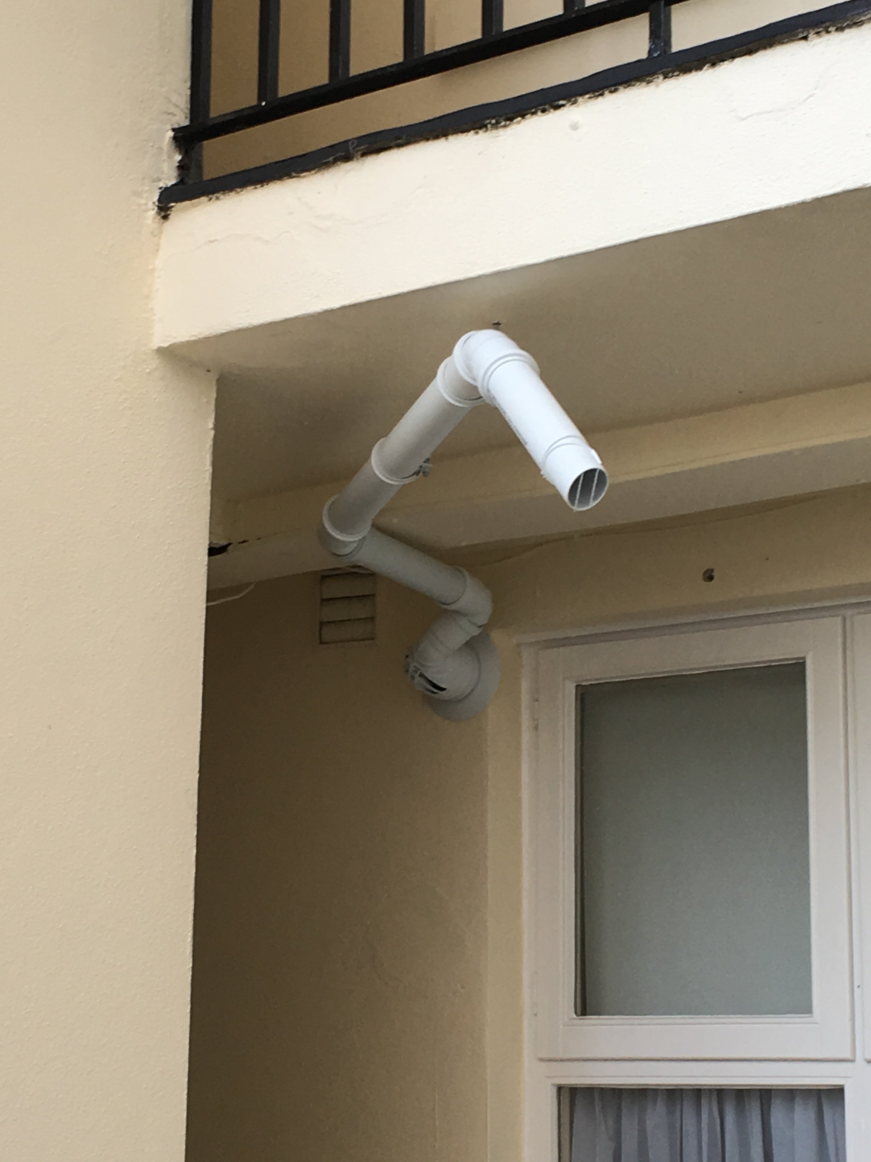

This is the second attempt. The first looked very tidy but the pipe was half way under the walkway and dripped on us as we walked in and out of the building. We made comment to the managing agent who asked the guy to come back out and this is what we have.
The owner of the property has yet to see this delightful 'structure'
I have laughed soooooo much over this I thought I'd post it to give you all a laugh on a dreary snowy day!
OMG.....................
I'm flabbergasted by this. Was the fitter qualified? or blind/plain stupid.
Management agent needs to throw him off the balcony...................
That's the trouble with those flue extension kits...you only get three elbows.

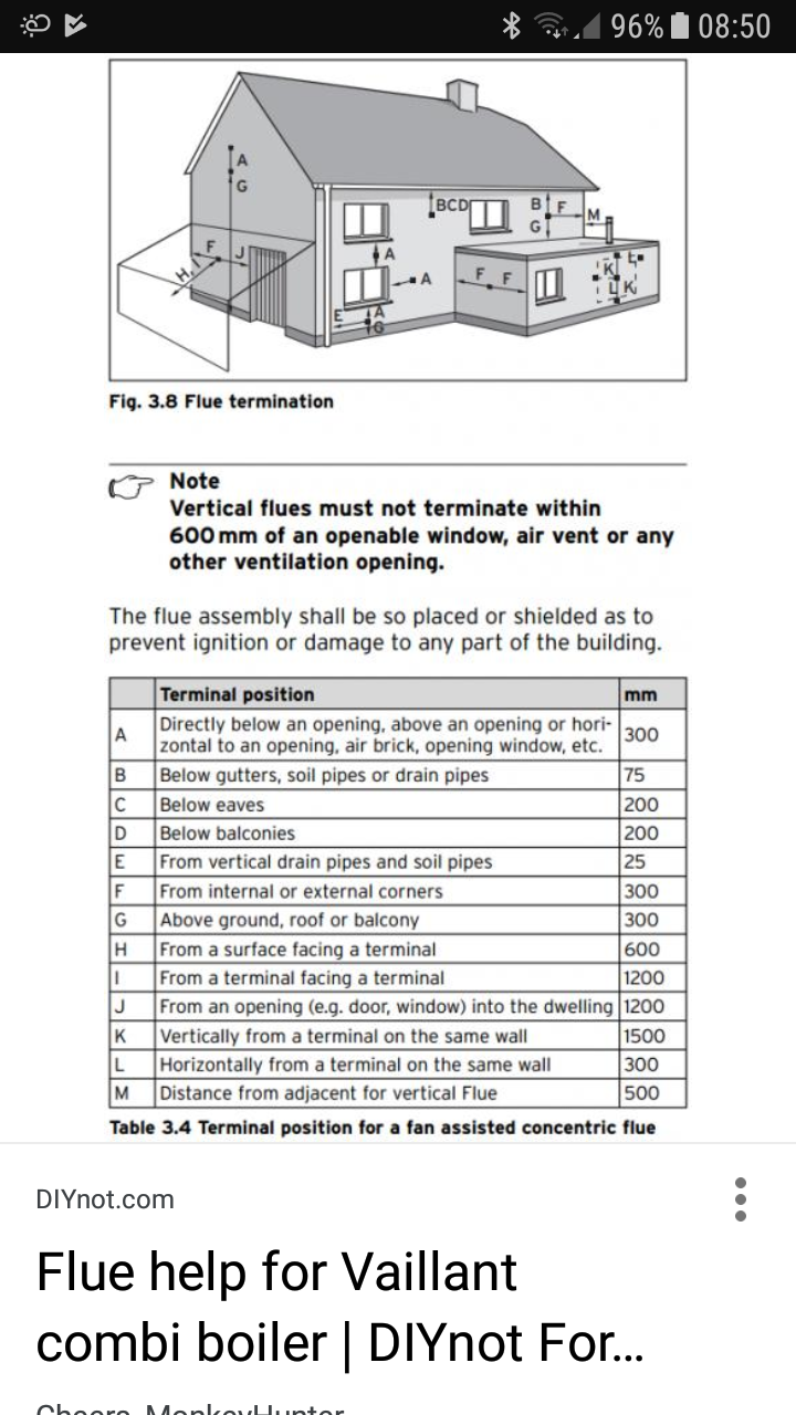

Thats no excuse bud the boiler should not even be in that position it still needs to be fitted to manufacturers instructions and the regs and its definitely not, plumekits are not intended to be used in this situation its just bad workmanship and understanding it is so easy to have done a better job without a plume kit very poor. Kop
#King of pipes
When you say the boiler should not be in that position are you talking about the boiler or the boiler flue?
In terms of the boiler itself we live in a grade 2 listed building and the rules and regulations of the building end at the exterior wall and not the balconies and walkways.
I live on the top floor and was fortunate enough to be able to obtain permission to put my boiler into the loft and take my flue The roof.
The apartments directly under me have no option but to have the boiler in the location to which they are currently or go electric. But they don't have they space for a hot water tank
Dosent make any difference it has to be fitted to the regs , the manufacturer should have been consulted if there was a issue before anything was fitted see attached fitting a plume kit dose not mean you can deviate from these rules fact . My advice report him to gas safe this installer need a kick up the ---- and retraining . Kop

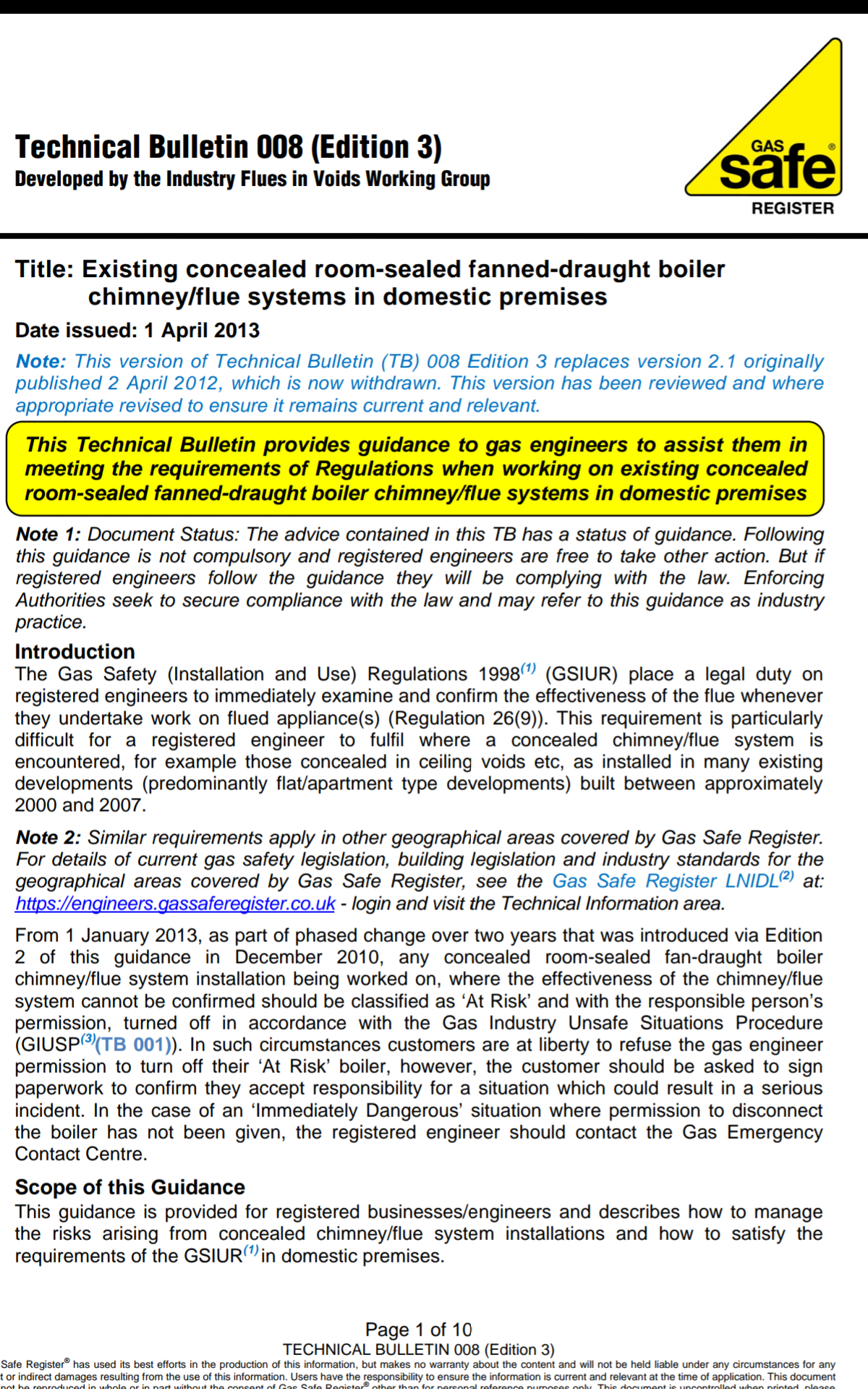

Better but no each flue joint needs to be accessible so it can be examined for leakage there are specialized boxings made for this purpose. Kop
OMG! This just gets more and more ridiculous-
I am beginning to question the competence of every heating engineer in our home town!!!!
The hole for the flue undermines the structural support for the lintel over the window.
It doesn't matter that the concrete walkway may join into the wall and form a bridge over the window either.
The hole that was already there for the previous flue was also wrong.
No enginner will unscrew a entire boxing each time a service and gas saftey check is required , it should have purpose made access hatches at each joint so it can be examined and tested. Again report to gasafe. Regards kop
