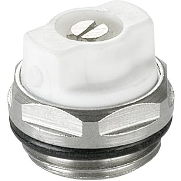

Your manifold is made by Maincor. The automatic air vents are made by Emmeti. Manual & Automatic Air Vents - Emmeti
The air vents come in regular sizes (male thread) from 3/8" to 3/4" - yours is likely to be either 3/8ths or 1/2". The automatic air vent unscrews anti-clockwise to remove.
I cannot tell without one being removed and have read the Maincor documents but I can't see a size for the air vent listed. The good news is which ever size it is a manual vent can be found to fit that. The manual one will look something like this and uses a radiator bleed key to open and close. https://images-eu.ssl-images-amazon.com/images/I/51K9v2XGAqL._SY355_.jpg
