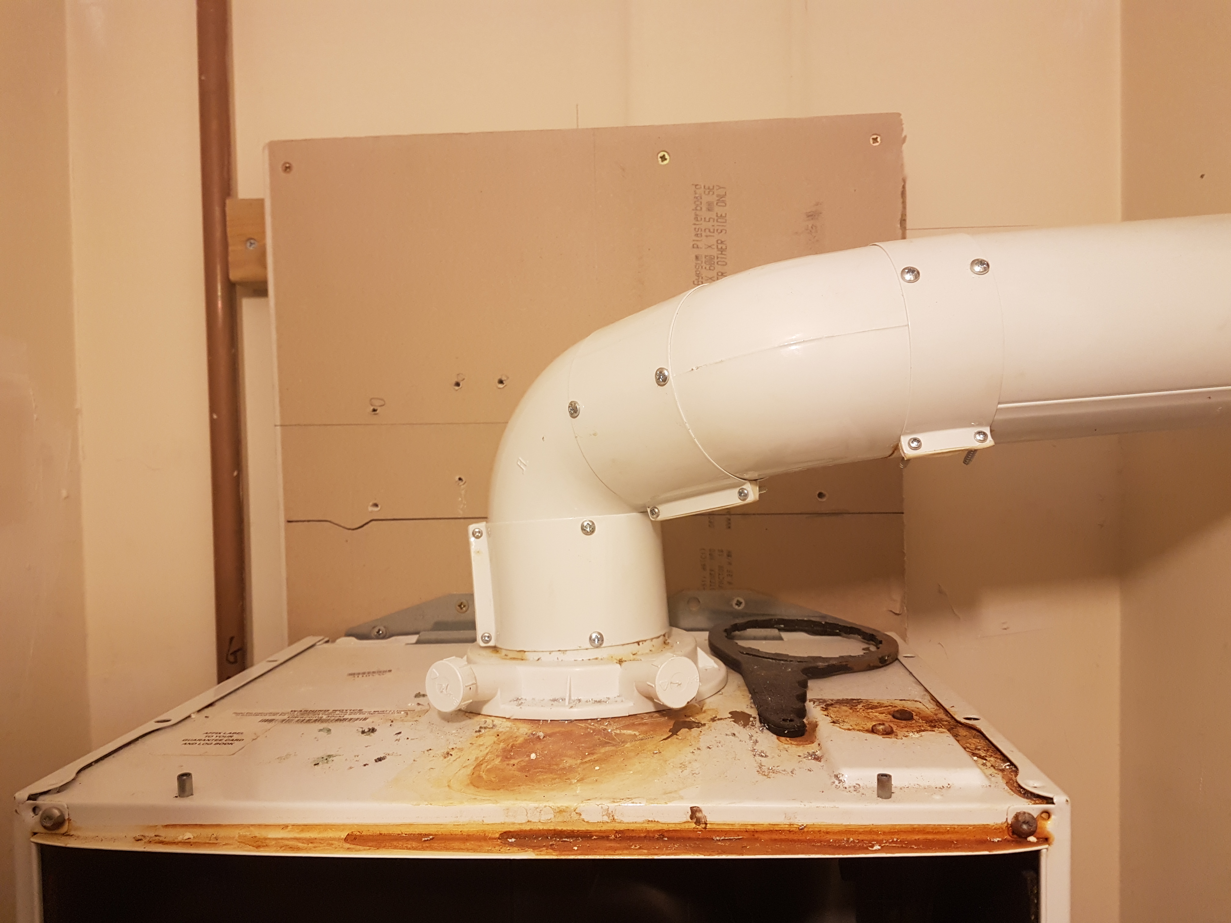

Since you people here are so very helpful (thank you!) can you take a look here and tell me if that looks like a good job, and if so - why would it leak? Or if not - what's the problem? (The marks on top of the boiler are from previous leak, that one was evidently wrong in a number of ways...)
not bad, cant tell the fall but looks close
vaillants like to eat flue seals or rain waters getting in
whys the case of the boiler off?
On long lengths of flue there is an inner support. Sometimes these are not located on the correct place. This makes the inner flue joints sag. They then leak condensate water, which is extremely corrosive.

The actual flue run looks ok, and there's straight and consistent slope there.
The flue as it comes out the boiler does, however, have an extra elbow to 'crank' the flue away from the back wall a bit presumably to avoid something? Elbows certainly don't help flow, but I presume this was taken account of in the length calcs?
But the original question still remains - WHAT is wrong with that flue? WHERE is the exhaust gas getting back to the boiler?
And a new one - why will they only give a 1 year warranty on a new flue?! What's this great mystery? What are they expecting to happen again?!
I am clearly missing something pretty darned obvious here.

@DevsAd you have a very good eye even with these few details. The flue is pished away from the wall as between bathroom and boiler room there is space for for pipes and there is one (big one) going next to the wall. So the flue needs to fit in little space between that pipe and the bathroom wall. Still, max length of flue is 10m and the run is around 6.5 so that leaves some space for this extra bend, theoretically.

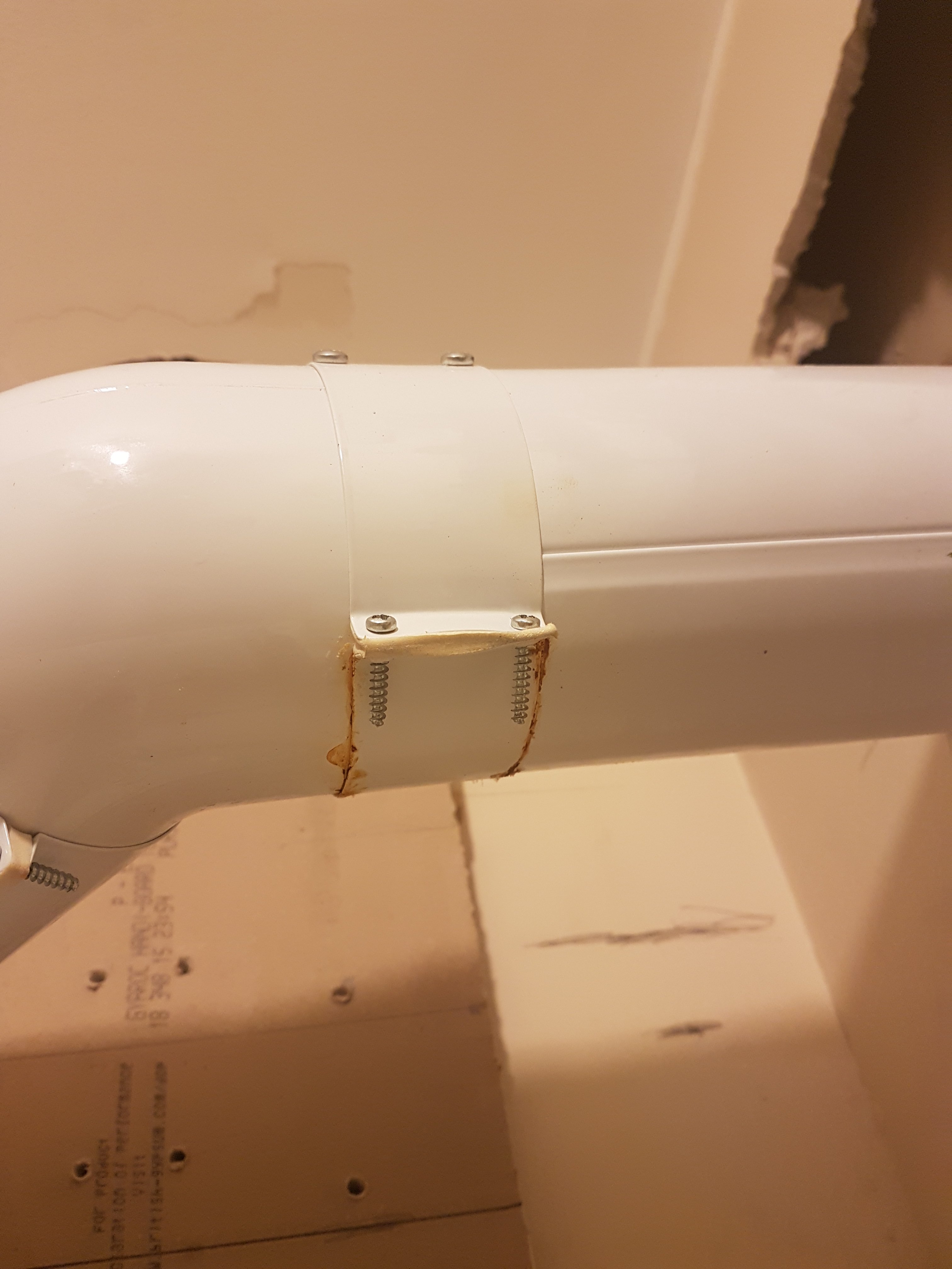

As for: what is leaking, I'd like to know that now. When the first guy came and said it I accepted it, but now I wonder if that's the case. He tried to show me that some gas/steam is coming from the flue into boiler but whether it indeed was or was it coming from somewhere else I couldn't tell.
I wonder if perhaps the only leaky bit is right next to elbow. Can something like that be replaced as a part or the whole flue needs to be put from scratch?
I don't know what the leaky bit ist, but I'd love to know. My guess, too, would be the connection to the boiler, or one of these first bends. And, yes, in theory only that part would need replacing - a dead easy and dead cheap job.
Did we get an answer as to why the case is off the boiler?
@DevsAd Thanks a lot for your input, it made me think, and question, and call another person in to try and fix it. I trusted the first guy and went on the assumption that the whole flue would have to be relaid, and that being a second problem with flue, I thought it cannot be done right and thus electric is the safer option. Therefore, the other visits I had were for a quote for new installation only (they didn't even start they boiler).
After your questions and input I decided to call another person in to try and fix it, or at least explain to me why it cannot be fixed. The result is that this guy actually decided to check WHY the flue is leaking, and it turns out it is a problem with installation right near the boiler entrance. Basically, the previous company hung it a little bit too low, and rather than correct their mistake, they fudged the connections on the flue right next to it (see new picture). So the flue (probably) never had a proper, tight fit and it's a bit of a miracle (not) that it worked so long. Not a miracle because if it failed earlier I would have called in the people who f..d it up to fix it but hey-ho.
Apparently the rest of the flue looks fine - supported in the right places, right drop etc. Hopefully they didn't fudge it anywhere else (but we didn't see any moisture anywhere else around the joints).
Anyway, he said he can fix it - he will lift the boiler to correct place, and replace these few parts with new ones, and seal it correctly.

Despite all that mess and leak, apparently the boiler survived (again - brave little fella!).
I don't want to jinx it, but hopefully by the end of the week I'll have it up and running again. I'll report here once it's done, but in any case - thank you SO MUCH for your help here, it's been invaluable.
That looks like a result!
You know what, I almost mentioned - after seeing your last photo in your post #24 - that the bottom collar on that flue immediately above the boiler was not sitting straight - you can see an uneven gap under it - and I wondered if that flue was being forced to that angle due to incorrect alignment.
But it's even better that a new plumber (at last a decent cove) went to the effort to ID this issue themelves.
And - wow - that's some mismatch!
I am incensed that so many so-called GasSafes have repeatedly botched up your install and have got away with it. The last company - the one that lowered your boiler too far - should be paying for this. In more ways than one.
In reality it's 'unlikely' it would have been 'dangerous' since the exhaust gases are sent out in the centre pipe which is surrounded by the intake sleeve, but to knowingly (and they sooo knew) force a flue connection to fit when it didn't want to would be a valid issue for reporting them to GasSafe (in fact should ideally still be done as the guy responsible might still be trading with a different group, or alone). You can picture their frustration when they realised they'd gone too far - a series of expletives followed by "what are we going to do about it?" They made the wrong decision.
But, good result and Happy New Working Boiler :)
