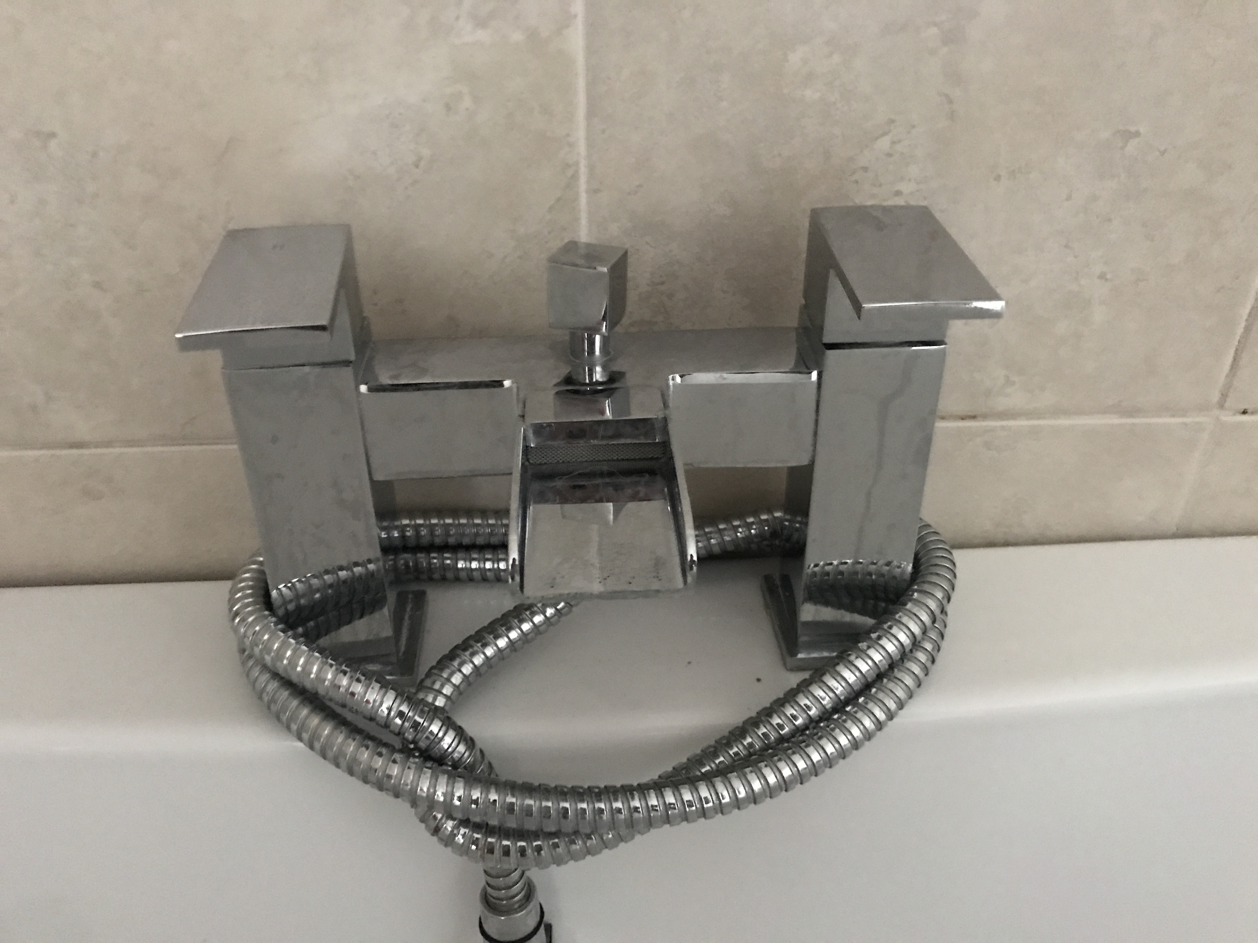

for everybody to help you further can we have a picture of the tap or taps with the problem an what type of system you have ( combi , gravity system , unvented ) - this could be a possible fault with your taps, ceramic valves faulty

I've attached a photo of the taps as requested, thanks.
Hi there,

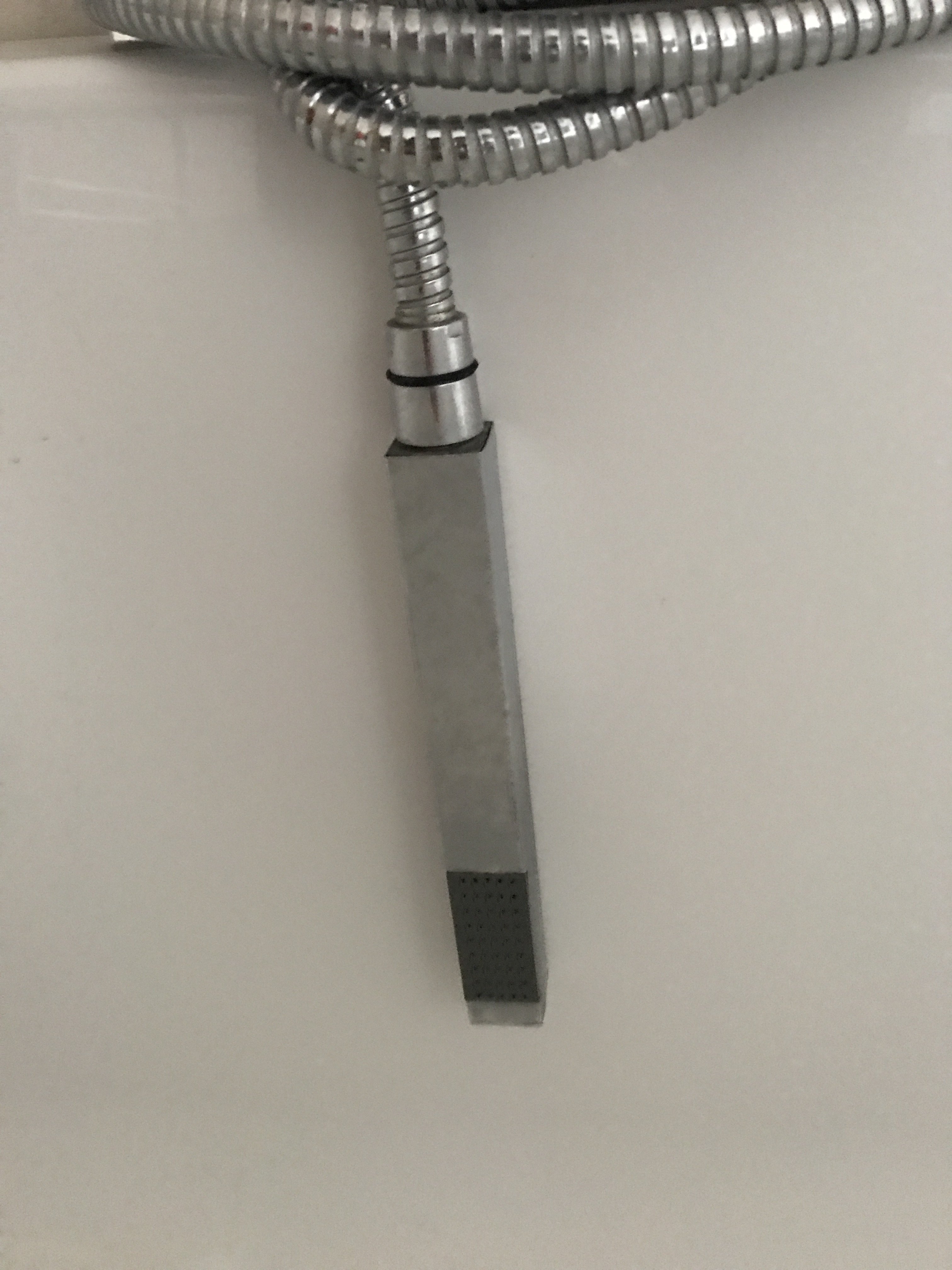

I've had a look at pics & forgive me if i am stupid and/or need to go to spec-savers but is your bath sealed to the wall as i cannot see any sealant around it or taps.
It may be clear type sealant if applied but normally you can see slight difference in colour & edge/size of sealant bead.
If not sealed to wall that would be a good idea to cure leakage from handset that is coiled around bath taps.
Re tanks in loft, you should have x2 in there if conventional system. Large one (50 gallons average) & smaller F&E for rads (5 gallon approx).
If you dont have large one then you may have an unvented cylinder but if you can post a couple of pics then you can be advised on here.

Will just be one of the 1/4 turn tap cartridges. Yours dont look standard.
