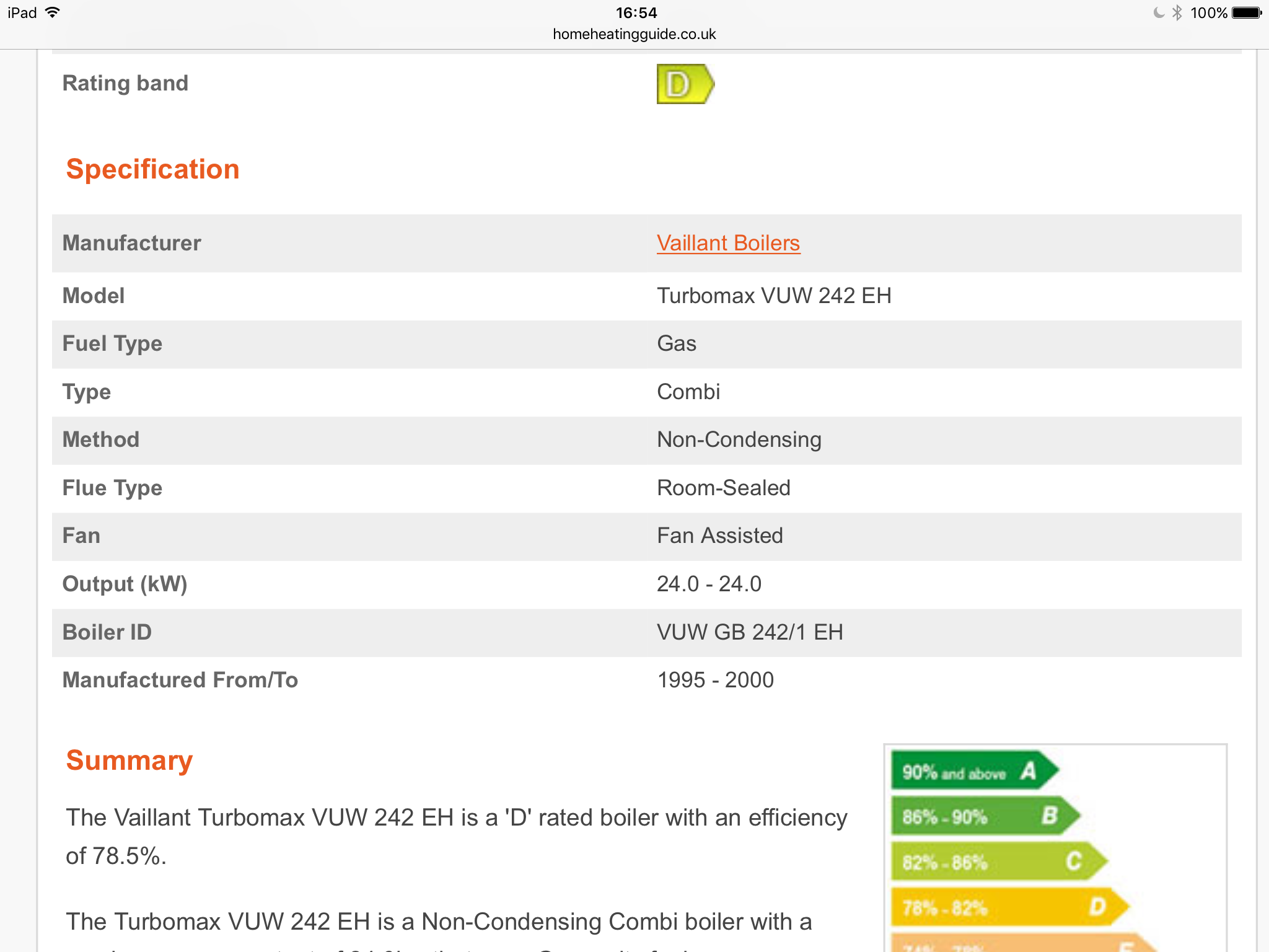

  3. ShaunCorbs
    How old is the boiler ?

  6. ShaunCorbs
    If it's 8 years old it's coming to the end of its life span realistically 10-12 years max

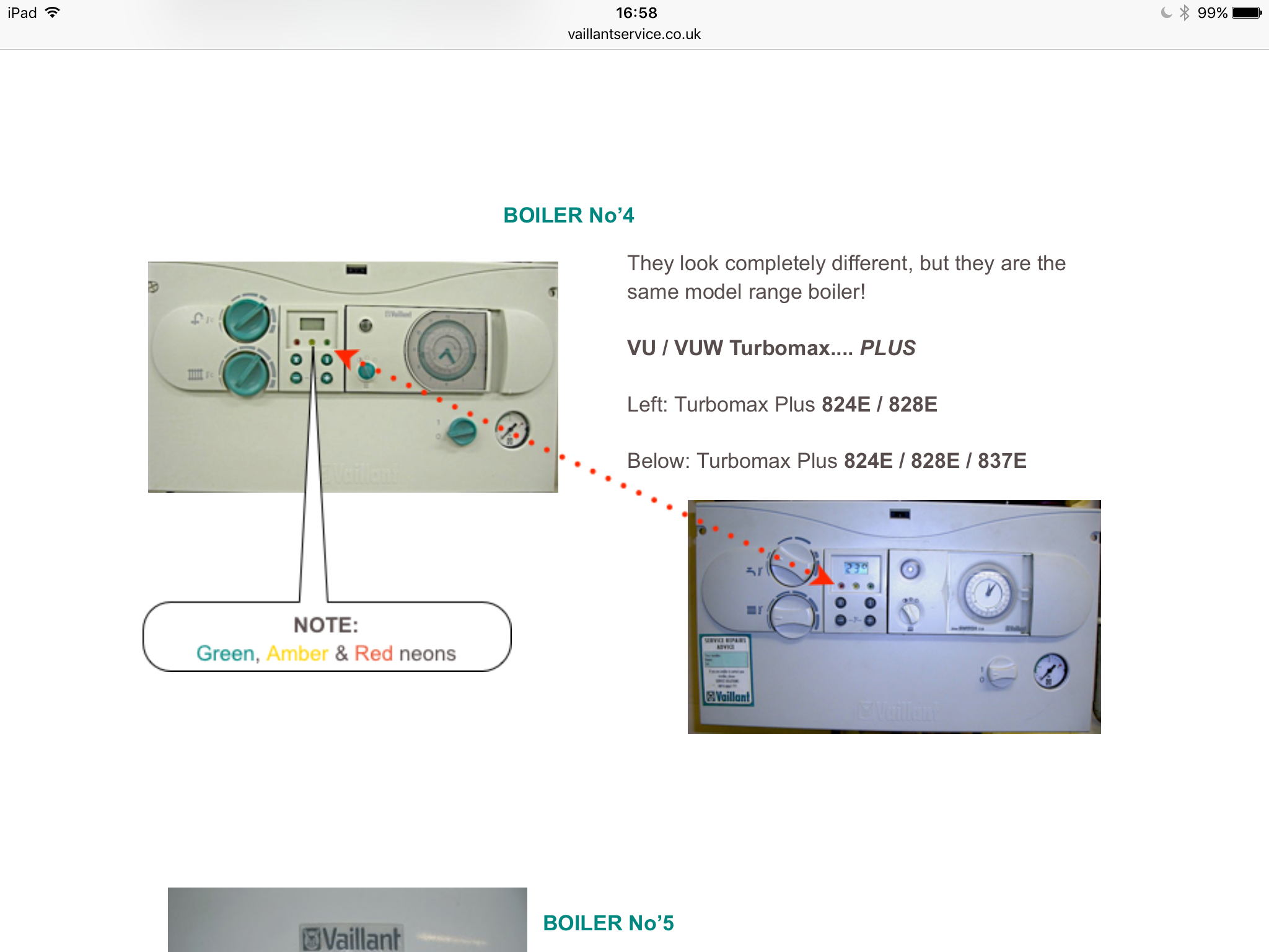

  11. a5ian300zx
    a5ian300zx New Member
    Thanks for all the advice.
    The boiler looks like the one attached (its not a picture of my actual boiler)
    External Pipe connections
    C.H Flow (IN) / D.H.W Outlet (IN) / GAS Supply (OUT) / Cold Water Feed (OUT) / C.H Return (OUT)
