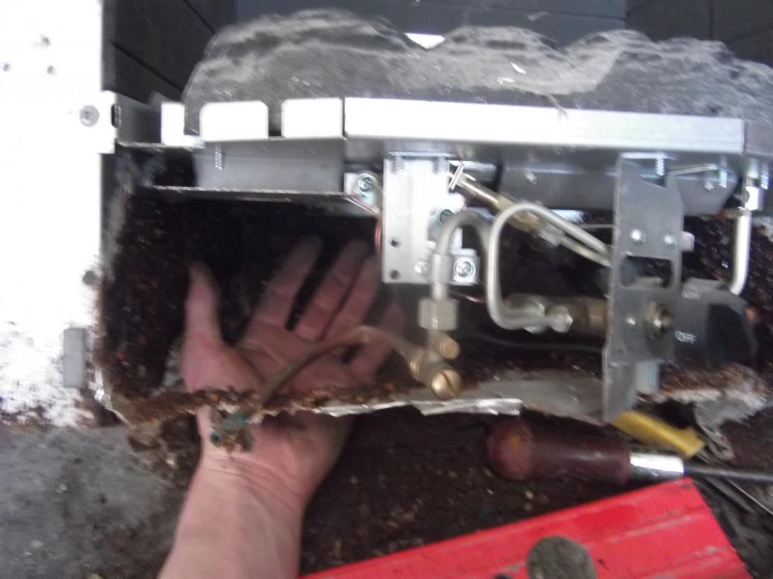

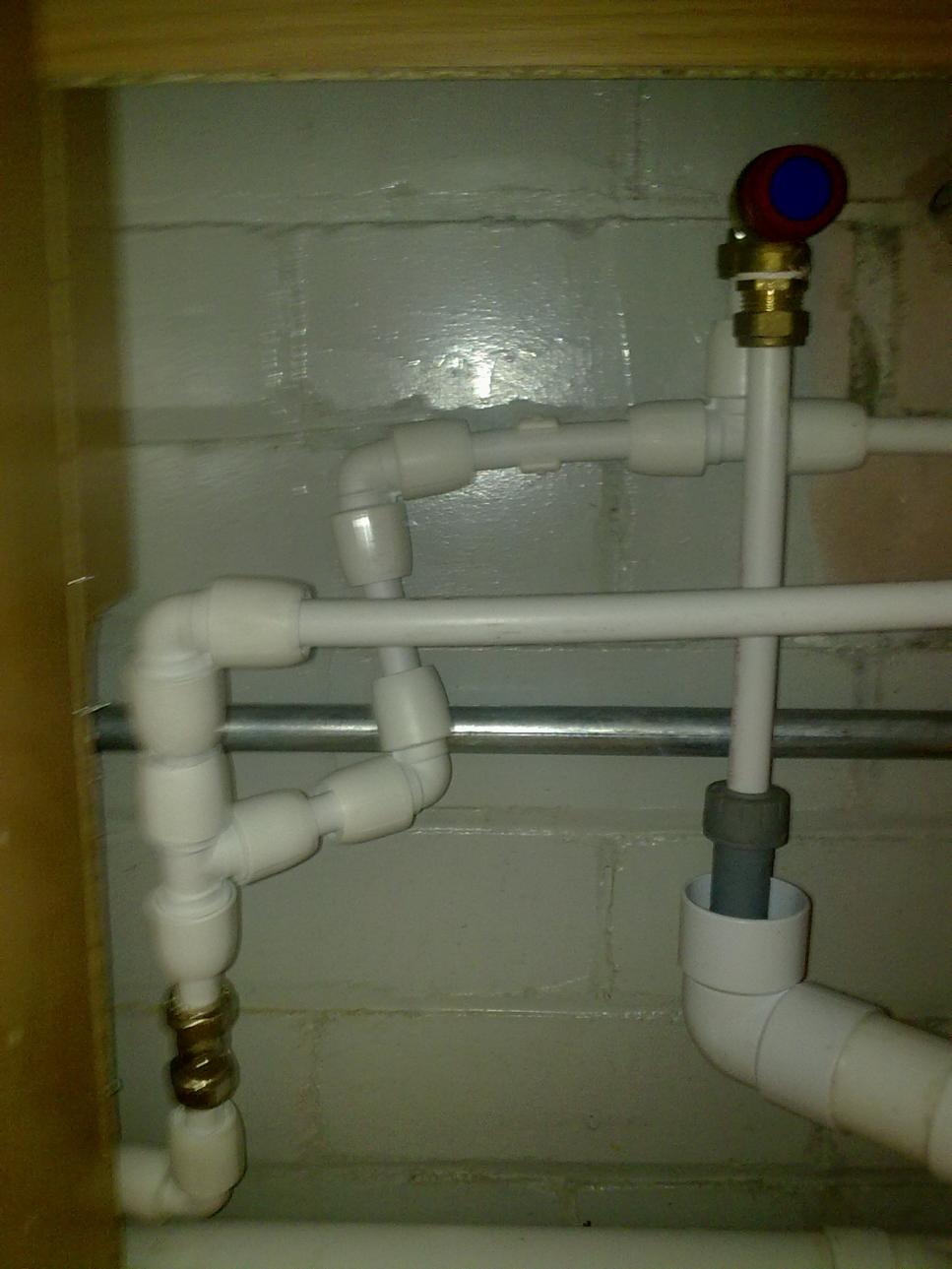

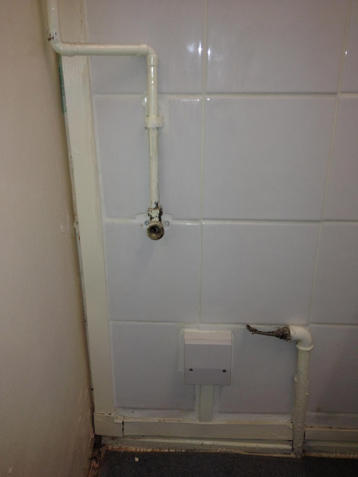

my first of many , was in a church hall and this was someones idea of capping the gas off.

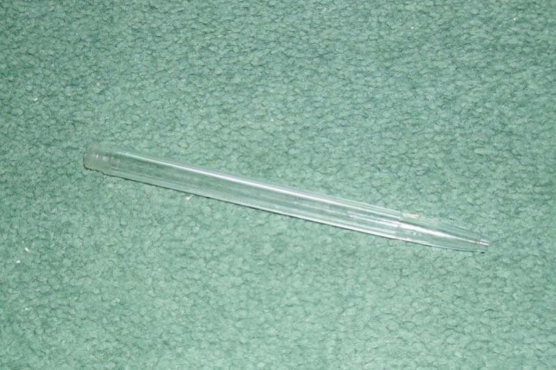

haha that made me chuckle if he didnt een thik tto cut the end dowm to make bigger opening not that that would make it right in any way just shows his lack of braincells hahaWhile I'm on a roll. Called to a job, new boiler with vertical flue. Water ingress had destroyed the pcb. Manufacturer declined to repair, put it down to faulty flue joints. I attended and checked the flue, all fine. I then noticed a joint in the tubing coming from the condense pump. When I filled the pump with water it turned on and water sprayed out of the joint. Investigation revealed that the tubing had been joined with a biro casing. This may have worked had the installer not left the pointed end on and left this pointing towards the pump. It's no wonder it leaked trying to pump through a hole a couple of mm across.
