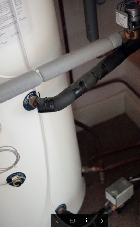

It's an unvented system with solar water heating.. so two 2ports to the cylinder.
You must have another two port for your heating circuit.

there is no three port.. with the cylinder are two two ports..
A two port can't control two circuits separately.
Is it possible you have another one you haven't seen
Can you post photos of what you have got.

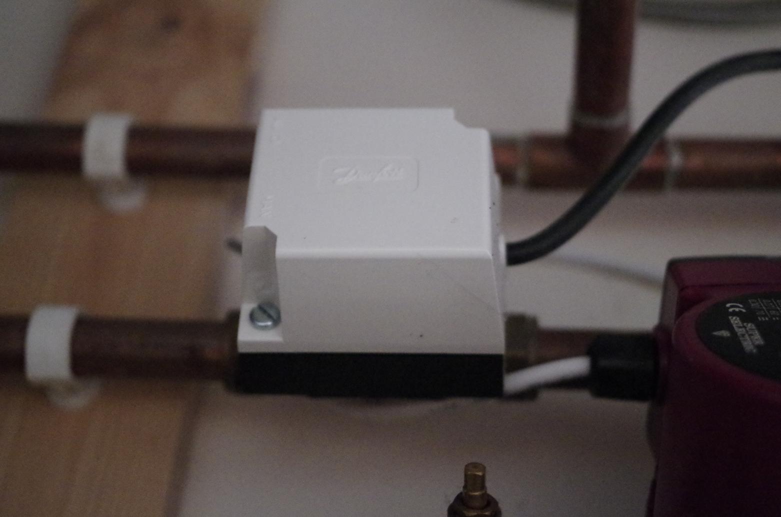

found it.. there are three two ports
so.. i guess this is the culprit? Guess Ii need to remove and check gearing, synchro motor and micro switch.
Thankyou
two are honeywell and the other is a danfoss.. pic hereView attachment 28422
Thankyou
I would check the voltages are correct (L+N) at the valve supply when there is a call for heat. Rather than pull it to bits. It could save you a lot of time and effort.
