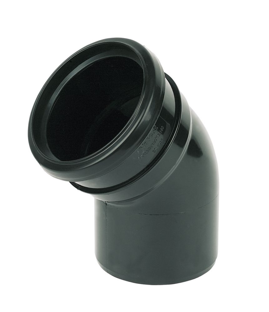

    Damn my search engine settings! Ask Jeeves had just replaced Google on my laptop and when I search Multiquick all I get is the Braun Multiquick hand blender.
    the coller is for fitting two pan connectors together but thinking about it, you'll be better using two of these in the 2ft horizonal run tilted to the side.

    Ok, now I'm totally confused ! If the centre line height of the soil pipe at the wall is 18mm and the centre line height of the WC pan spigot (two feet away) is also 18mm, how will using two 45 degree single sockets give any additional fall, no matter how they're positioned ?
    I can understand that by using an offset pan connector in its lowest position (at the pan) will give some fall along the two feet back to the wall but not the two 45 degree single socket bends.
    Thanks again.

    Every situation is a bit different, I had a similar one the other week and I used the 45's and rotated them away from the wall to suit. I just get my stock of soil fittings and pan connectors together and cobble something together.
